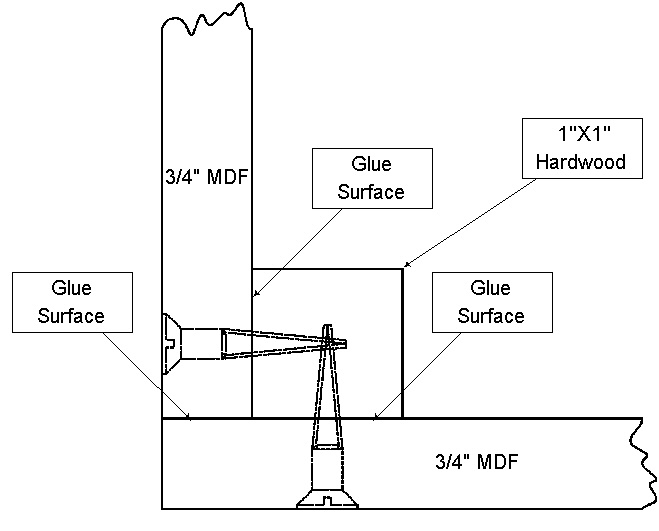

You can use a simple butt-joint with a brace inside like below. As long as you counter drill the holes for the size screw you’re using, it will not crack or chip the MDF, and it is very strong. Sink the screw heads below the surface and fill with wood putty.

When you say fill with wood putty with regards to screwing, what do you mean? What is there to fill with putty? (unless you mean any cracks and seams - which Im already planning to do)
GeniX,
After you have counterdrilled, drive the screw so its head is about an 1/8" below the surface. This is what you fill with wood putty.

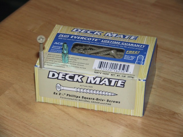

Just went by home depot, and they had some green screws that Peter posted a picture of above, but only in the larger diameter size. I found some Deck Mate (c) with Phillips Square-Driv(tm) ends on them and they include a bit to use. They seem just as good as square drive. Home Depot carries all sizes of these screws.

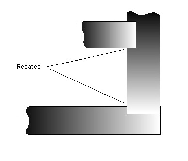

Try milling rebates in your timber ( see below). You can use a router or a table saw, and if made accurately, the cabinet will all line up and hold together during assembly. You will only need ratchet/webbing straps to hold it together whilst the glue sets, or perhaps a couple of panel pins, as Peter suggested
Thanks pinkmouse. I was thinking of milling rebates to get the centre support in the right place, but you're right - if I do that for the end pieces as well then it should all line up (in theory at least).
How would one do rebates with a table saw? Given the 'L' shape (well if you rotate it a bit)...

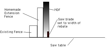

Cutting Rebates with a table saw
YOU DO THIS AT YOUR OWN RISK!!! Do not attempt if you are unfamiliar with the use of power tools!
You have to remove the blade guard for this operation, so it is vital to keep your hands out of the way of the blade, and to use eye protection
