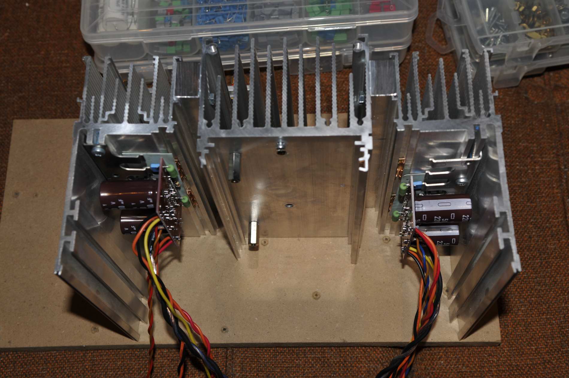

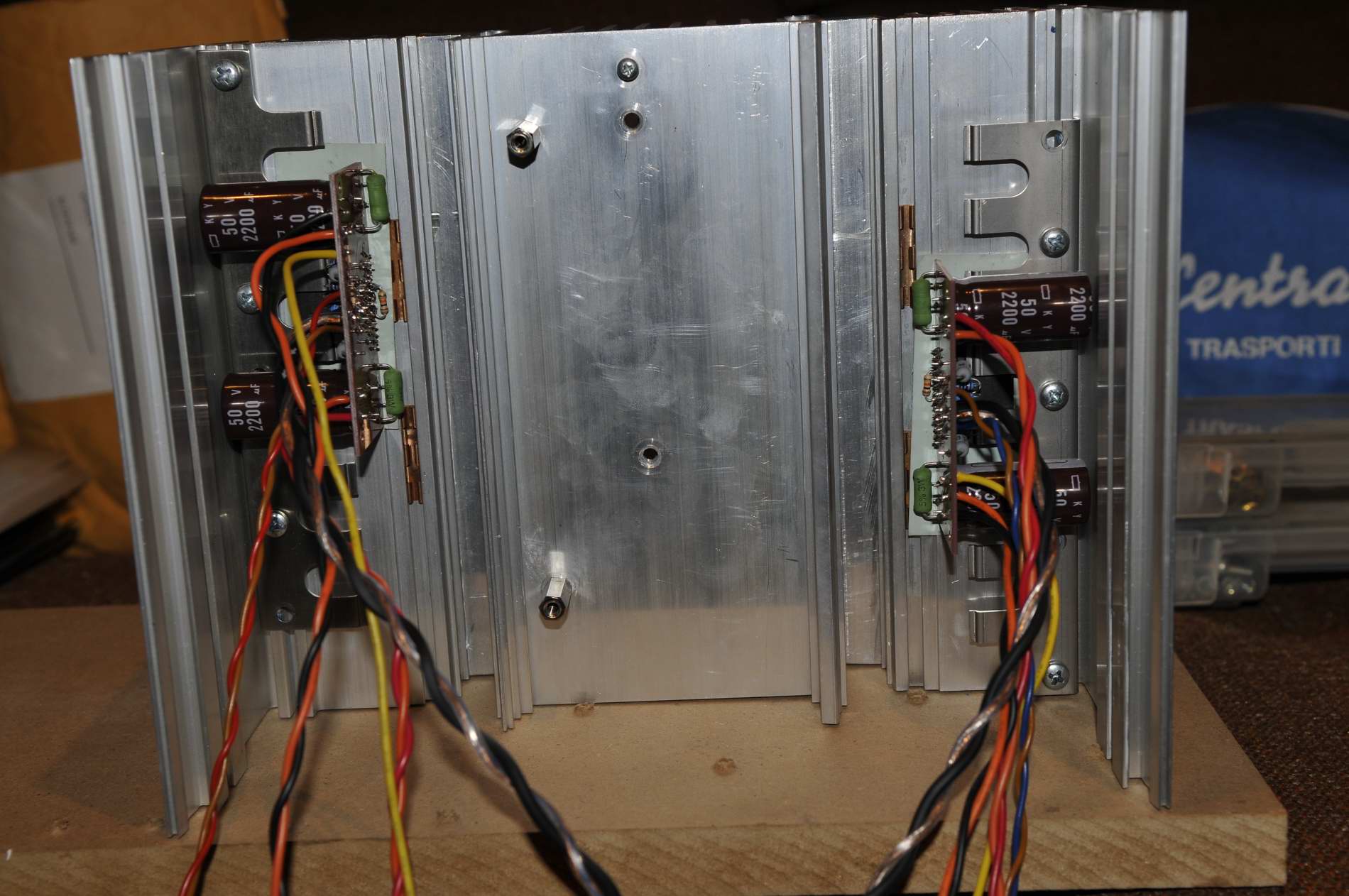

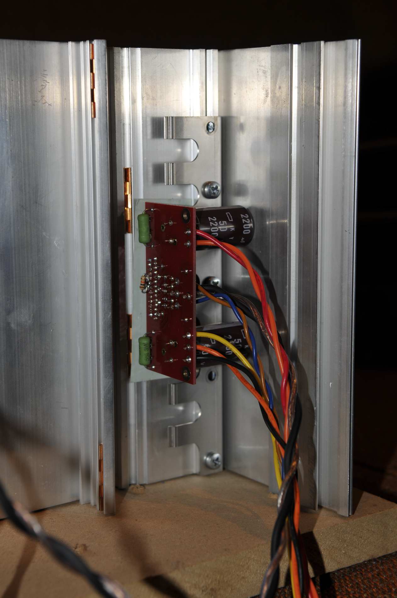

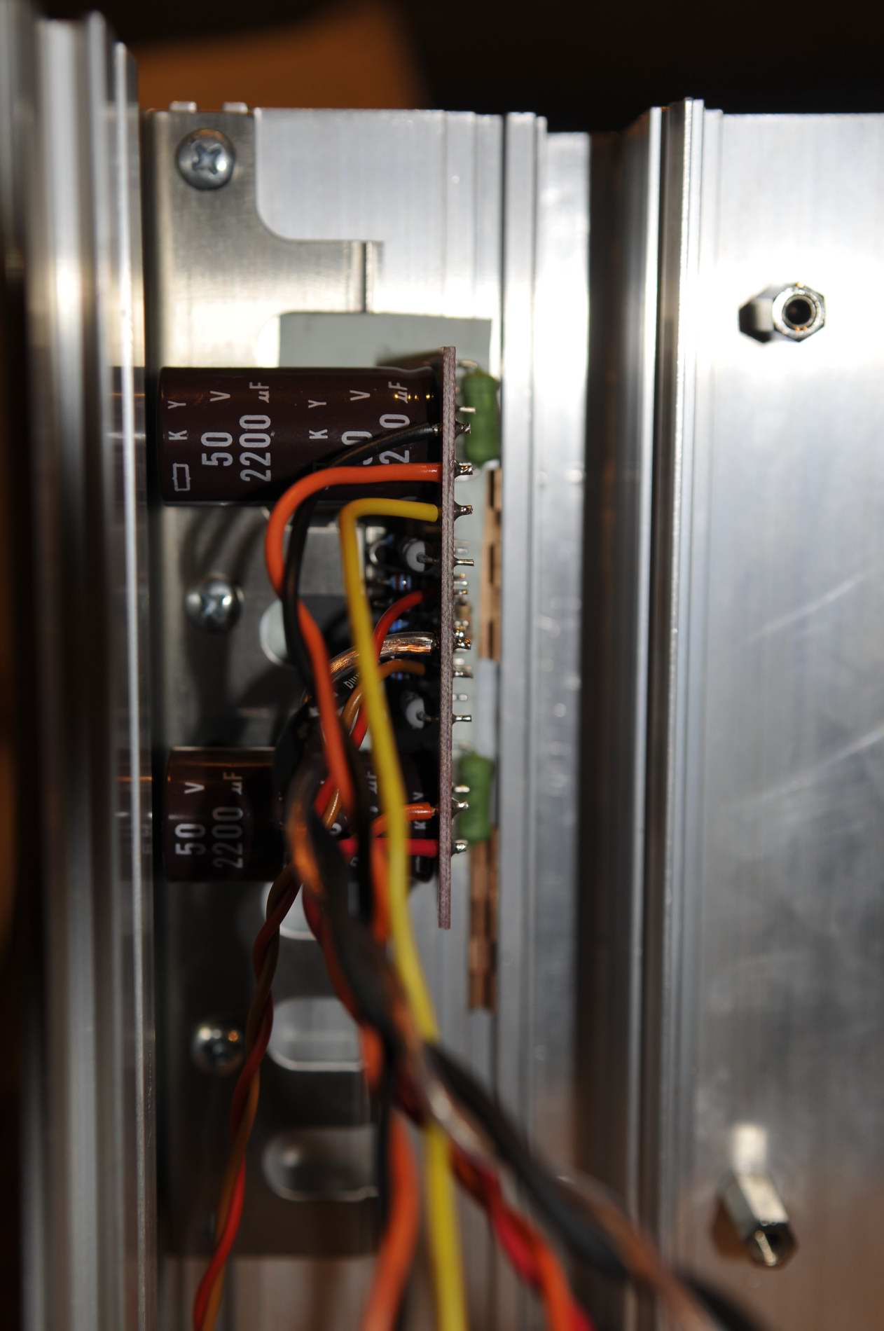

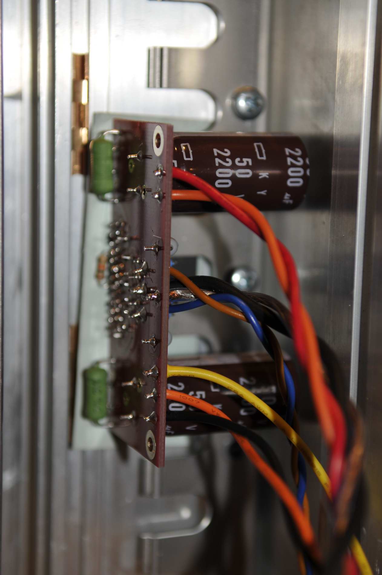

Finished populating this weekend, power it up yesterday, for now everithyng OK.
PS with dual 32VDC, trafo is 500VA and standard PSU filter 12x10000µF.
The power supply holes and output holes are two small, it's imposible to fit in 1,5mm2
I'd love for normal size resistors (i.e. 10 mm pitch)
Other than the boards are great and the quality exceptional.
The amp sound greats.:)
