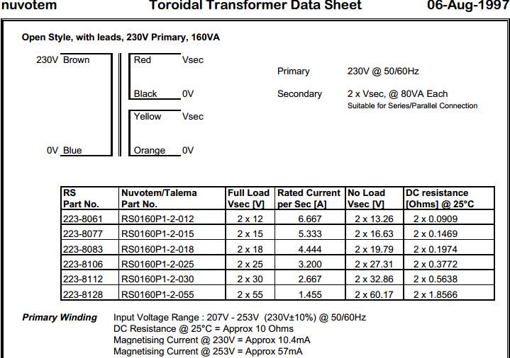

Did some "homework" during the weekend about transformer.
May I know the RS PartNo. 223-8106 work for this?
It said 2 x 25 output with Primary 230v
thank you for all of your help 😛

I am using a Nuvotem 300VA 2x25V, the max voltage I measured at the smoothing cap is 34V max. (I am using two 35A bridge rectifier)
The mains voltage in HK is 220V.
I know nothing about building an amp and I have no problem of the LM3886.... Do search the forum for the testing procedure before connecting the amp to the loudspeaker.
