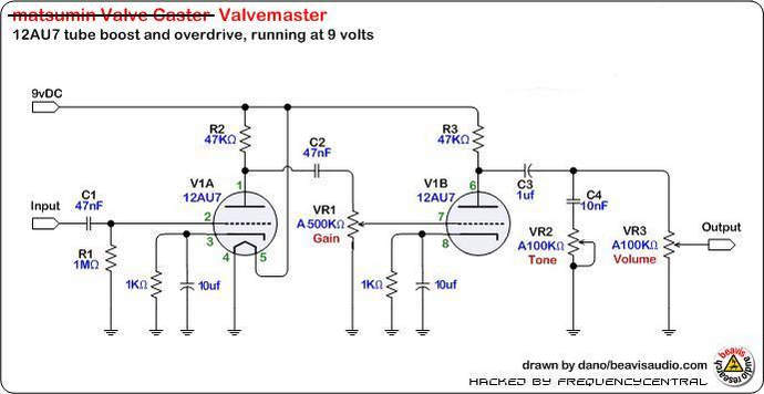

this is for a guitar. just something to play around the house and in the yard. I play mostly old school blues on a semi hollow body. I had a fender mustang II with all the digital effects but didn't use much. some distortion/overdrive and a little reverb is good for me.
I enjoy buildng things myself so that is the real object here. researching since I posted this I understand the fx loop a little better. the reverb might jist be a pedal. I want to build a TS clone or Valvecaster in front of the amp. i think I'm going to start with just a chip amp. the 18v tool battery came into it because i have several w/chargers and i think i can get decent volume and clean headroom.
i'm not sure i understand power supply circuits yet or how volume controls are added. i'm just looking for a starting point so i can start building something.

But I think your plan to use a valve preamp (Valvecaster) and run that into a solid-state power amp is a good one. Let the valve do what it does best (generate musically acceptable distortion), let the transistors do what they do best (put out clean audio power in a small, light, efficient, reliable package).

The Valvecaster you mentioned also sounds interesting. I hadn't heard of it until you mentioned it here, but the few You Tube clips I found don't sound too bad.The Supreaux Deux looks like a good 1st project for me.
(I mean that in a good way, as many low-voltage valve circuits sound, erm, rather uninspiring.)
If I had a 12AU7 lying around, I would probably throw together a Valvecaster (or the related, and allegedly better-sounding, Valvemaster) just to see how it sounds in real life.
