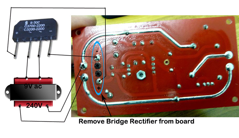

Hi Richard,
I think you could just remove the rectifier from the soft start board and use it with a small 9V transformer?
Barry

Hi Richard,
Barry
Hi Barry
I removed the rectifier from the soft-start board tonight and connected a 9VAC transformer, wired in parallel so as to power the soft-start separately. I then connected the AC supply from the IEC mains inlet to the s-s board and 9V transformer. The relay clicks as per normal, and I am getting 233V on the s-s output. After cutting the power I touched the 47R power resistor and it felt warm.
The bulb tester doesn't glow, like it did before the mod 🙂
Is there anything else I can do to check the s-s is working correctly?
Thanks for the practical tip!
