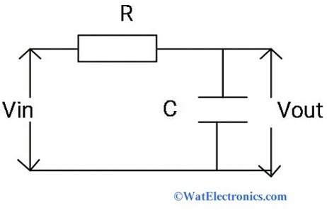

I do not understand very well. Perhaps you have an example of how to install such a filter at the input of a microphone amplifier?use a low pass filter at the input of your amplifier

This is an example of first order passive low pass filter. The idea is to block very high frequency (RF & VHF) which pollutes desirable signal frequencies (20hz-20khz) & can make your amplifier unstable. Generally we aim for 200khz & up. Google to know more about it. You can find old threads about this subject.

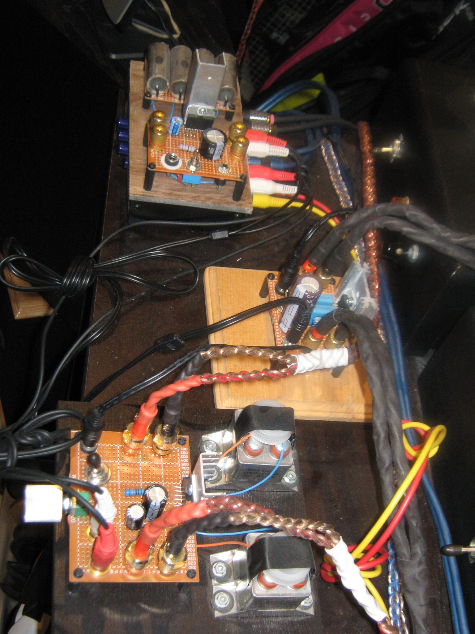

Here's my TDA 7377's , 3 amps, different capacitors. PIO Sangamo, MKT cap, Sprague bathtub caps.TDA 7377 An Oldy but still a good one... 12 V single supply. It was intended for Car audio and.. Widely used., in a lot of Premium head units. as quad speakers or 2.1 (sub) setups
Sound is surprisingly Good. Wayyyy better sounds than the 3116 /8s things (from experience) 🙂
Buy a cheap a** Chinee Kit ~12$ and substitute decent quality parts Caps, Op amp etc and you will be surprised..
I was.
Nice easy to build amps. Sounds nice.
