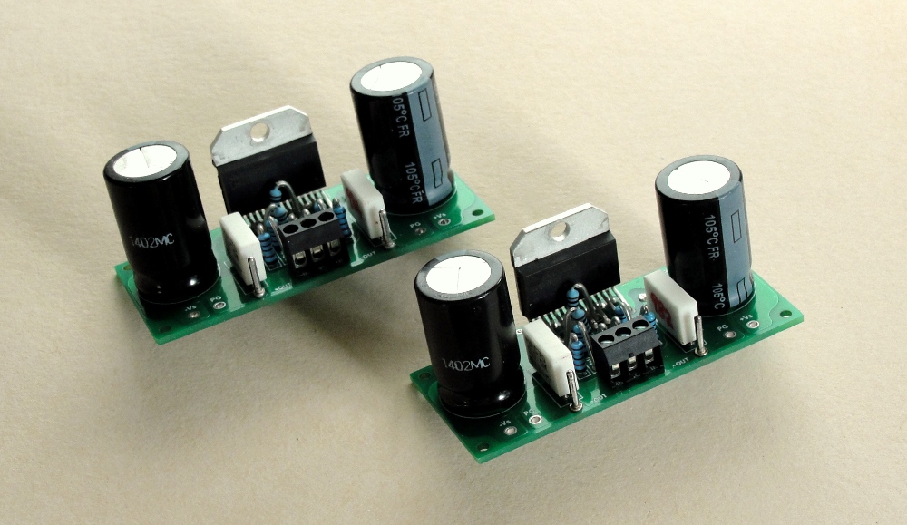

Just for fun, we made a PCB for LM4766.
It is also compatible for LM1876.
Works firs time.

It is the same size as the Brian GT LM3886.
The Gerber was public, but no longer.
www.diyaudio.com/community/threads/absolute-minimal-3886.391318/post-7153819
We did LM4780 first, which is of course now obsolete, because we want to bridge.
Active alternative is now LM4766 or LM1876.
But of course less power than the 4780.
If you also want to build bridged, you can PM me with email and postal addresses for boards.
For stereo only ( intrinsic BTL ) I am currently building a STA540 for my auntie.
Has to be super simple (nothing to fail).
Compact, no heat, single 15V laptop supply.
