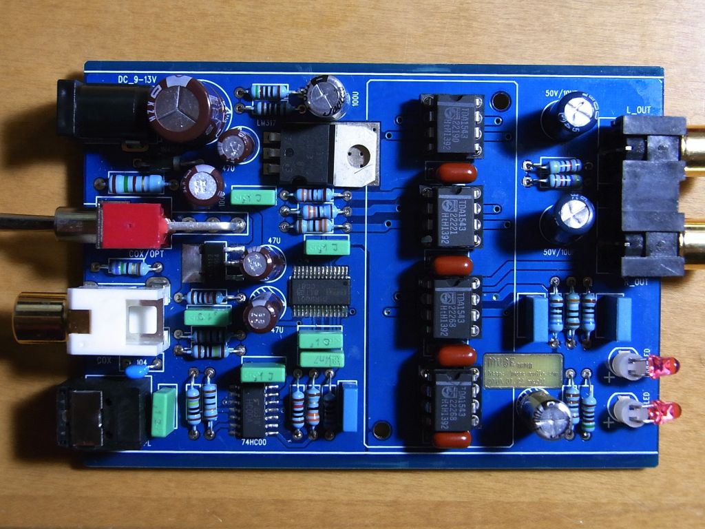

Sorry, but I am a newbie, know little about DAC. I just bought this Chinese DAC 4 x TDA1541 in parallel. I just hooked up the transformer temporarily just to see if it works. My problem, is that it works when plugged in to my regular Marantz CD player, however, if I plug it in to the SPDIF output of my computer, I get terrible crackling sound. I know my computer is fine as I have another DAC using TDA1543 with DIR9001 and it works fine, however, it does not work with my new TDA1541 DAC, but works fine in my CD player, can someone please explain to me whats going on here? I like to get this DAC to work, as I like what I hear when using it in my CD player.

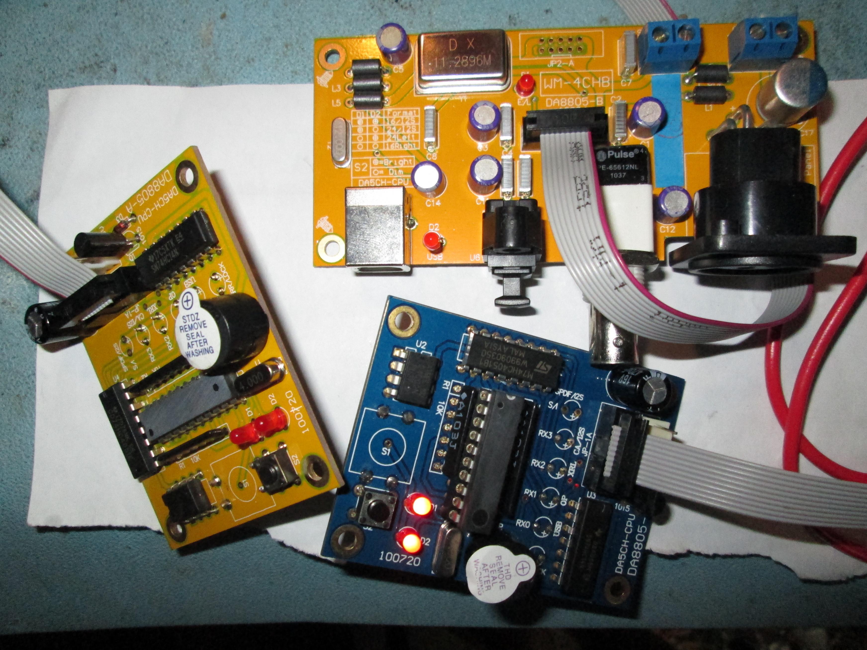

I also have a Raindrop DAC that has a funny SPDIF lock issue. 😡
Using the the USB and optical SPDIF is fine, but when using the BNC SPDIF I have to pull my cheater plug back a bit to break the ground connection ... and then it works fine !?!?! 😕
This makes me think the SPDIF transformer is grounded on the wrong side or something ... you never know with Raindrop. I'll be trouble shooting it soon.
Yours sounds like more of an SPDIF audio format issue:
On the back of his/her digital source select PCB is a push-button and two LEDs:
D1 D2 Format
on on 16/I2S
on off 24/I2S
off on 24left
off off 16right
I'm using 'on on 16/I2S' format to lock to the optical SPDIF out of a Musiland 01USD USB to SPDIF converter and regular CD files in .flac It's a NOS 1541 DAC using the WW8805 receiver; I also have the digital input select board.

Dac
Hi TBKK, Did you ask the seller for a schematic? I think you can see a few things here from the photo's on Ebay. It appears to have a WM8805 input receiver. You can look at the datasheet to see how it is wired. Next I see the stupid reclocker scheme from the Analogmetric Dac. The ubiquitous SAA7220 digital filter. And "wow" 4 parallel TDA1541A dacs. Since it is very hard to do 1 (TDA1541A) correctly it is unbelievable that it has 4. My advice to you is get your money back. If you really want to fix this, it is most likely that your input receiver is dead or the SPDIF input is reversed. Or most likely a wiring mistake by the man in China. This is where the datasheet comes in handy. You will need to draw this out and look for errors. I have seen comments about the 4.0 dac's being noisy when they do work. I can point you to the Analogmetric schematic and that gives you the basic reclocker scheme. How the 4040, 7220 and basic TDA1541A is wired and remember it's 4 TDA's in parallel. So although you don't have a schematic it is possible to reconstruct one. Do you have a lot of spare time? OK, so I have been in your shoes. My Analogmetric's sing. I have 2. The schematic for my dac is a mess. I would dump that clock and 4040. I would also remove the extra pair of dac's. All that requires running clock recovery from SPDIF "Master" mode. However I wouldn't do that until your dac makes at least some noise. You will need to decide how much time you want to invest into this not to mention the money for replacement parts. 😱 Dave

It sounds like it's dead and you should really contact the seller (quickly!) about a replacement.
Now, if you want to take on the challenge of trying to trouble-shoot it yourself that's a whole other matter... is this what you want to do?
If so, we don't really need a schematic: it's all in the pic:
First thing: are you using the right polarity on the power input (center is usually power and outside is usually gnd but double-check on this DAC)? (I've done this!)
Then post what the voltage is on the voltage regulator pins, and the chips (eg: TDA1543, Vdd is pin 5) and we'll go from there ...
Here's some hints of a schematic, see what you can find:
