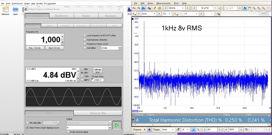

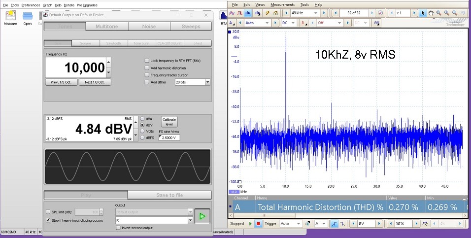

Below is a spreadsheet capture using REW at various levels.

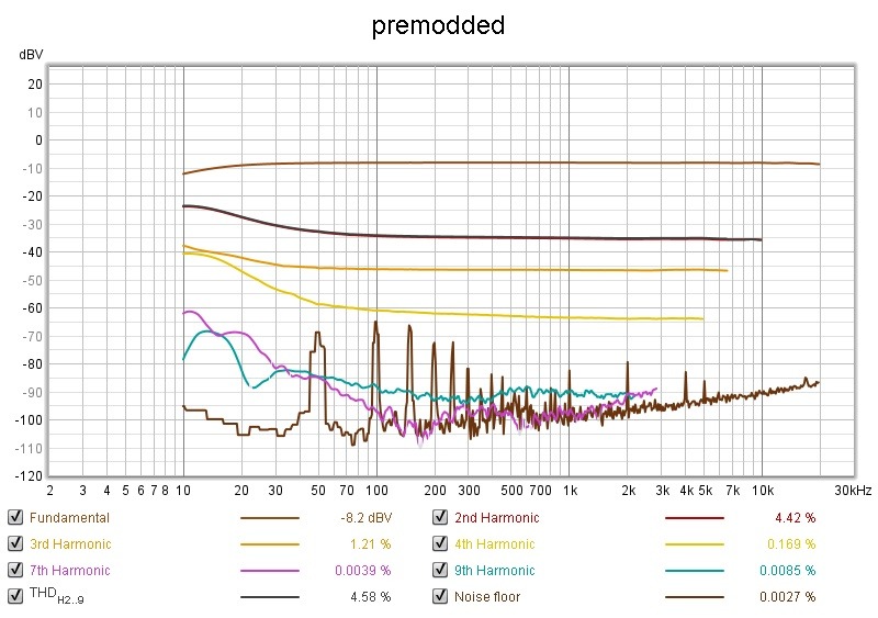

Reemember that the original unmoddified amp was producing over 3.5% THD at under 2watts so not a bad result I suggest, for minmal cost and effort.

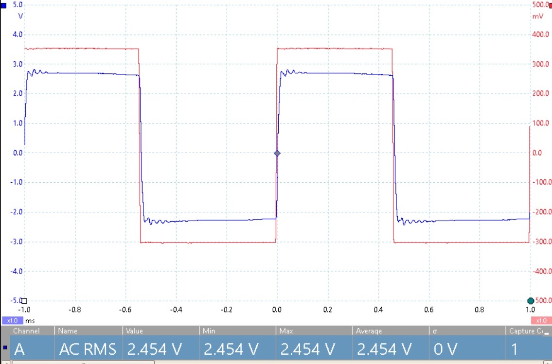

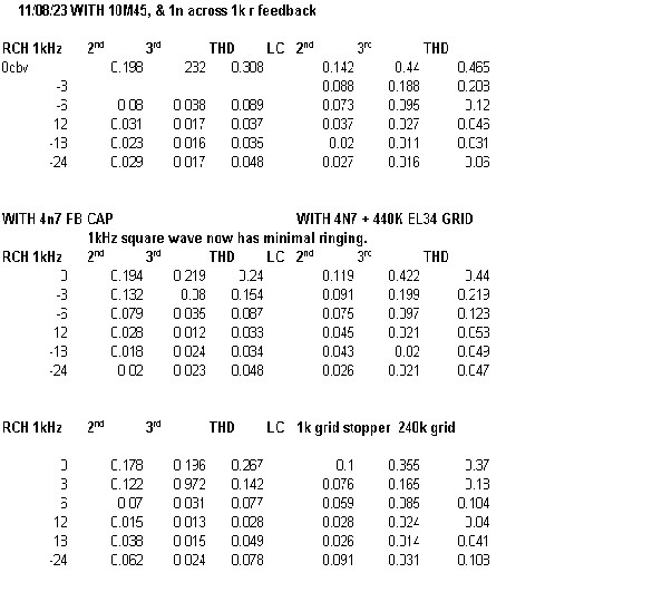

1n across the 1k feedback resistor did nothing but 4.7n reduced the ringing to a negligible amount and reduced the edgyness of strings and the small amount off sibilance.

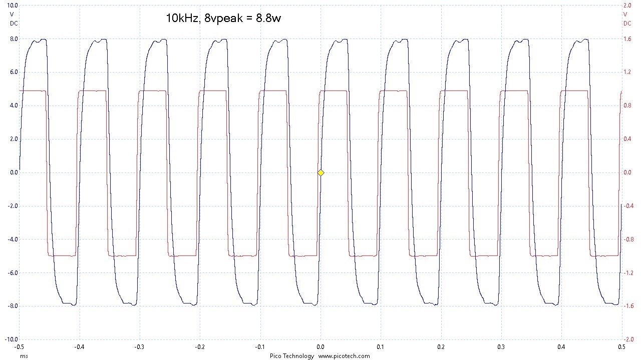

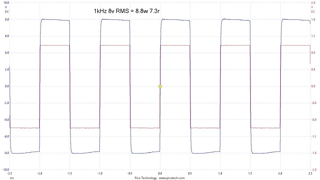

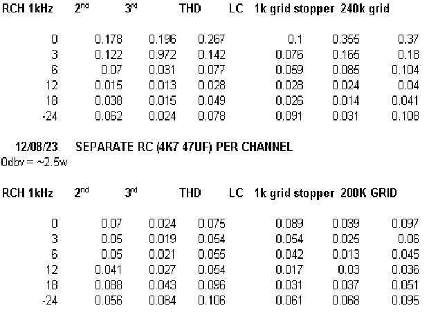

Latest measurements. Now seeing a mssive improvement in performance and extended listening yesterday was free of listening fatigue, no edgyness to strings, brass and no sibilance.
3rd harmonics are now below or equal to the 2nd, even at 10watts.

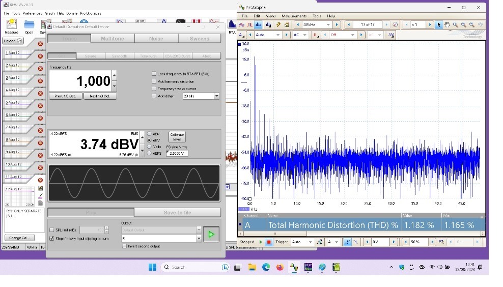

Max output for 1.2% THD is now a massive 10watts (8.6v RMS) at 1kHz, clipping is visible when going higher. Somewhat better than 2watts for 3% of the amp straight out of the box from which I would say the Chinese designer should be shot for spending no time optimising his/her design a for little extra cost.
I fitted a separate RC supply filter so each channel has it's own (4k7, 47uf) which has also improved the channel separation. (bottom table)
The 10K square wave is also much cleaner.
Schematic? The square wave looks much better than #61. I don't know if it was good out of the box we would not have learned anything.

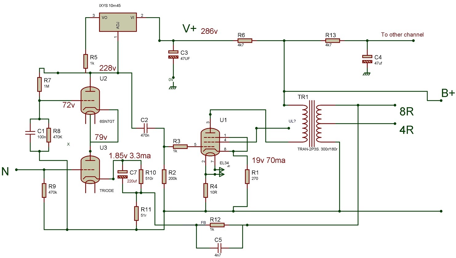

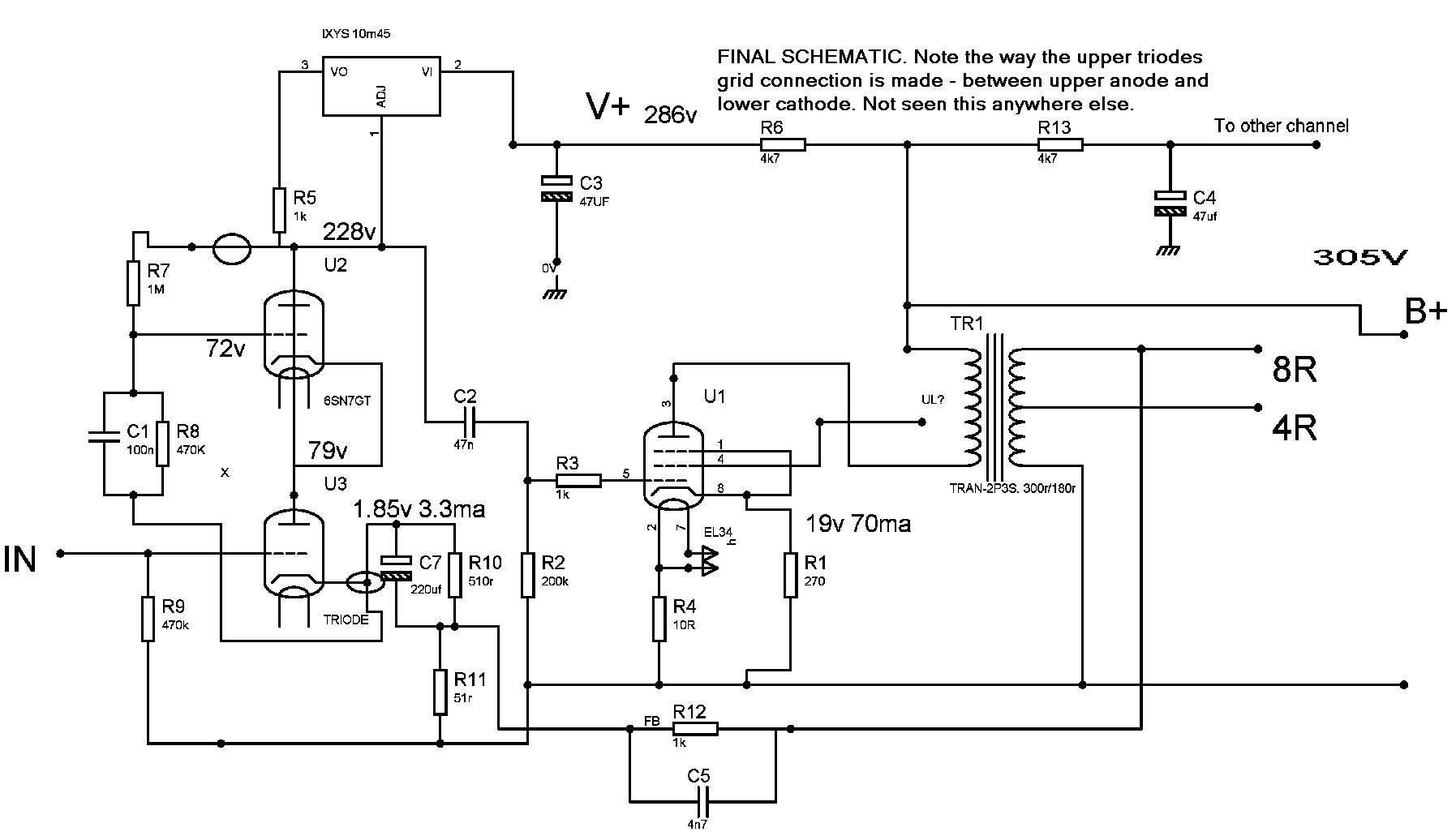

Final schematic.

bateryman,
Your schematic in Post # 65 and Post # 68 has an error.
Pin 4 on the output tube is not connected to anything.
An EL34 without the Screen connected to a positive voltage is unpredictable, or more likely, there is very little or no plate current.
Its connected to the UL tap, just couldn't make my schematic design prog let me connect it for some reason.

It was mainly down to operator error. I couldn't find an audio transformer symbol with a tap. I should have edited it and saved as a new package but didn't bother because I wasn't planning to make a pcb.

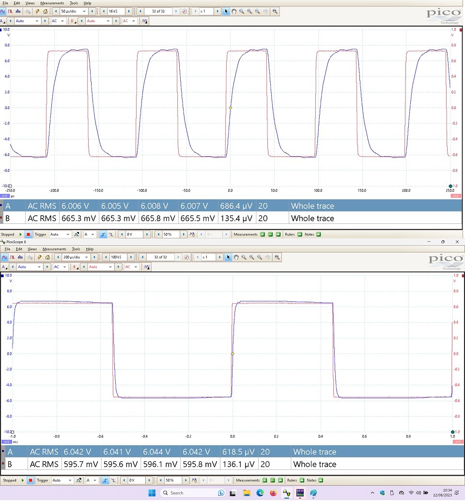

So after a few months, I noticed that the treble was sounding harsh again.
I checked the distortion again and was shocked but not surprised given the sound, that I couldn't get more than a couple of watts before all the distortion harmonics shot up to over 1%. No way could I get 8watts at all. Voltages and currents are unchanged.
I tried swapping the EL34s for KT77s but this made no difference (anode current was the same at about 70ma).
So what can have changed other than the PSvane 6SN7GTs?
