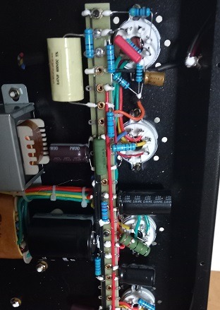

I bought this ebay 'bargain' to drive the Scanspeak tweeters in my Naim SBL active system (driven from an IXO).
The component quality seems ok - Epcos and Nichicon capacitors and Psvanne tubes.

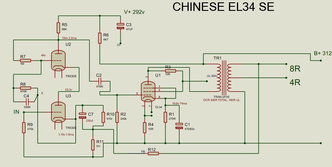

It barely makes 2watts before the distortion heads above 10% so I decided to draw out the schematic.. I hoping to see about 4watts at well below 10% thd. The mains transformer heating and low EL34 cathode resistor suggests that the poor performance may be due to the input stage.
So, given my limited valve knowledge, surely point x should I think be connected to 0v not to the cathode of the lower triode?
R7 should surely be connected to V+. not to the anode of U?
Also, R8 shouldn't be fitted as there seems to be a UL tap on the OT. I suspect some versions may have had a UL/triode switch so to save a few pence: they've just shorted out the switch connection points.
I haven't yet recorded the voltages.
Input stage seems to be cascode so it is made with 2 triodes one on top of another ...
2W in triode mode is low but what is the power dissipation , voltage across tube and current ?
I suspect the output stage is not well designed , for reference look in the EL34 datasheet how it is biased in triode mode

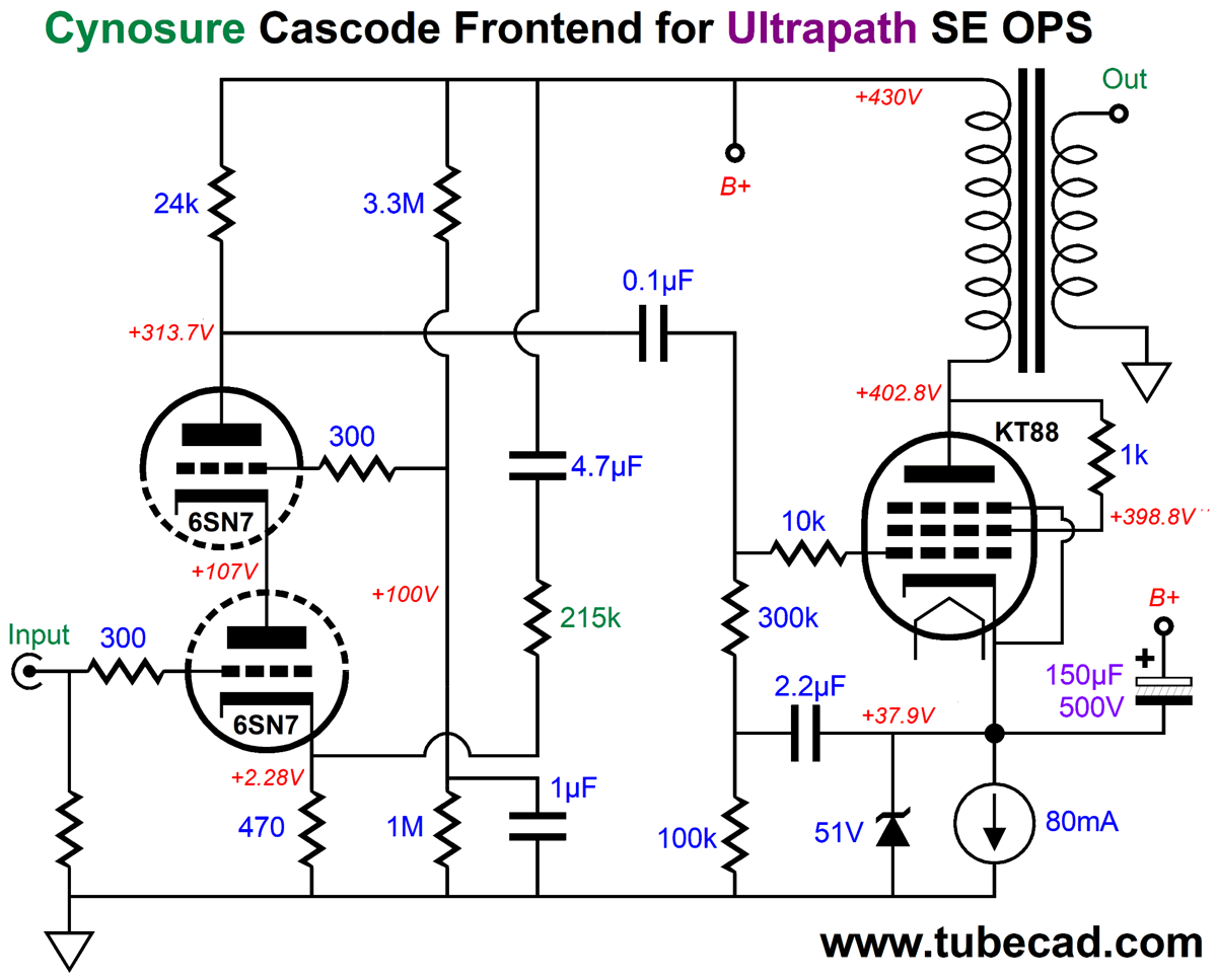

Yes, thought it was cascode but have never seen the upper triode grid connected to the lower cathode and the upper divider resistor taken from the anode rather than V+. From what I have seen, the upper grid is usually biased to about 1/3rd V+ (maybe 100v) with a simple 2:1 divider from V+ to 0v.

If the EL34 is really configured that way then the loading of the tube and output transformer would both be a bit messed up. I would choose one or the other--either UL with the plate and screen separated, or triode-connected with the UL tap disconnected. Either way should improve performance.

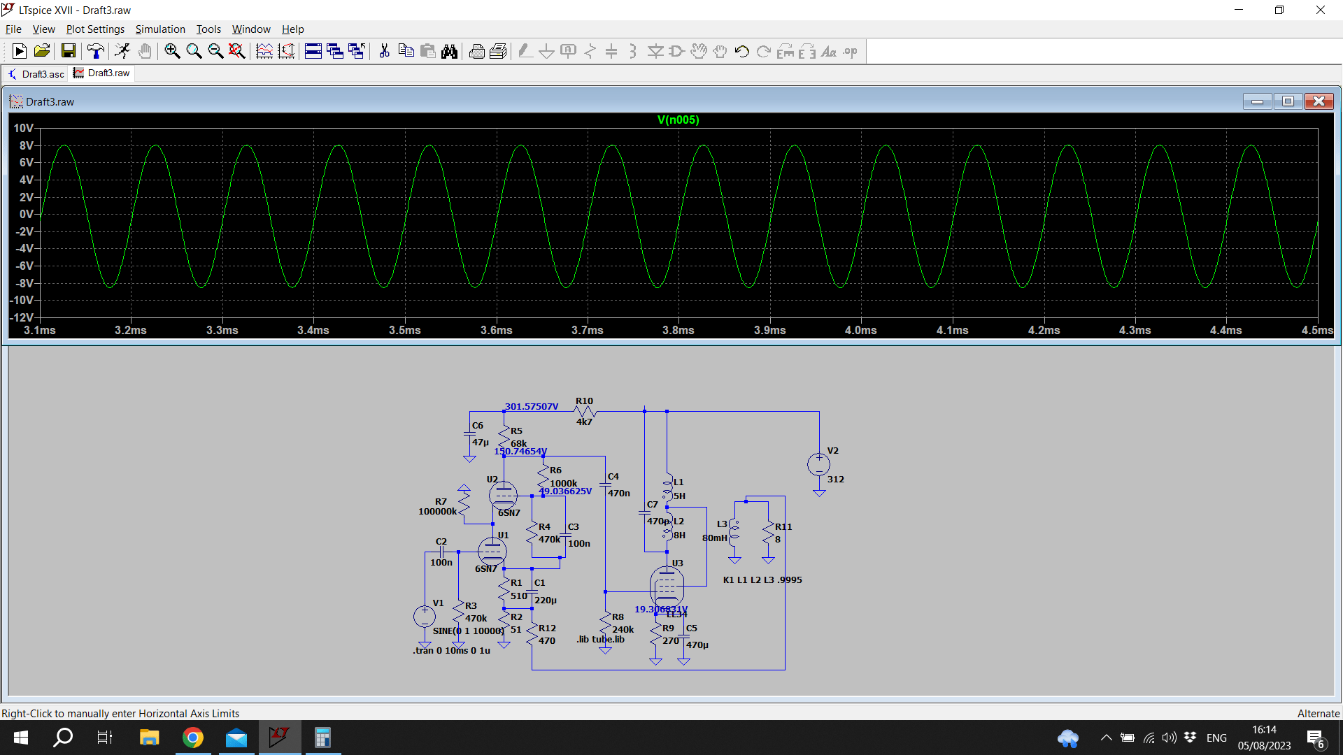

Updated my schematic withcorrect resistor values and voltages.
I think the 6SN7s cathode resistors are too low - surely cathode needs to be a bit higher than 1.15v for a 1v rms input signal?
My plans are to replace the 68k anode load with a current source, connect point x to ground, and remove R3.
In the meantime I will do the above mods except the current source to one channel and compare with the other.

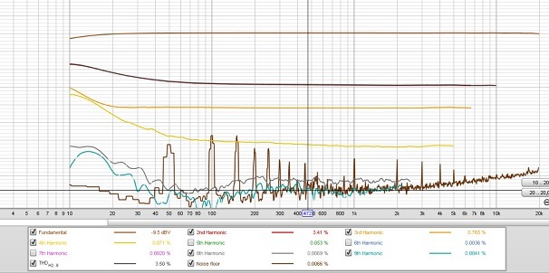

By removing R3, there was a significant reduction in THD:-
No R3 = 3% at 3.15w @1kHz, with R3 3.97%
At 10kHz. 2.9% without R3, with R3 3.8% .
With no R3, @ 1 and 10Khz, 4.3w = 4.2% THD and at 5.4w = 5% THD
At 100Hz, THD are around 0.8%
Swapped the 6SN7s over - same results.
So next step is to try LR8 current source and then maybe other brand of tubes.
You shouldn't have R3 and the UL tap connected at the same time, so either R3 and no UL tap, or no R3 and connect the UL tap to the screen. So yes, your power increased and distortion dropped. You should be able to get 7-8 watts power, but perhaps the output transformer isn't capable enough. I wouldn't worry too much about THD. It's going to be 10% at full power with just about any SET amp.

The distortion at 10k is the same as at 1kHz which is something I suppose. My hearing doesn't extend beyond 10k and the 2nd harmonic of course, is at 20k so inaudible.
