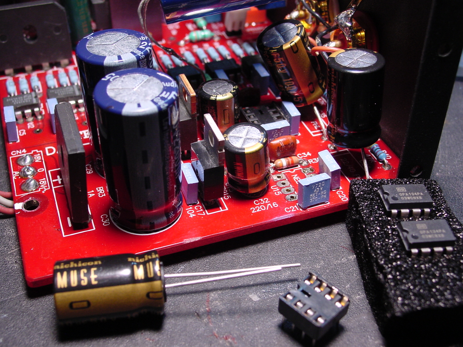

am i going to see any benefit fitting better bypass caps if i'm to do op-amp bypass mod? if so what values are the blue ones after the dac chips? i want to replace all of them.

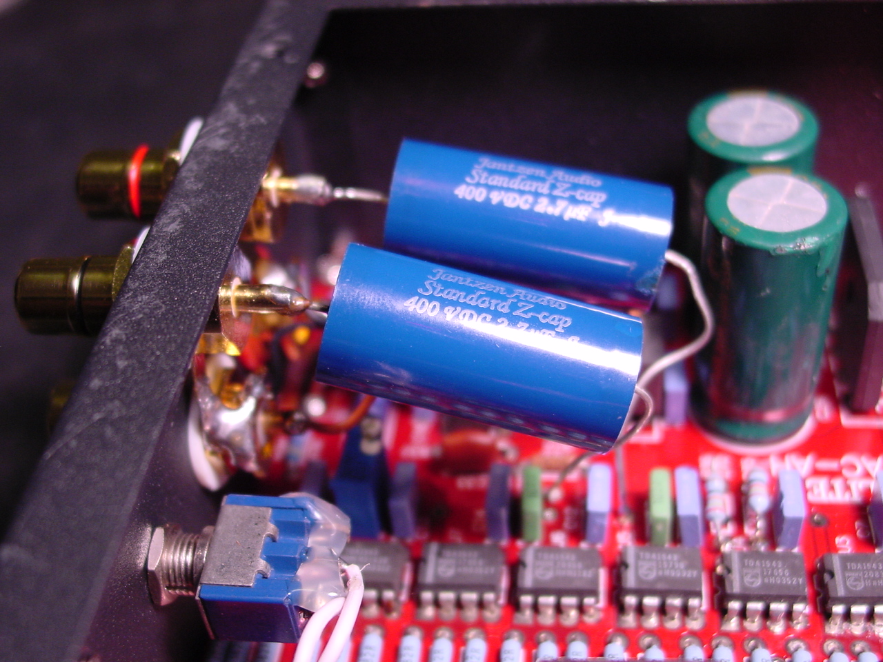

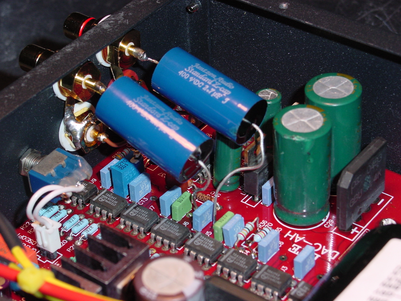

try any electrolytic from 1 to 100 uF (preferably 2.2 uF poly cap) just to see if the distortion goes away. neg side to the RCAs.
Alfred,
be sure existing C35 and C36 output caps are disconnected from RCA jacks
For DAC VDD = 6 Volts:
R35, R36 (I/V Resistor) should be 150 Ohm. To accomplish this, solder 150 Ohm parallel to the existing 270 Ohm. With digital input open, adjust VR1 trimpot for 3.3 Volts across I/V resistors.
For DAC VDD = 8 Volts:
R35, R36 (I/V Resistor) should be 270 Ohm, which is already built in. No changes needed. With digital input open, adjust VR1 trimpot for 4.3 Volts across I/V resistors.
Attention: allow DAC to warm up and voltage across I/V resistors to stabilize before adjusting VR1 as voltage may fluctuate as much as 700 mV during warmup.

Hi Whaleman. Before I did anything, originally with active sounds fine. Comparing to my spoilt Shigaraki dac, I found this Lite had an add on buster.
My bad. I bought 4.7uf sound cap and resistors too to try up after I passive this dac. The distortion was very bad that hardly audible. I found out it caused by removing AC 18 0 18 power input which I plug it off, thinking the active side no longer in use. Now all are okie. Many thanks.

be sure existing C35 and C36 output caps are disconnected from RCA jacks.

C35 and C36,
I removed the connection directly from the RCA, but left the negative intake. Therefore I didn't remove this 2 caps.
Dac Vdd 6, and Vdd 8,
Please enlighten me why I need to choose either both of this. I measure pin 5 and read 5.9v. I had replace R35 and R36 to 180 ohm. I do that because a quick read thru to old posting hoping to solve the bad distortion issue but after hook back 18 0 18 all are fine. Currently adjust to 3.3v for pin 8 and 6.
Dac warm up.
Yes, thank you. after warm up it drops to 3.1 so I adjust it back to 3.3v.

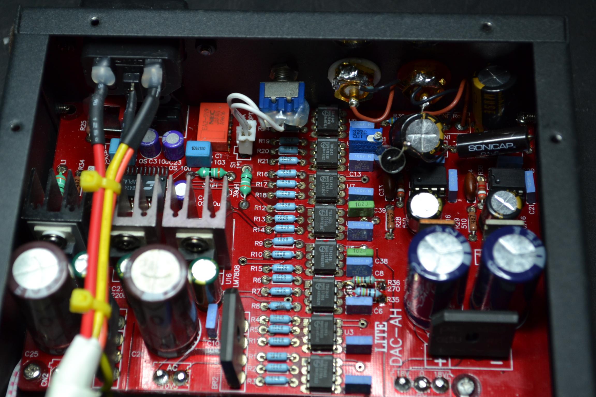

I have to admit that I went back to the active output and prefer it. I upgraded the op amps to TI OPA2604 (single channel version) and I found it very pleasing, very nice mids. I also decided to go with Nichicon Muse output caps bypassed with some very small Sonicap Platinums.
Glad you found your problem. I think the passive mod is matter of taste and it may not be for everyone. You can always add a second set of RCAs (as I did) and have both available on your amp selector switch. Once I found myself never using the passive output, I removed it and the RCAs. The leftover holes provide good ventilation.

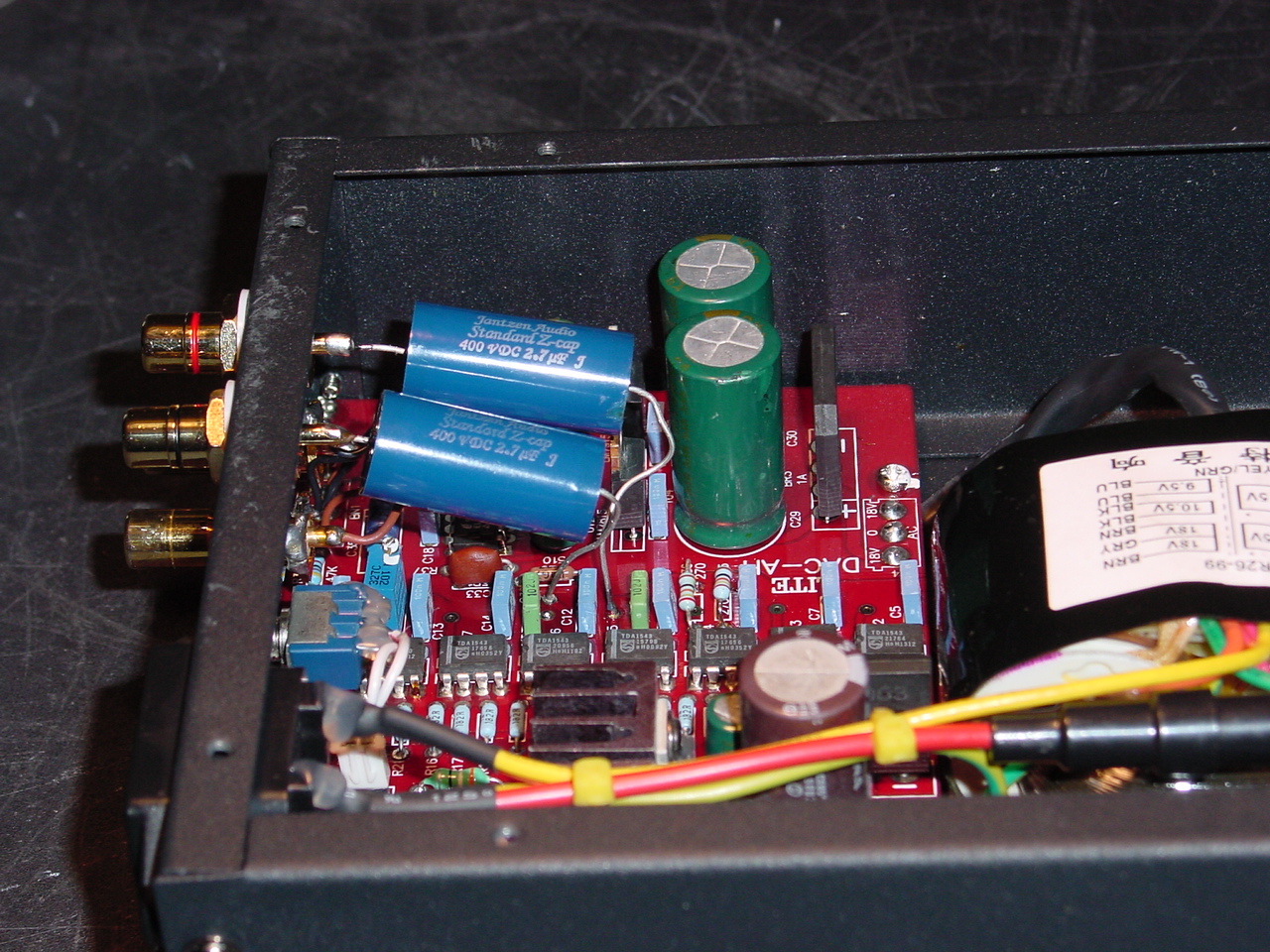

This is all there is to the passive out. No need to remove anything, just add 2 caps and 2 RCAs. You will have to drill holes, or disconnect the existing RCAs.
Alfred,
VDD = 6 V / 8 V:
There are two versions of DAC-AH. One has 6 V regulators (apparently yours), the other one has 8 V regulators. As per TDA1543 datasheet, with VDD = 6 V, 150 Ohm is the correct value for the I/V resistor.

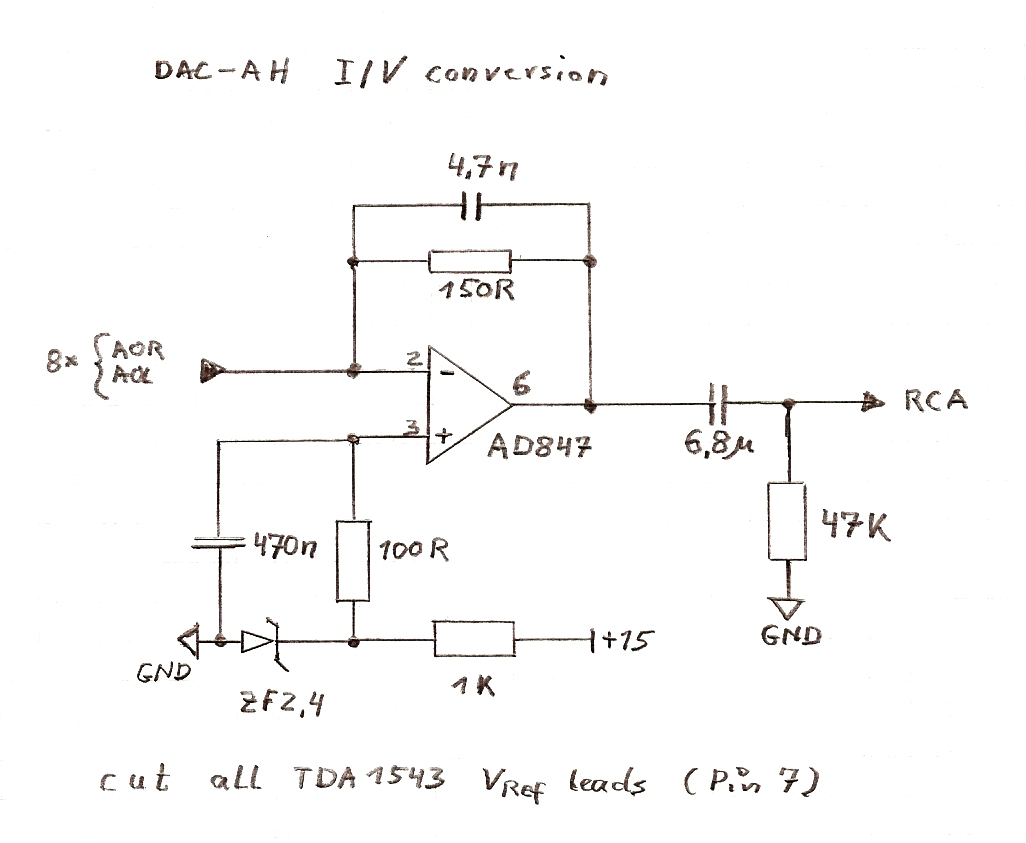

If you disconnect 18-0-18 VAC from the board, you must cut the input leads to each opamp or better desolder both opamp chips.
However, my DAC-AH uses AD847 opamps and I prefer using these in the attached manner. I regard this solution superior to the simple passive output.
Note that I did cut all 8 Vref leads and use a separate fixed Zener input bias to the opamp +input pin 3, one for each opamp. The reason for cutting the Vref leads is that it is difficult to understand the interaction between the 8 DAC chips tied to a common Vref rail, each with a slightly different intrinsic Vref voltage. Creating separate and DAC independent offset voltages for each AD847 should reduce harmonics and crosstalk.
For output caps C35, C36 I use non-fancy standard small WIMA MKS-2 polyester type with 5% tolerance.

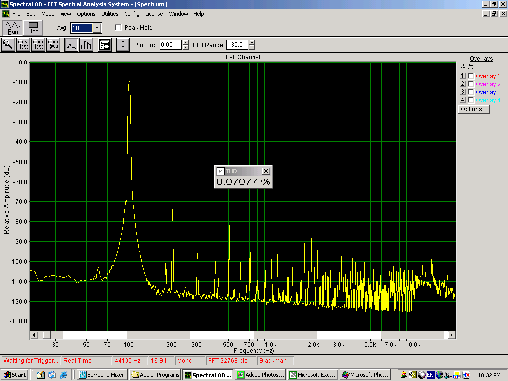

I received my Dac Ah this week and, after correcting the output resistors to 148 ohms (for the V supply) and tweaking the offset pot for 3.3V dc at the combined dac output to center the dynamic range, I have to say I was very disappointed. It sounded somewhat distorted and the bass would lose control
So, I dug back inside the Dac Ah and turfed the output op amp with the passive mod well described by Kim in another thread. I’m not fond of the dac ah’s o/p stage: it uses a non-inverting op amp with no dc block on the input. Effectively, the +ve and –ve leads are imbalanced by the dac dc o/p, 3.3V. Even the TDA spec sheet shows the better implementation, an inverting op amp with the +ve lead biased up by Vref. My unit was also shipped with AD847 high speed op amps. The original cct called for 5532s, and the 847s are much more particular about layout. For all I know the 847s may be oscillating (no high speed scope at home or I would have checked, bu there's allot of hash in the high frequencies of the THD plot, before the mod).
Instead of depopulating the op amp, I connected its output to ground through a 2.4kohm resistor (the 847 likes to see >1kohm), and ran a 3.3 uF good quality poly cap off the dac o/p to the RCA jack. This is going to be used with a Govibe 5, which has an input impedance of 8.75kohm at full volume, and 9.5kohm at min. The 3.3uF was the min size, to avoid premature bass roll-off.
I hooked it back up and instantly: BANG! THIS is what everyone’s been talking about! Before the passive mod, the drums on Kyuss’ “Thong Song” sounded like they were about to explode into tinder, and the strings of the guitar on the Beasts of Bourbon “Not Gonna Try No More” sounded like they were scraping against the fret board. Mids are now forward, but not too bad and the high’s cleaned right up. The thing’s still a bass monster, the DT770 of dacs 🙂 but it’ll make a decent dac for work.

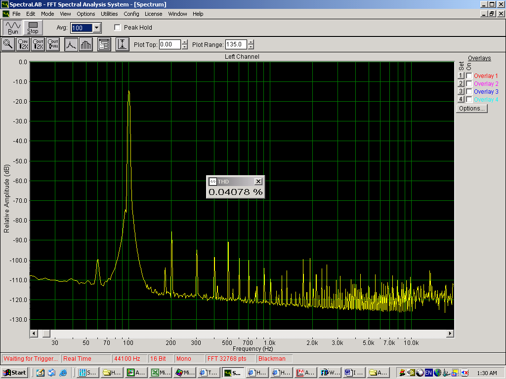

Here’s a final THD measure after the passive mod attached
The picture doesn't come close to doing the change justice, but what does stick out is that the nasty 7th has decreased significantly, as has all the “hash” up at the top end. I don’t know if this explains the difference, but it’s a good thing. The pictures also show that about 6 dB output is lost with the passive mod.

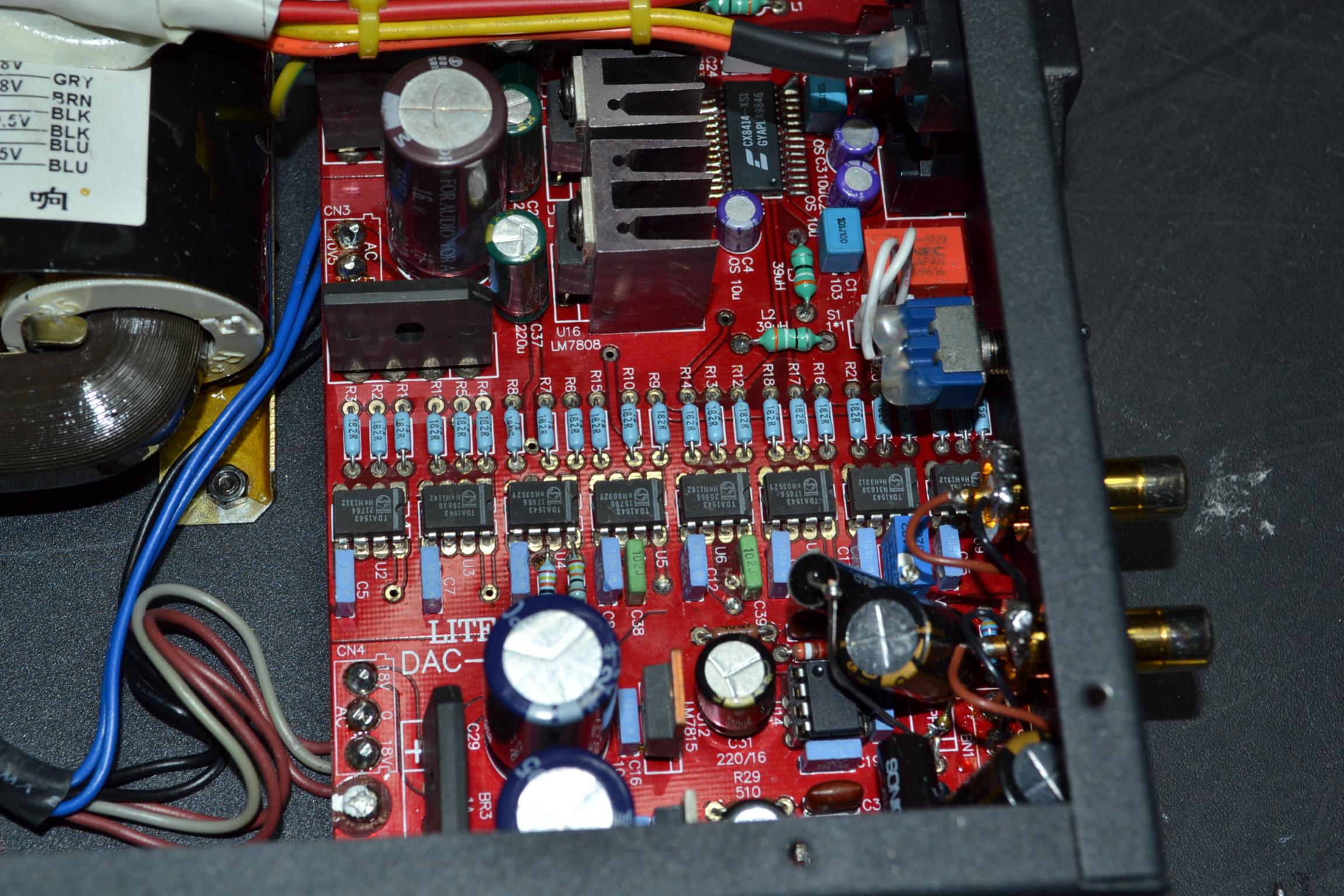

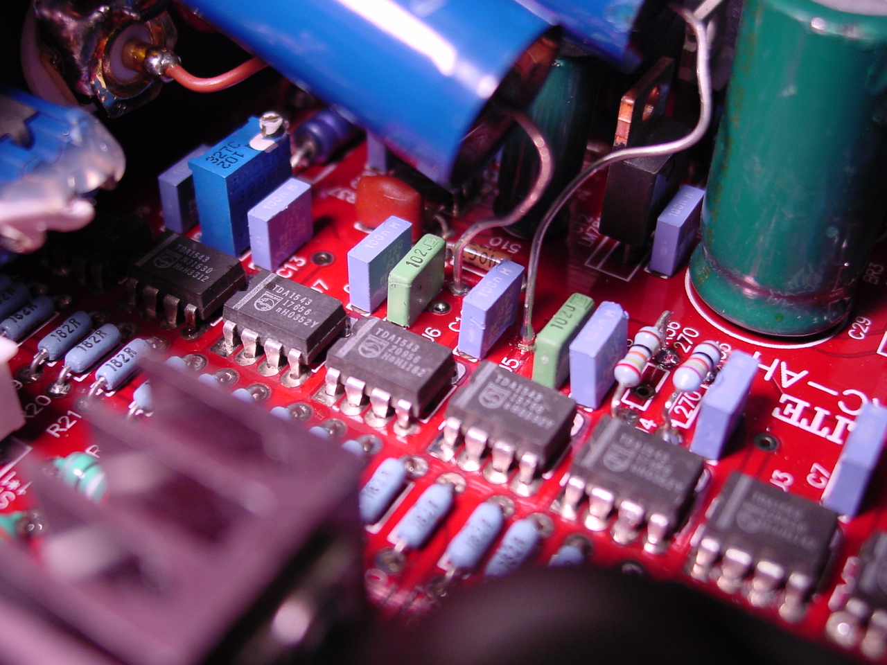

I go a bit further, somehow hope I don't destroy it last 2 days. First, I removed all active components and ac input. Ya, no longer sound short distortion and back to normal but weak knees. Very tempting vocals. Nothing much things had replaced. Iv used 180ohm (due to no stock for 160 ohm. Output caps simple at 4.7uf and that is it. Comparing to Shigaraki still the gain and dynamic not there. Shigaraki sound harsher.
Yesterday was abit insane. I removed one of the psu feeding x4 chips. (the far right inclusive of heat sink, regulator. Worsen, weaker gain but very smooth. Due to this, my gainclone don't runs that hot. : Today I will again, remove all filter resistor and use cable jumper (which I don't think it is nessesary). Change to 08 instead of 06, and hook back 270 ohm. See how it goes.
