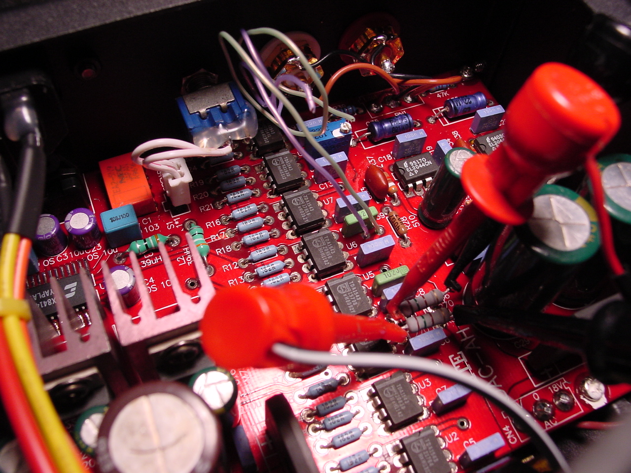

2. Started to poke around in original circuit with oscilloscope. Created 22050 Hz 0 dB (16 bit full scale) square on left channel (2 samples per sqare), digital silence on right channel. I/V resistors 150 ohms each. Right channel shows decaying oscillation: 50 mV pp max, total duration approx. 6 us, frequ. approx. 800 kHz. Amplitude varies with excitation. Vice versa when changing channels --> -34 dB (!!) crosstalk problem. Will keep an eye on this.
Also tried to identify any crosstalk from BCK/WS/DATA lines to AOR/L but could'nt find anything significant. Small decaying 75 MHz oscillations are probably caused by suboptimal scope probe coupling (German readers: wer misst, misst Mist).
Unfortunately, I have no means for digitally recording oscilloscope traces, can only photograph screen. As there is nothing exciting yet, I will save this for later.

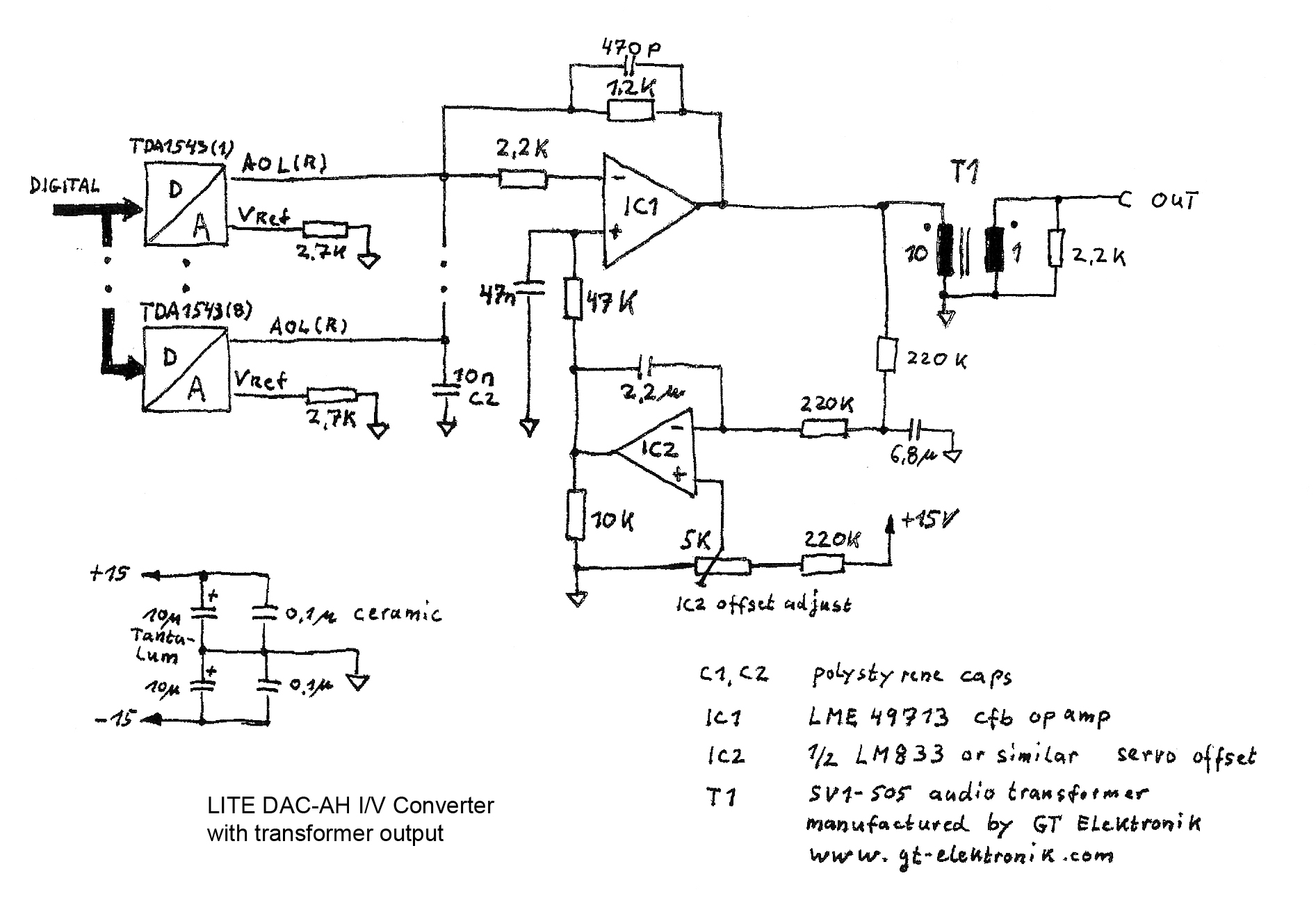

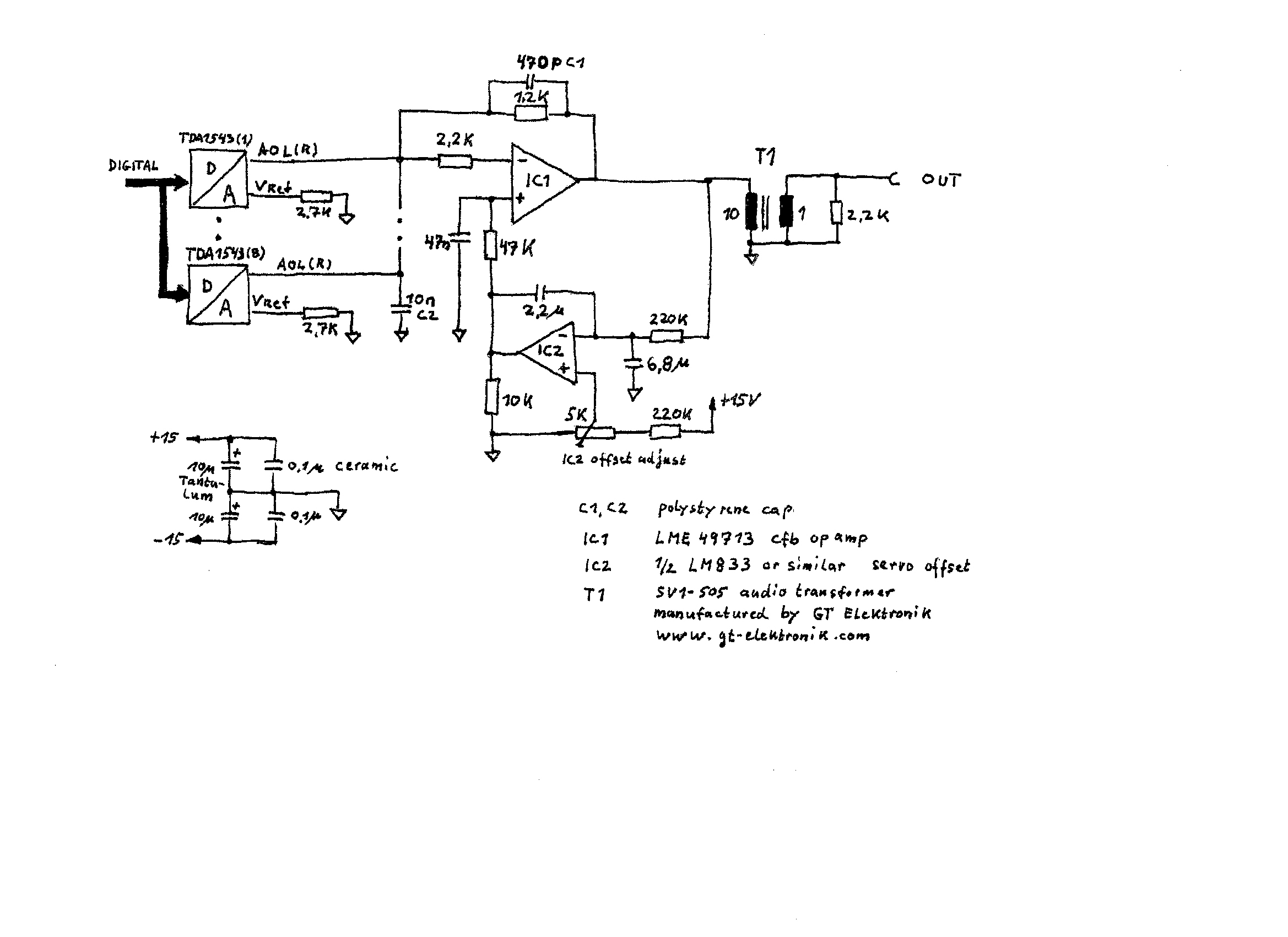

I/V converter with LME 49713 cfb OP Amp and transformer output
After reading about current feedback op amps I tried an LME49713 as I/V converter. This amplifier has excellent reputation for its audio performance. It requires a 1.2 K feedback resistor, the total current from 8 parallel TDA1543 giving approx. 22 Vpp max output. To bring this high output voltage swing down to the common 2 Vpp range I use a 10:1 step down transformer and a servo amplifier to eliminate any DC component in the transformer primary. The servo circuit reduces the DC to less than 2 mV. This makes a coupling capacitor unnecessary.
When used in an inverting amplifier configuration, the LME49713 tends to ring. It can be easily "tamed" however with a 2.2 K resistor between current summing point and inverting input and a 470 pF shunt capacitor across the feedback resistor. With these measures impulse response becomes totally flat.
T1 is a cheap audio transformer made by German GT Elektronik. The Reichelt part number is NFU1-10, selling for 2.35 Euro. The 2.2 K resistor across the output suppresses any parasitic transformer oscillations caused by the typical high Z line load.
How does it sound: marvellous. Best non-oversampling DAC I ever heard. Also because English is not my native language I will not attempt to write any flowery or esoteric portrayals. Instead, go ahead and build this simple circuit and listen for yourself. Happy soldering! 🙂

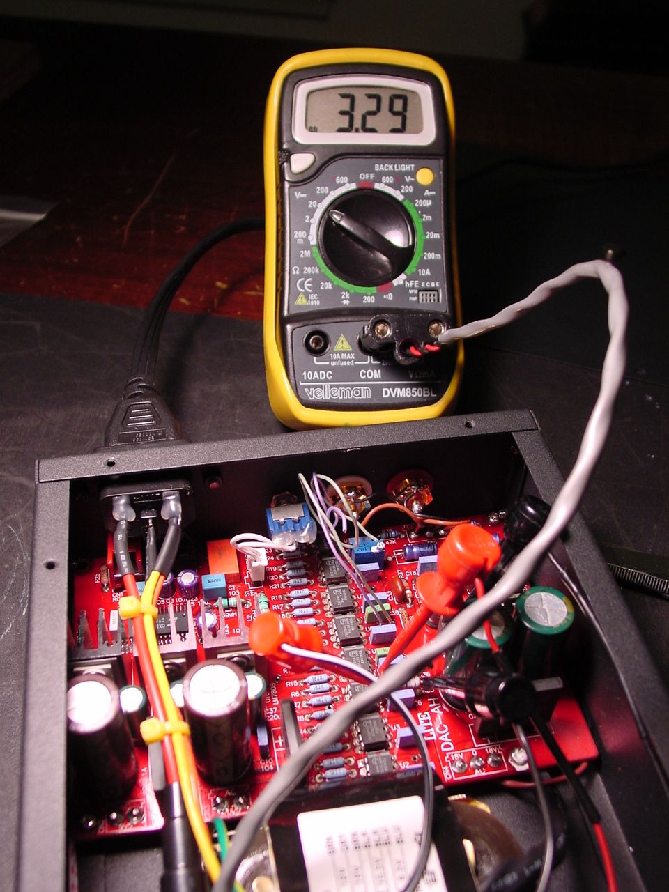

I confirmed this yesterday as I replaced R35 and R36 with 150 ohm resistors. The DAC sound became dead, like a good cassette player. No life. This is after trying the bias voltage at anywhere from 2.0 to 5.0 volts. Even the recommended 3.3 volts setting did not work. So back went in the 274 ohm stock resistors. Of course, the distortion is back too on very loud and complicated passages.
So, has anyone figured the correct ohm resistor? 230 ohm maybe?
I am not willing to go with the LM7808 regulators.
I did have a chance to tap in for the passive output using 2.2 uF caps.
Any suggestions for snap in Op Amps? I don't want to change the case types as some do.
Would not recommend this DAC to non-DIY people.

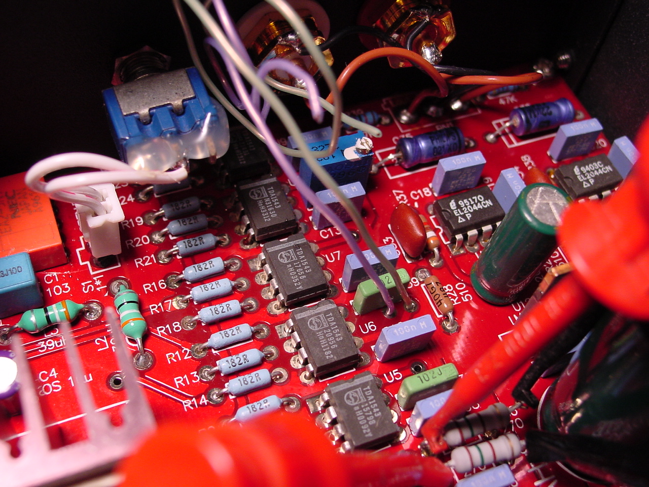

I will answer my own question 😀 since I found out by "resistor rolling" that 240 ohm resistors to replace the stock 274 ohm R35 and R36 provide the best balance on this DAC before you start to cut its legs off and also eliminate peak saturation and distortion on loud and complex recordings.
At least to my ears, the DAC now lives up to its reputation written about in all the threads. Up next is the passive mod and hear I am in for a treat.
So, to summarize 240 ohm resistors for R35 and R36 and about 3.0 - 3.3 V bias voltage.
The pictures show the now removed 150 ohm resistors. Also notice the CAT6 wire tap-ins for the passive mod that will be done next.

use active I/V Converter

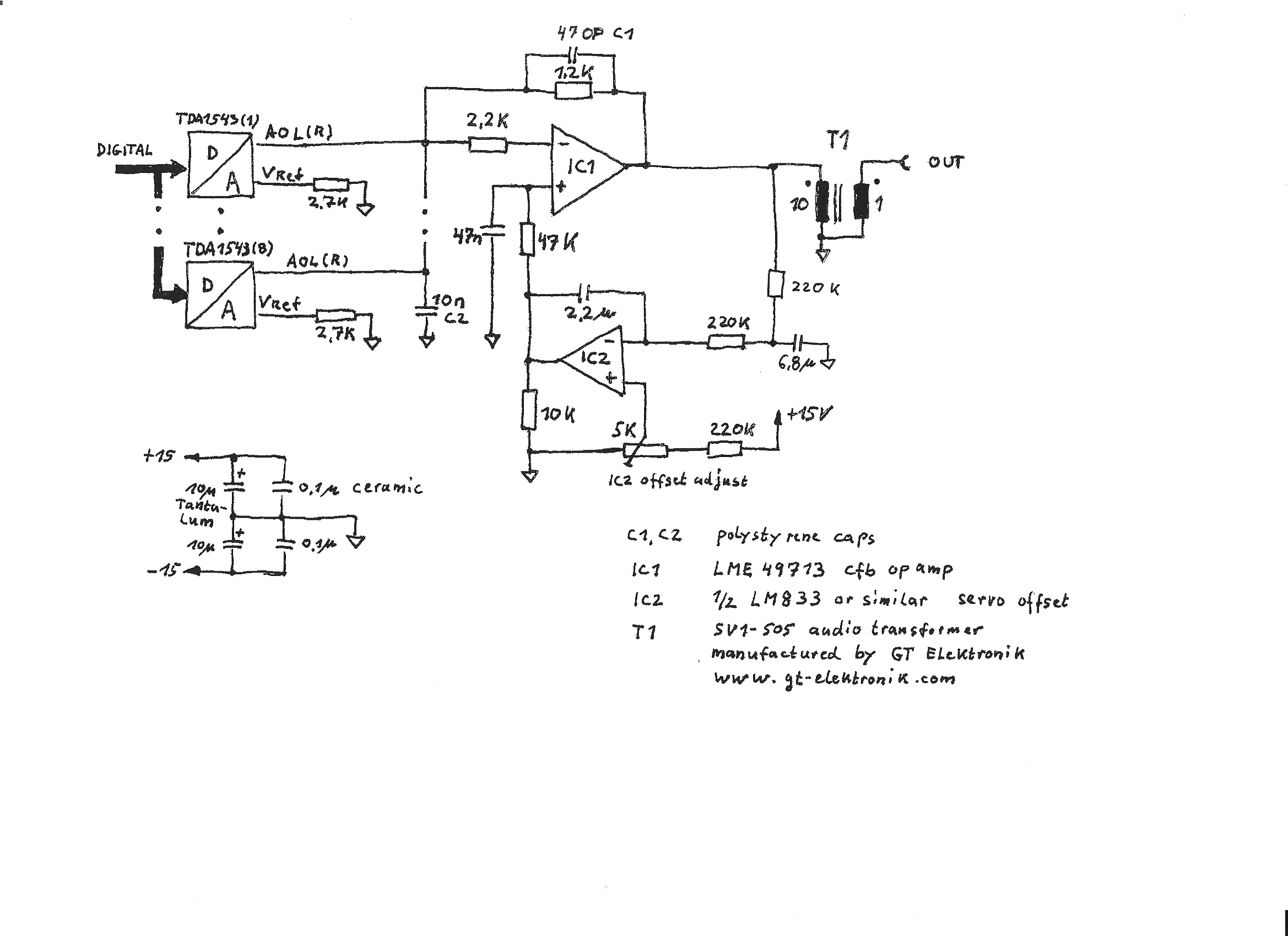

whaleman, you might want to try my circuit. I am using two such modified DACs for over a year now. They sound good.
If I ever do another one, I will use a 6:1 transformer from the same manufacturer, only for the lower winding capacitance. I doubt though, that there will be any audible difference.
See the updated schematic (attached) for reference.
-Karsten-

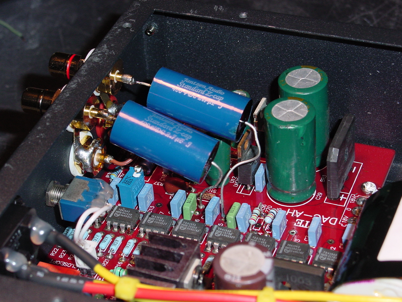

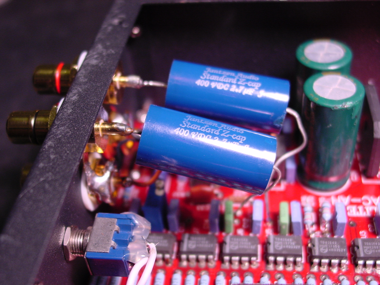

Thanks Karstenpg, I may try this with a second DAC AH. For now I've added the passive mod using Jantzen 2.7 uF capacitors and an additional pair of RCA jacks.
The sound is very nice, the bass is very tight and the highs cleaned up nicely. This DAC has a lot of potential, so I will probably do another and consider your mod.
The caps can be inserted from the top and soldered from there. A little heat rash to nearby components is almost inevitable.

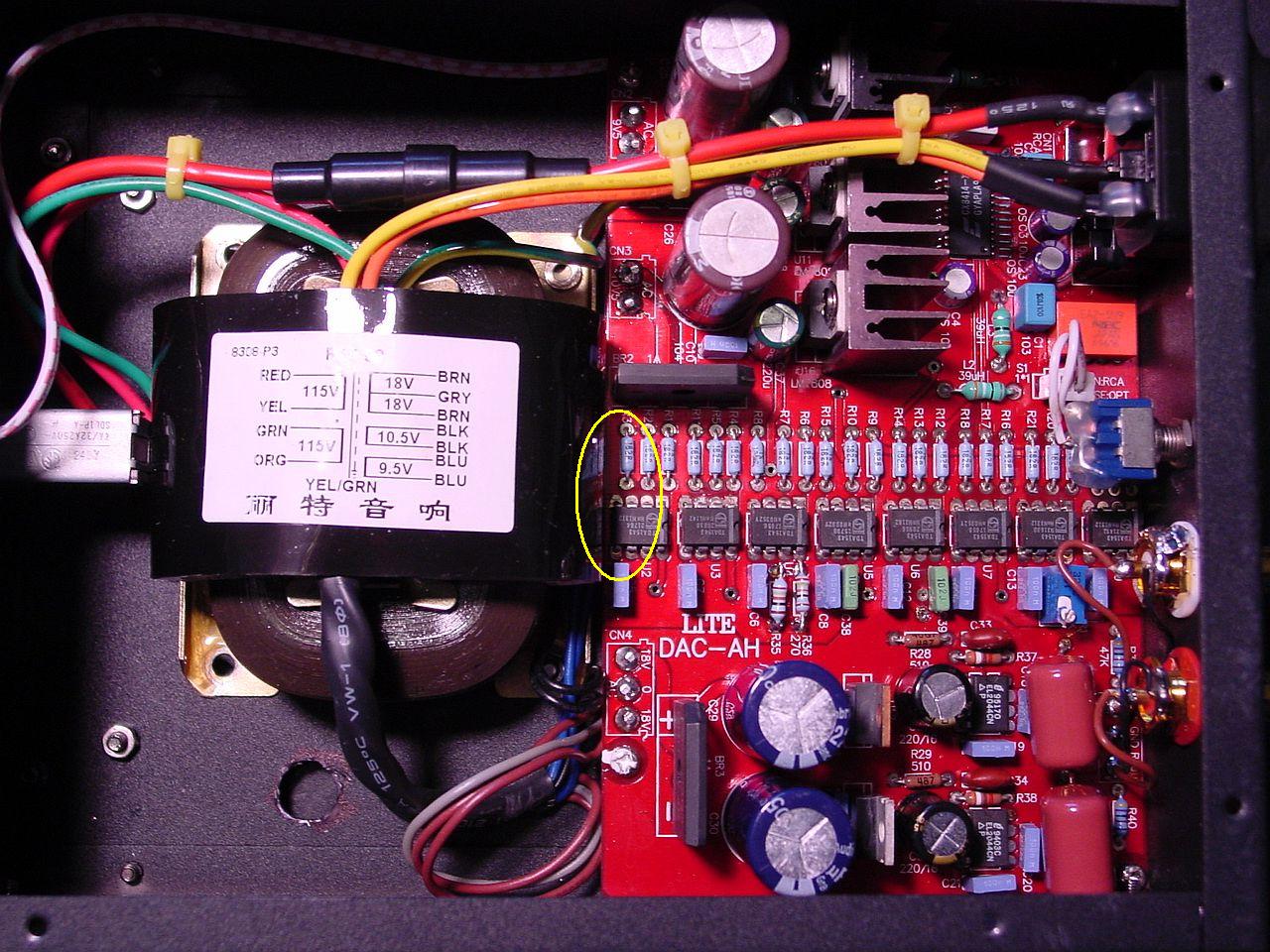

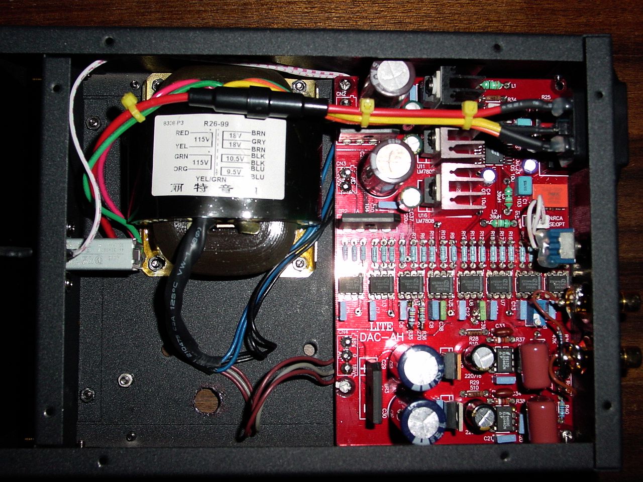

I had a hum in the right channel at loud volume, so I removed the passive mod, I thought it was picking something up and I really was not using it. Hum still there. Replaced caps with good quality and higher capacitance. Hum still there.
Then looking at the DAC, I notice the transformer next to the right channel DAC and components, presto! I removed it and placed it as far away as I could from the components on the board. Now, hum 80% gone. The rest is impossible to remove unless the transformer is moved outside the box. I know some have found this out already, but it is cool when you figure it out for yourself. Notice the before and after photos.
As a side benefit, now there is some ventilation for the once sealed case.

@ Cola: copper shielding will have close to no effect against magnetic stray fields.
@ whaleman: EACH DAC chip contributes equally to BOTH audio channels (see circuit diagram).
The stray field of this type of transformer is far too small to induce audible hum current through the I/V resistors. Therefore, it is unlikely that moving the transformer alone did really reduce the hum. On one channel only?? Is it possible that you changed the overall setup / wiring in your installation somehow when you reinstalled the DAC-AH after moving the transformer?
I would suspect some kind of ground loop as the real cause instead. Try using the optical SPDIF input (ignore any tales about the negative influence of optical SPDIF on audio fidelity. You won't hear the difference).
If you cannot use optical coupling, modify the coaxial SPDIF input, as this input is not isolated:
** Remove the RCA connector from the DAC pcb.
** Mount an isolated RCA jack in the now free hole on the rear panel instead.
** make a 1:1 pulse transformer by winding 2 x 6 turns of suitably thin enameled wire on an Amidon BN 73-2402 binocular core (available from Mouser) or salvage the pulse transformer from a scrapped Ethernet PC interface (the old kind with a BNC connector). I am using the homebrew transformer.
I have not tried the Ethernet transformer but I have read somewhere that it works as well.
** Glue the pulse transformer to the DAC pcb in place of the removed RCA connector. 2 component epoxy will make a secure joint. Solder the wires: primary start to RCA inner connector, primary end to RCA outer connctor, secondary start to former SPDIF input, secondary end to digital ground.
Also, make sure that the power cord protective ground is connected to the power transformer shield winding (shield between primary and secondaries) only and has no connection to the DAC PCB.
This will prevent any ground loop between DAC and connected equipment and should solve your problem.

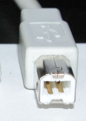

Adding USB to the Lite DAC AH
How can I add a USB connector (to accept cable pictured) into this DAC? Do I need a separate receiver? or will the CS8414 handle the new input?
This is so I can hook up directly to a laptop USB out direct digital (bypassing the laptop sound card).
Thanks.
