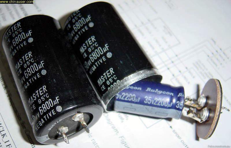

Just got some caps on fleabay and something didn't seem quite right so did a bit of (20/20 hindsight) research and found..
1: Nippon Chemicon don't make a 100uF 450 volt KMG cap
(the biggest at that voltage level in KMG is 47uF)
2: The KMG range is wire ended, not snap-in

Nordic said:
You gotta be kidding.. is that the first time you see that pic?
I have even recommended people use this method, when refurbishing old gear, to keep the original look...
I must confess, it is the first time I've seen that pic.
For re-furbishing old gear, yeah great idea no probs there. But to put a 35 volt 2200uF cap in a 50v 6800uF? or have I mistaken the photo as a fake rather than a restoration? :xeye:

Guys
Do you think that the Chinese counterfeiters are stupid enough to put a Rubycon capacitor inside a fake ? A cheap Asian capacitor, perhaps. I saw this photo a little while back.

I think I've seen original Chemicon KMG or KMH 4700uF/50v snap-ins, so I'm not sure that's conclusive. However, there are several other indicators, including bad fonts, that indicate that the pic shown in the OP is that of a counterfeit.
There is another indicator not obvious from the picture - the text "negative black" printed on the plastic sleeve, yet neither rivet has a trace of black paint. I hope there are no Chinese counterfeiters reading this gathering hints on how to make more convincing looking fakes 🙂
