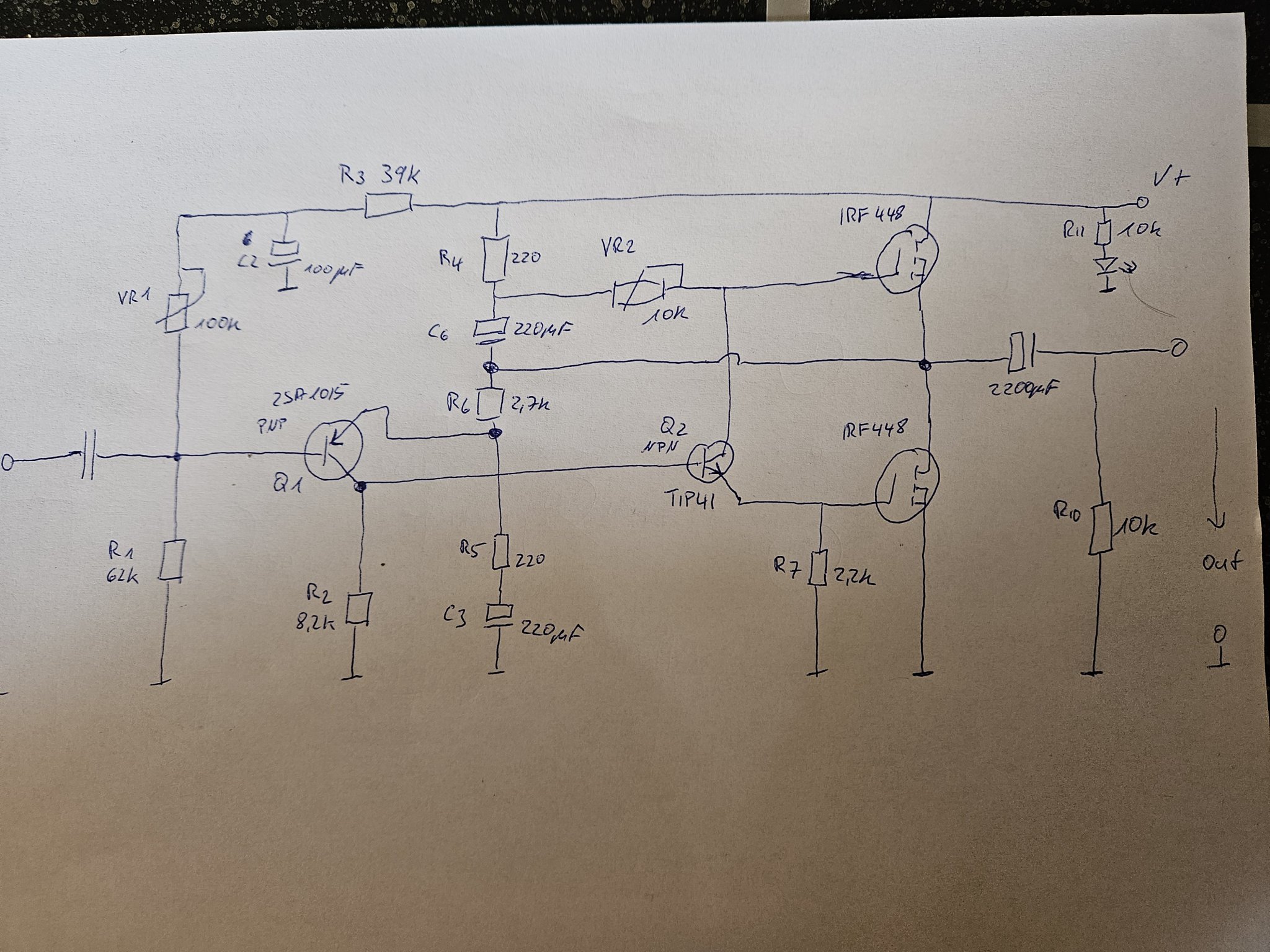

//Edit: I have traced a circuit diagram of the board and the component arrangements correspond to the org. design. The position of the power amplifiers is even marked with 2SC5198. I'm thinking about swapping the MOSFET for normal transitors.

MOSFET's are fine for Class A provided the circuit is designed from the outset to use them.
If this AIYMA 69 is meant to be some kind of copy of the JLH69 then MOSFET's are not suitable as direct replacements, there would need to be considerable redesign.
Without seeing an actual circuit diagram its impossible to advise more... the 30ma bias current sounds bizarre and more suited to a preamp or headphone stage if Class A is intended.
I quickly identified and traced the components. it looks like the Chinese just replaced the transistors with mosfets and kept all other values. It is strange. I am new in amplifiers, but what do you think?

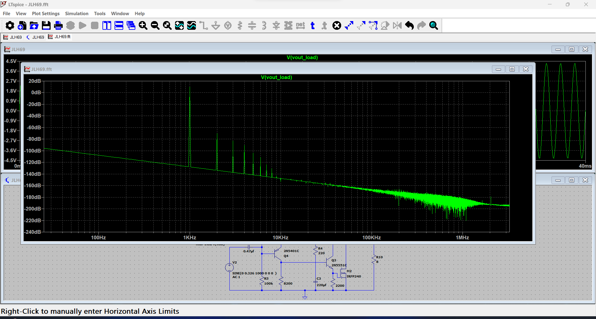

Interesting. So the 'secret' to the FET design is replacing the preset with a 10k to allow a lower bias current to be set. This allows the stage to run in a poor sort of push pull Class B stage

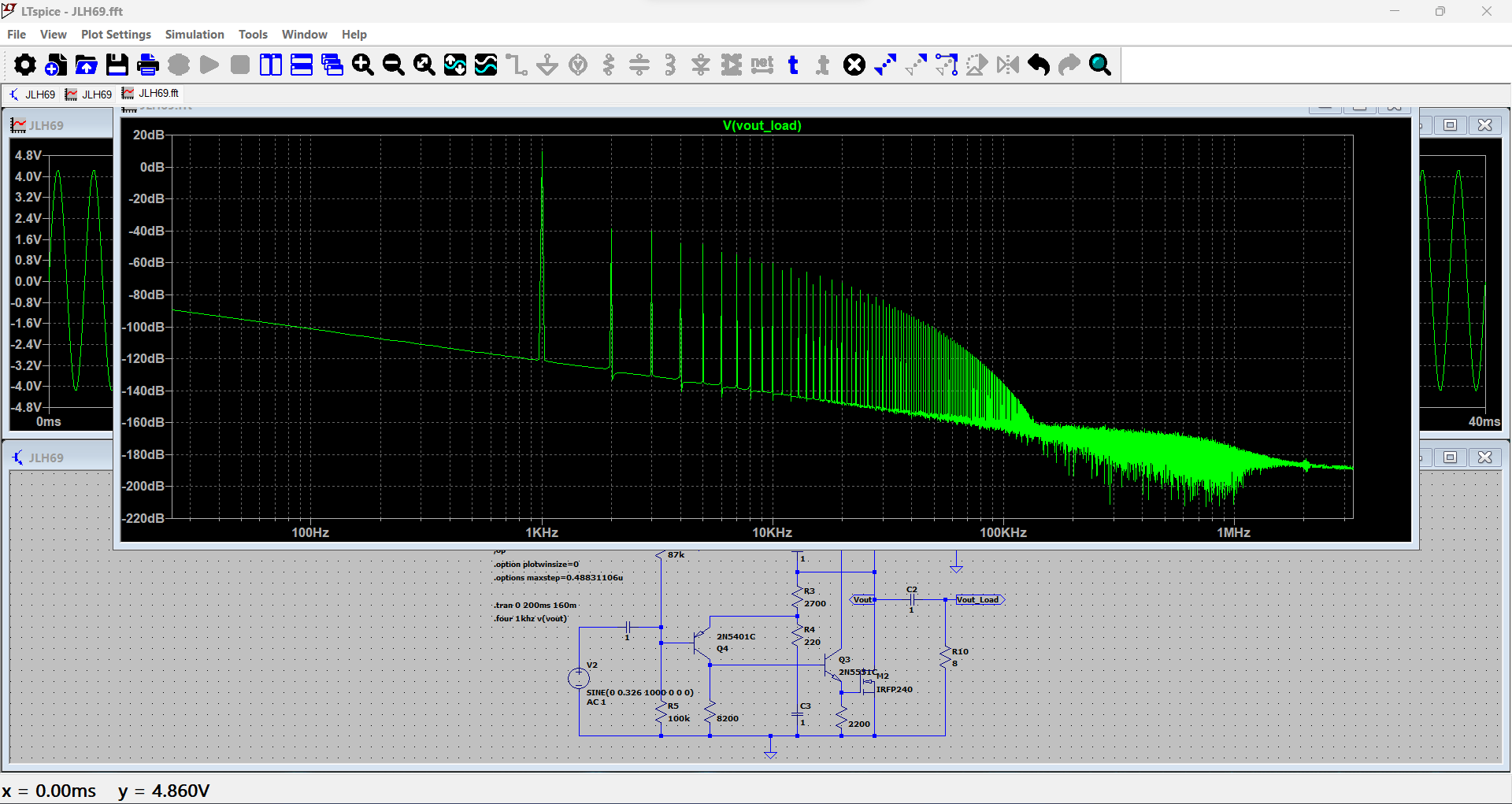

Here is the distortion plot of the original Class A and the FET version.
This is the FET and the distortion is poor and has lost that 'magical' profile of a typical Class A output stage. This is reminiscent of Class B amps of the 70's and 80's.

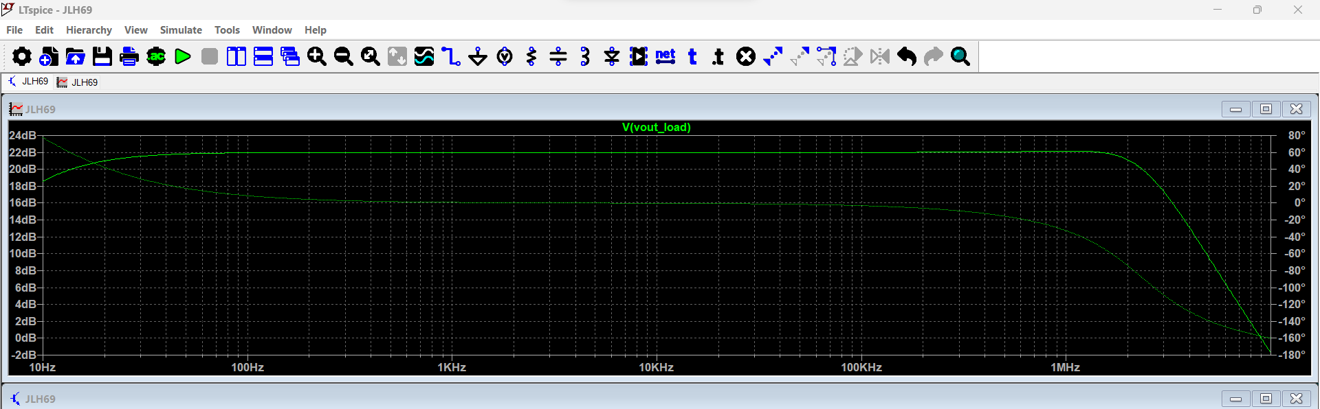

And this is the regular JLH running in correctly biased Class A.

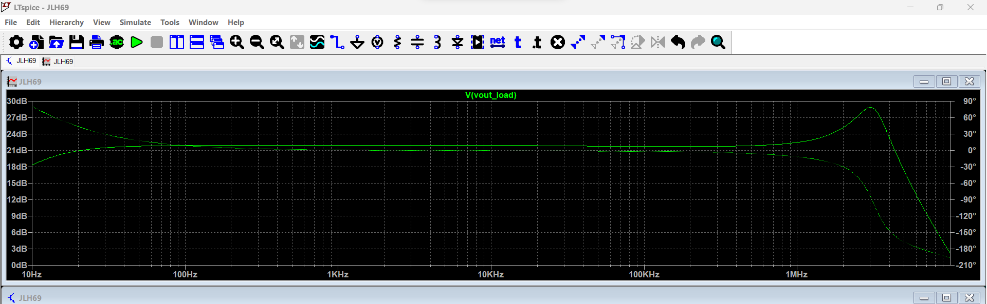

Also the FET version compromises stability and has a poor peaky response.

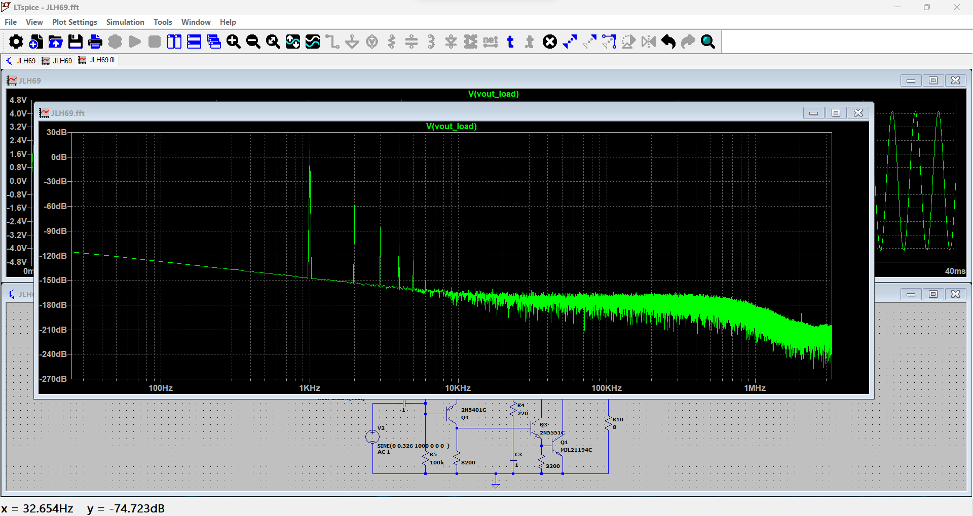

And the original even with using modern faster parts is still well controlled.
So this FET version is imo a poor design and is nothing like the original in concept unfortunately.

The 2SC5198 should be OK if you alter the component values back to the original. That would mean the preset would have to be much lower in value and in simulation with modern transistors a value of around 250 ohms gives the correct bias current. One real issue is that the wiper of the preset carries quite a high current of around 35 milliamps and that is really to much for any small type preset or multiturn type. One option would be to tag a preset in temporarily, set the bias and then remove and measure the resistance and fit a fixed value.
Your other option is to use the FET's but bias the amp to the correct value which I think was around 1.2A for an 8 ohm load.
The APT50GN60BG is an IGBT which is a bit like a FET input at the gate (or base) but controlling a BJT transistor. All things, well most things, are doable but I wouldn't like to say what modifications would be needed or how it would ultimately perform using those.
Try biasing the FET's first to a higher current. They will get hot (just the same as the ordinary transistors) and you should increase the bias slowly and let the heatsink stabilise before increasing to a final value. Set the final value with the amp fully hot.
