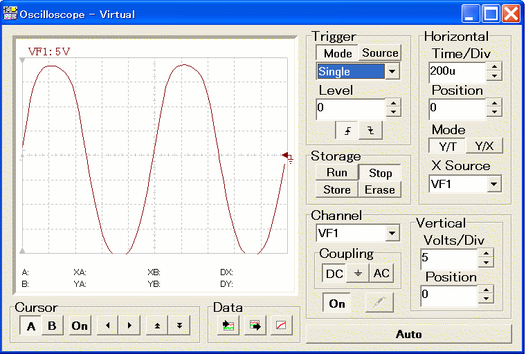

Thanks for reading my post.
The attached photo is obtained from TINA simulator to indicate
the grid swing of 805 when the amp outputs 40W.
The minus peak of the signal reaches to -44V although this amp
does not have minus voltage power supply. This is caused by
an inductive load of 2A3.
Oh, I see it now. Interesting design...
I think, in that case, everything depends on the quality of the choke.
The screenshot from the simulator shows some distortion (the negative peaks are narrower than the positive peaks), do you think this is caused by the 2A3 or by the choke?
I don't think this distortion is caused by the choke. This distortion
is mainly generated by the first tube of Chinese 6AC7 pentode.
The low output impedance of 2A3 cathode follower mitigates the
characteristics of the choke. In other words, a cheap choke can be
used in this topology. This is a secret point of this design.
The attached photo shows output waveform when 40W output.
The distortion of the grid as you pointed out is canceled by 805's
distortion and looks symmetrical. This is another secret point of
this deign.
Overall NFB : 3dB.
THD: 8% @ 40W
Dumping Factor : 1.2
