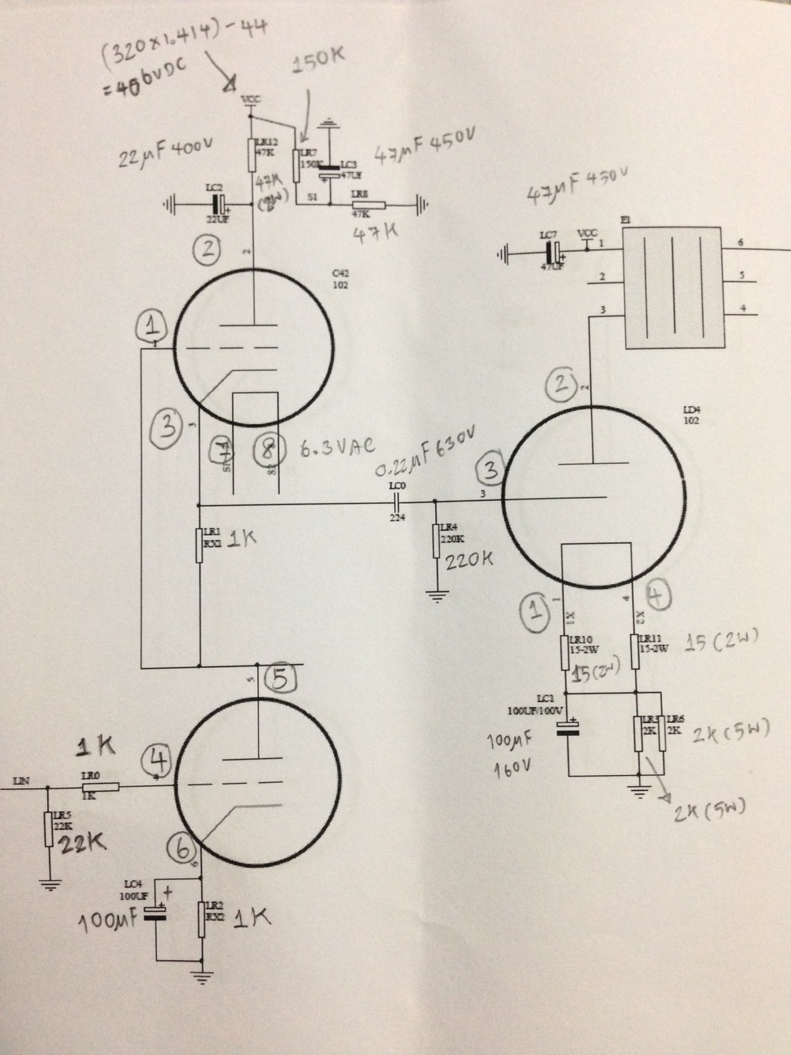

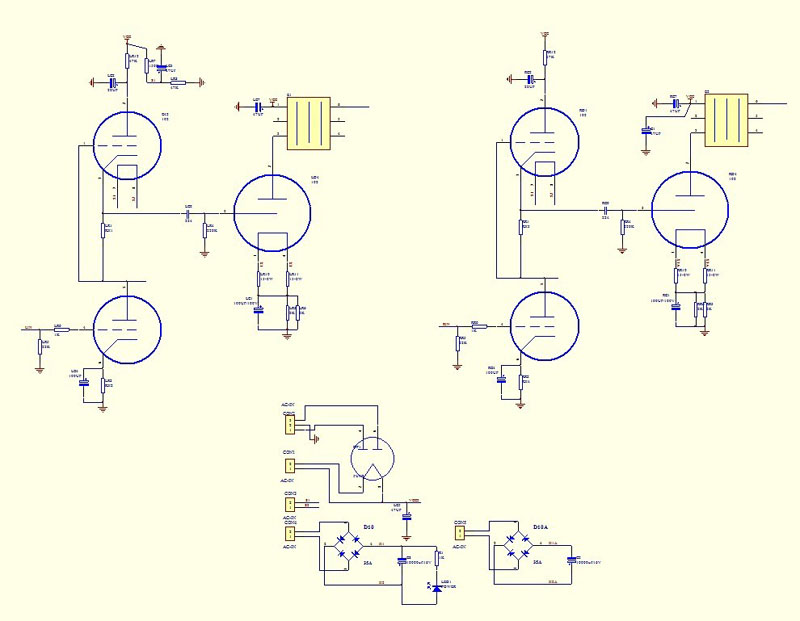

Chinese 6SN7 300B SE Amp - need help to tweak
Can anyone help tweak a 6SN7 300B SE amp from China?
The rectifier tube will be 5U4G (44 Volt drop)
VCC is 320VAC-0-320VAC (PCB just have 1 unit 47uF 500V to ground) and feed about 406VDC to circuit.
This board needs "matched pair 300B".
Can we modified this board to use with unmatched pair?

Well--There's Lots of things that could be done, but as its a PCB, there's little re-design options available other than component value changes.
There's no requirement to use matched tubes (300B) as they are Not in parallel or used in push-pull, any tiny differences between a pair of good tubes will never be noticed.
Sadly, I personally think the scheme supplied sucks,--Smacks of Chinese Cheap-n-Cheerful, prolly not a great performer, That gain-stage/SRPP seems to be the Generic one found in 90% of all Chinese amps these days, maybe the valve will be an Octal as in your case or a 9-pin, but the rest is identical to that Yaqin P-P EL84 amp I have--that I severely modded.....
I would dump the boards completely, redesign using maybe gyrator loaded input stage or Mu stage driving MOSFET Follower and Fixed-Bias 300B, none of which you can easily do/change to with a PCB that you have.
Seeing its all rather simple, a P2P would be a reasonable option, then many different things can easily be tried.... If this is a complete amplifier--at least you have all the parts/iron etc, therefore the ingredients are (Mostly) there to come up with something half tidy.
Then again--Thats just my opinion.
22K seems awfully low for input shunt resistors. Unless you're using an SS preamp, I suggest raising them to at least 100K.
Perhaps the strongest reason to use matched tube pairs in single-ended amplifiers without feedback is to equalize left/right channel gain. If your preamp has a balance control, then why worry?
Hi Mr. Alastair. Can you please provide the schematic of 5u4g 6SN7 and 300b single end?
Err--No, as I wouldn't use 6SN7 as gain-stage for 300B! The 'SN7 has theoretical max gain of around 35, so this isn't a great choice for the gain stage at all IMHO. Guess you could use it as cathode-follower, but then you still need the gain of 60 odd...
To drive the 300B to maximum, running 300V plate in fixed-bias with zero fb you would need a gain of around 60-70 at least in the preceeding gain stage, for an input sensitivity of 1V.
Add fb into the equation--you'll need more gain The SN7 just wont give it in a single stage. I guess you could use both halves in grounded cathode but then you'll have a three stage amp instead of two, with all the attendant issues that go with that......
Personally I wouldn't use 5U4G as I prefer solid-state rectification,-- Silicon used in moderation--for the jobs its best at is beneficial, only the uninitiated think its not IMHO....
My advice--Look on web for 6SL7 drive to 300B (Classic rather boring and done-to-death scheme, there's been a million done) but add MOSFET Follower driver between SL7 to the 300B to tame the miller, and bring a boring amp to life. Wire 300B for fixed bias 300-350V plate, and 55-60mA Ip, settable via MOSFET follower...
