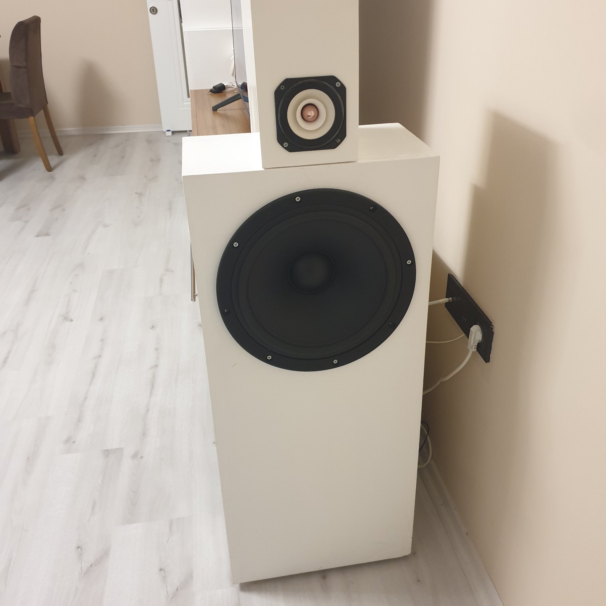

I only built birch plywood rectangular boxes(FAST in picture and I liked sound a lot). I think I can find huge surprise egg toys (30cm) and they may be suitable if I enforce inside) Regards

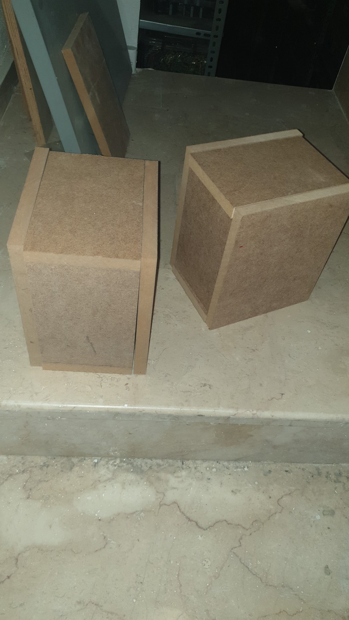

I finally cut the boards.But not glued yet. Inside dimensions 203x165x132mm and MDF thickness 19mm.
But I couldn't decide which side to put the driver,wide side or narrow side?. And which position to put the driver. As I remember 1/3 of the side is good but chstgpt tells to put driver in center of the panel

I finally completed the assembly and glued the boxes, and I’m really satisfied with the sound quality! Initially, I tested them using a Muse TA2020 amp, but the output felt a bit underwhelming in terms of power. After switching to a Quad 405 clone amplifier, the difference was remarkable—the sound became much more dynamic and impactful.
In comparison to my older Aiyama speakers, I find the bass response in this setup slightly weaker. However, it’s worth noting that the Aiyama enclosures had about 15% more internal volume. That said, since these boxes are designed to work with a woofer in a 2-way configuration, the lack of deep bass isn’t a major concern for me.
Interestingly, I’ve also planned to use these speakers in full-range mode for specific types of music, such as instrumental tracks, where imaging and clarity are more critical than bass depth. I’m excited about the versatility this setup offers—both as part of a multi-way system and as a standalone full-range solution.
