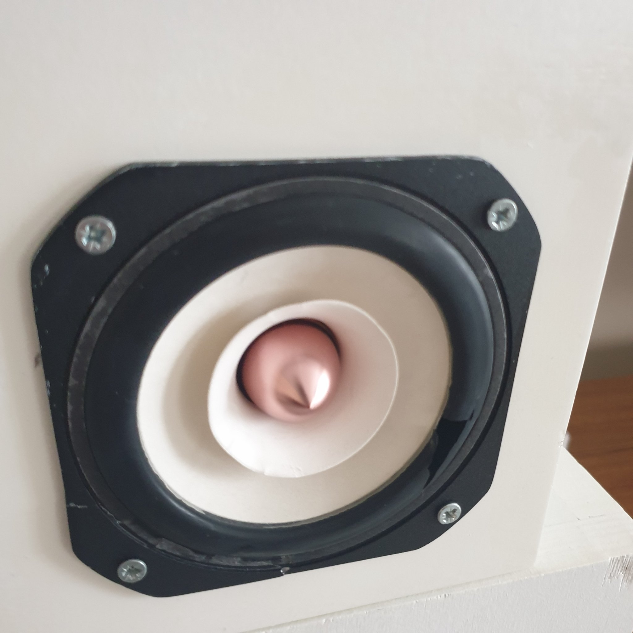

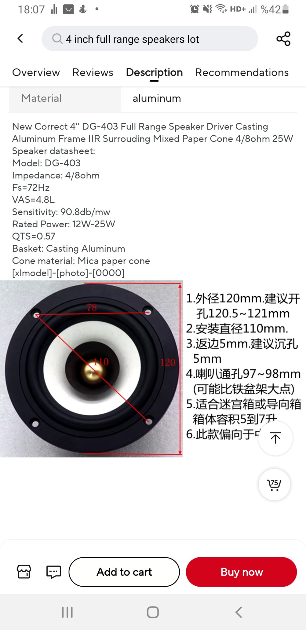

Hi. My 10 years old China Fr drivers which I like a lot ,it's rubbers worn out(last picture )and I bought different but similar drivers 8 ohm instead of 4 ohms. I will use them for my Fast setup. I think I will make 2. Order pllxo and XO frequency will be around 170hz.
I used BBC ratios for inside dimensions of box. And box sheets will be like first picture.
FS:72hz
Qts:0.57
Vas:4.8lt
İnside dimensions will be 203x165x132mm and box volume about 4.4liters( with effective of poly fiber fill it will be about 5.5 liters)
I think this design will be very good. I already have about 2 meters sheets of 203mm.So it will be easier for me.

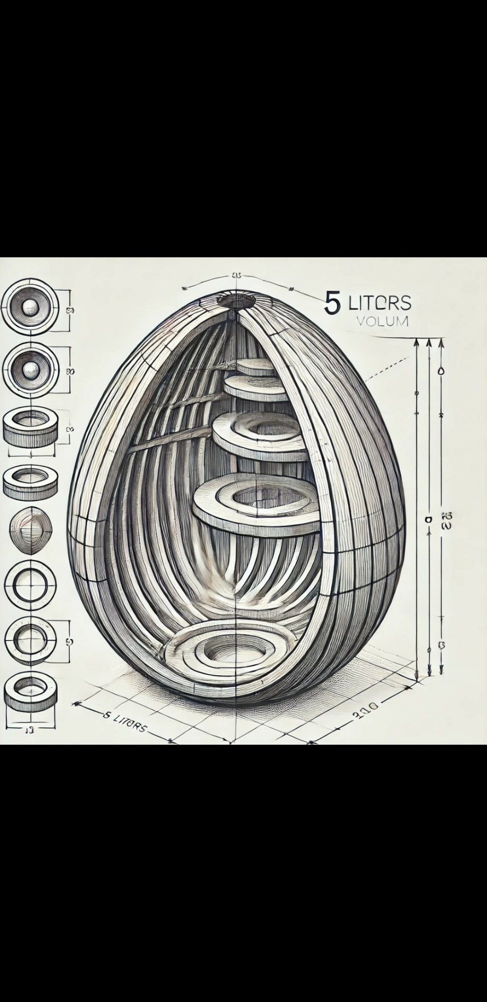

Because of I am obsessive person I want to build best enclosure as possible. I decided to build egg shape to prevent modal resonance ( I read sphere may cause it), chatgpt draw me how to make it. I do not know if anyone build a plywood egg shape sealed enclosure.

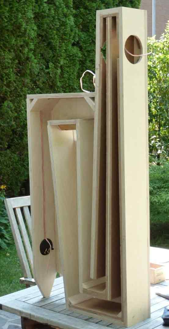

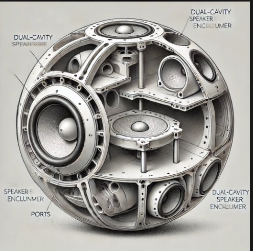

Sphere is amazing if properly tuned (double cavity inside for resonance). But they are complicated to build and take more space so are not common. Elipson did a lot in the past but customers were pro audio. A lot in fullrange. All ported i think. In china you can buy a lot of Transmission Line enclosure for 4 inch drivers using CNC for pretty cheap if you can talk in chinese. I made one for this kind of fullrange. Not perfect but pretty good already.

Teardrop. A la Hershey's Kiss, or a kind-of heart shape rotated about its central axis.
The mounting depth can vary: sunken in for a wave-guide effect, or flush.
The 'point' at the rear is intended to guide the diffracting sound waves backwards, so they don't converge onto themselves as with a sphere. To determine an 'optimal' shape would probably require simulation and testing, but I think some very nice approximate shapes could be made by hand.
As for building... How good are your artistic skills?
