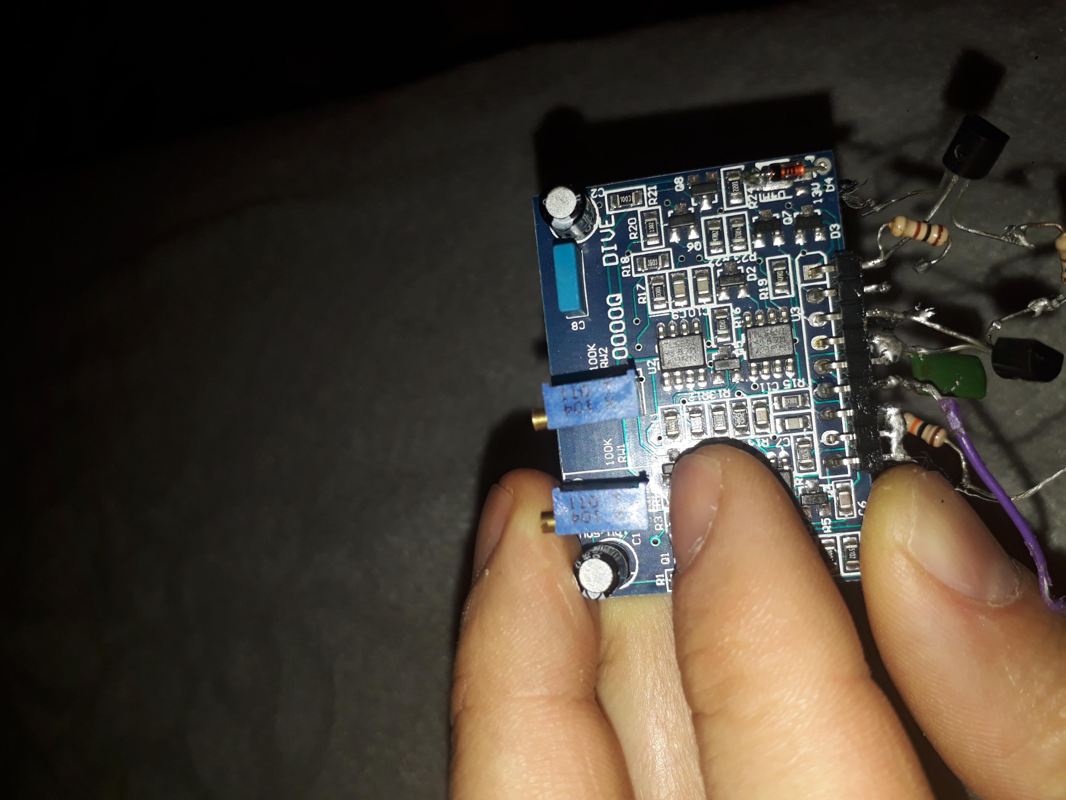

Hi does anyone know where to buy one of these little power PWM boards of FPclones? I have an FP20000q of loudfactory with many shorts coming from this module. I have tried to get the part for weeks with them and no answers from them, looks the parts is complicated to get.
I checked in the case of the original Labgruppen and their original PWM board is different 7 pins instead of 9 pins of clones and their board applies to all original FP series, I was wondering if in the case of clones can I use any PWM module from any clone brand as they all look very similar for all the FP clones as well? Or do you recommend to insist to get original board from LoudFactory? I was thinking to buy it from another brand like Sinbosen, Sanway or Skytone.
