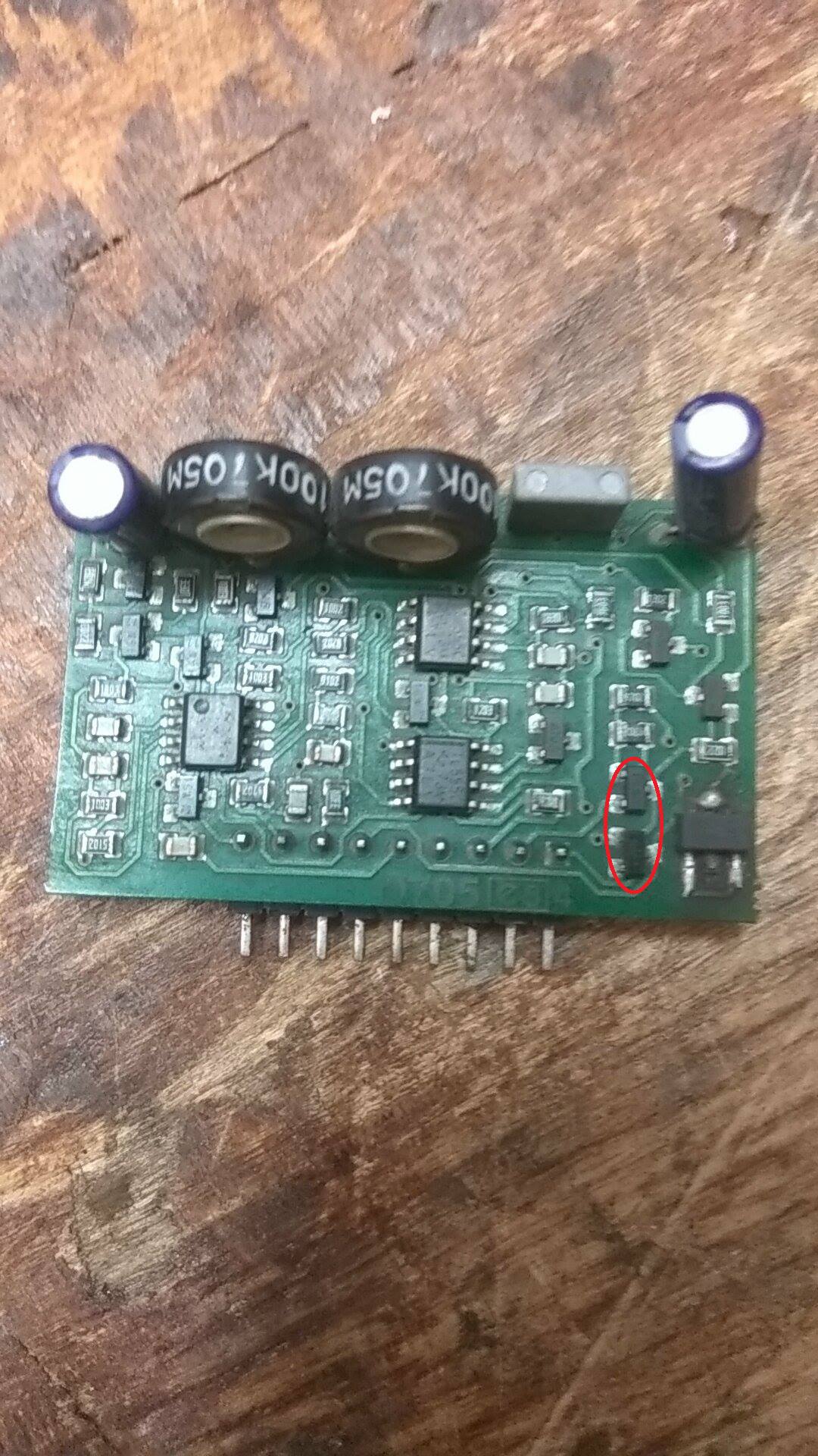

I need your helping, I have a China clone of a fp10000q works well up that moment ch01 starts clipping and doing strange thing. By looking to oszi and dummy load I saw I miss the positiv halfwave. Hmm, without schematic bad to say where's the problem.
Well without dummy load, I can see a very litte positive halfwave and if give a little more power its a triangle but only withyout load. :hypno2:
By mesering all parts on board I only fine Q22 (MPSA42) blown may be the PWM bord ist blown too or the mysterious A2601 (maybe it ist a optocopler like HCPL2601) is blown too, but I don't no.
May be anyone have a schematic of the Amp-board or the service-maual would be gread, if he sand it to me.

Ok if no one have the plan may be some one can help me without plan. Well this amp confusing me a little it's not a real pwm but also no A/B in any way.
I have measured all parts at the board but I only found one litte transistor with an error (MPSA42 Q22) and I have exchanged them but there have to be more...
Where have I to look?
Would be gread if anyboady help me...

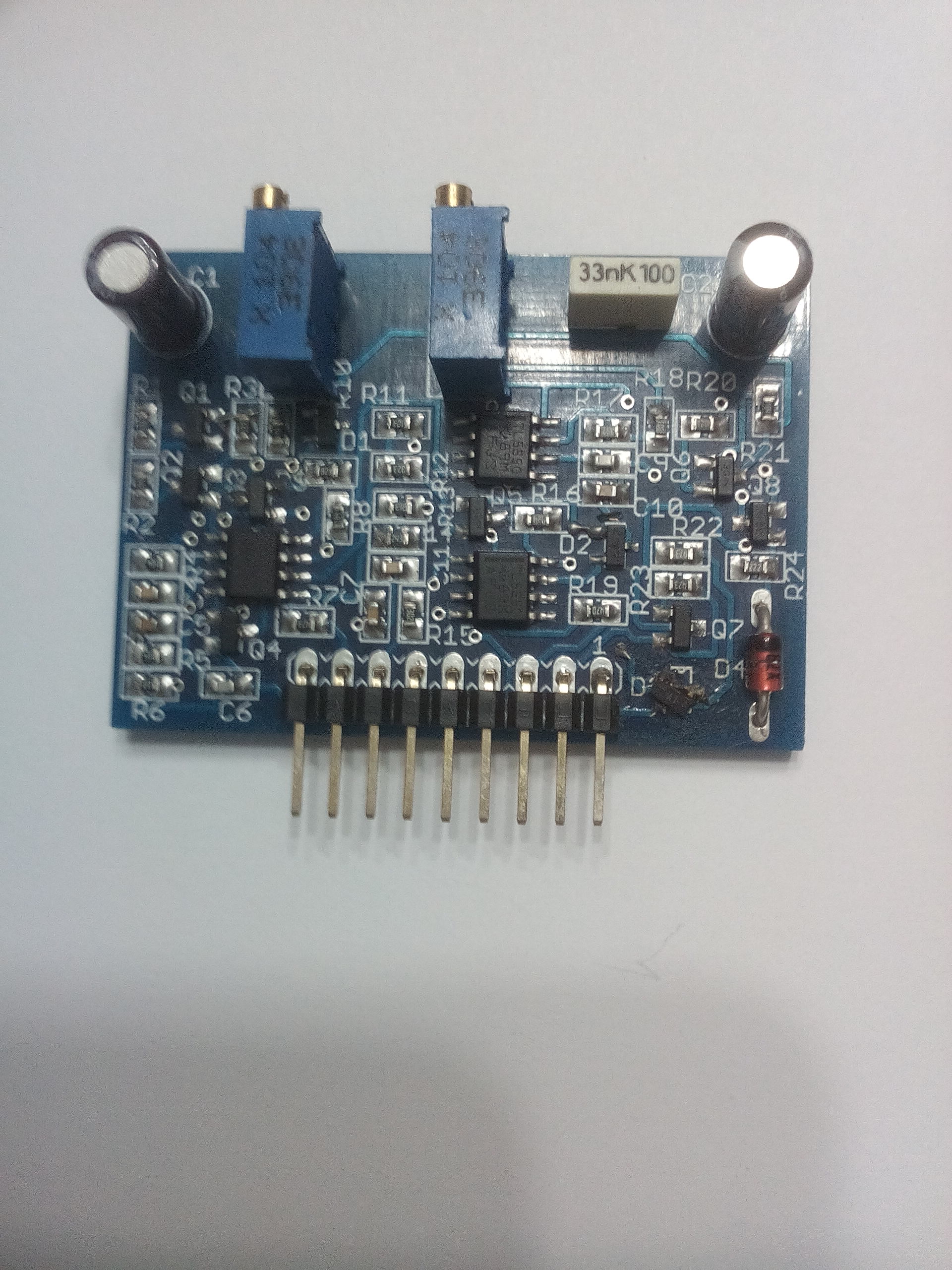

FP10000Q china clon/not LabGruppen schematics
I'm looking for preamp module of the FP10000Q china/not LabGruppen circuit diagram, schematics and circuit layout.
The original LabGruppen module is completelly different and schematics are not the same.
Anybody has this china schematics version?
Thanks in advance.
Check for interrupted paths (in the serrate at the top of the board, under the small capacitors), resistors (especially in the Bushero chain). The 15V zener diodes. All elements of radiators.. You must have +/- 11V on the radiators of the end transistors.

Good morning, fellow technicians, could you please tell me if the module you published is the module of this FP10000Q clone and if you have more information, for example, that the three integrated circuits are registered to try to make the diagram, thank you very much for your attention.
Buenos dias compañeros tecnicos por favor me podrian decir si el modulo que publican es el modulo de este clon FP10000Q y si tienen mas informacion por ejemplo que matriculas son los tres circuitos integrados para tratar de hacer el diagramita muchas gracias por su atencion.View attachment FUENTE FP10000Q-POWER CHINO.pdf
