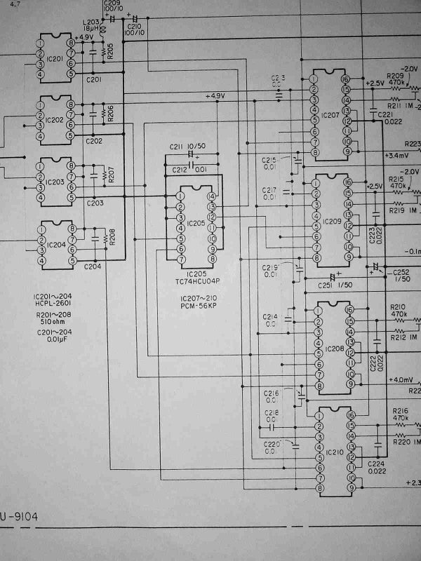

How does the serial inverter/adder know, at the moment it sees the LSB, what the following bits will be so, if necessary, the invert/adder can replace the maximum negative integer with the maximum positive integer?
this is done by DENON DAP-5500. They know what they do ...
Regards
Jobstens

Re Point 2. Where does the inverted data come from?
The basic circuit is an inverter followed by a two-input serial adder with one input tied high. A loadable,bidirectional,parallel in,serial in,serial out shift register does the bit reversal.The D inputs on the shift register are tied to the max positive value. The Load input is asserted by a circuit that detects the max negative value.

Originally posted by rfbrw The basic circuit is an inverter followed by a two-input serial adder with one input tied high. A loadable,bidirectional,parallel in,serial in,serial out shift register does the bit reversal.The D inputs on the shift register are tied to the max positive value. The Load input is asserted by a circuit that detects the max negative value.
If the serial adder has one input tied high, it will add one to every bit. That’s not right. You add one to the LSB, only, and add the carry to the following bit. And what’s the advantage of the serial circuit? It seems you still need to hold the entire sample in a register so you can compare it to the maximum negative integer, replace it if necessary, and then shift the data out backwards into the DAC. Using a bi-directional shift register is cute but it makes the circuit difficult to pipe-line.
If you work at it, you might be able to come up with a usable circuit. I prefer the parallel approach: End of discussion.
