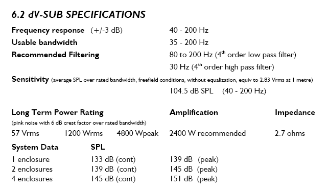

That sounds like the best combination for maybe creating a totally frightening experience. I had such a sensation like the vibes were scaring my very soul when I stood before the L-Acoustics dV-SUB array doing the lows for dV-DOSC at an old Massive Attack gig. Still, even that system is quoted 40Hz -3dB and recommended to be 4th order limited at 30Hz. The known ''chest surface'' hit sensation is really high there, everybody who tweaked EQ during setting the drummer on sound check FOH position knows that. Looks like having SPL at the very lows too and an infra bass band like Massive is of much more effect indeed. Cavity+surface=scary, but not met and fed through that often. As for trousers flapping, can't tell, I have to go to a big gig wearing a bell bottoms Elvis suit and report back.🙂
Plus, the dv-Sub is an inherently cardioid design, so you can get those levels within that freq band without killing the monitor guy. 😀
