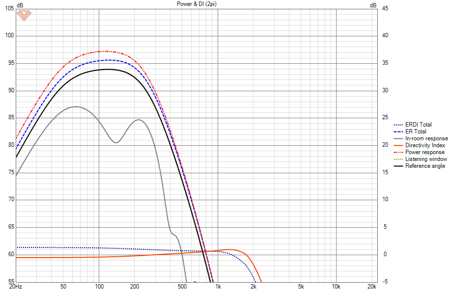

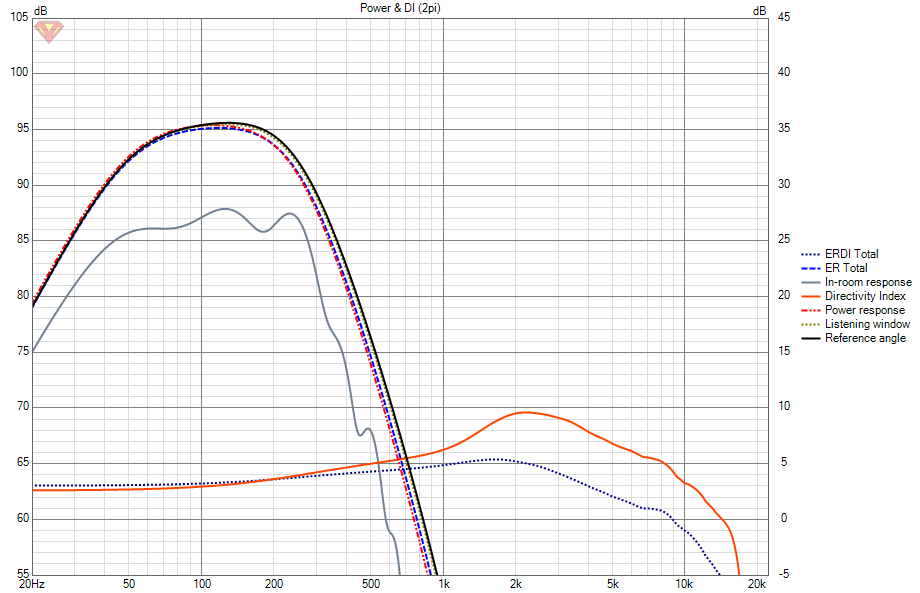

I'm guessing placement could have a large influence on the speaker's abillity to impress with kick.
A very quick and dirty test with Vituixcad with one 12" placed on floor, 60 cm from back wall:
60 cm worked out best to get an even response when listened to at ~2.5 meter. Ideally it helps to be able to play with this in your room.
and compared to using the same distance from back wall but this time mounting the 12" close to the ceiling:
For kick drum, I'd want to have 60 to 250 Hz right and even. My solution would be to have multiple 12" boxes at various positions and heights to even out the dips caused by reflections. Imaging isn't important here, so just use multiple sources to even out the low end? EQ to taste...
You can use smaller speakers for the top end (250 Hz+) and hang those high.
If you also want flapping pants you'd need to get more output below 60 Hz and a different taste in music 😀.
