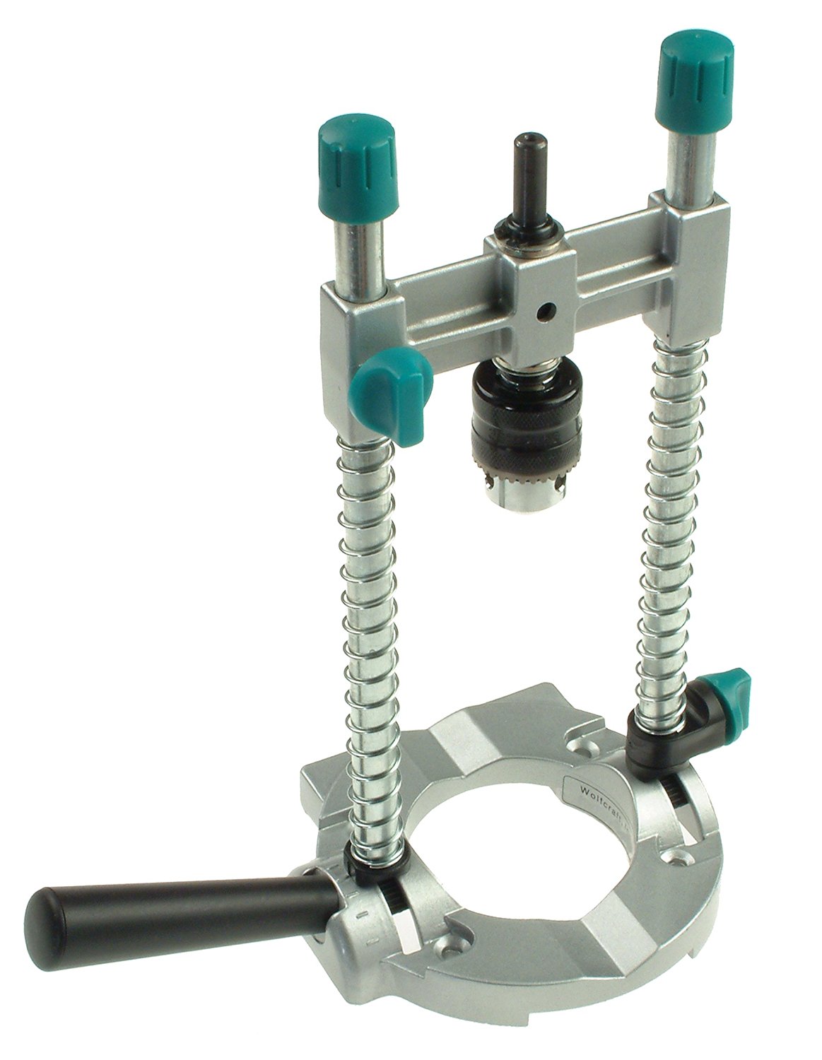

I bought a similar one for my little drill.Ok, I know they're probably rubbish, got to be for the price, but I only want to drill a few holes in aluminium, steel occasionally. I've had enough of doing it "freehand" and making a bit of a mess. Has anyone used any of this junk or can recommend something (slightly) better. This is the kind of toy I mean

But while I had it I looked at the down travel.
That black strip on the right is all that tries to hold the down stroke on a true "down" and not allow it to wobble sideways.
It was terrible. If I had any carbide drills they would break at first attempt.
Small HSS drills would either bend, or break depending on how they were made.
I see the Clarke stand in post25 has a similar strip but on the left side. I suspect it will have the same sideways wobble.
Ah, yes I see now, looking closely, I thought it was just a depth gauge. Thanks. There is a similar one on the Clarke that I mentioned, but that does look like and is called a depth gauge. That could be the better cheap option
I bought the Clarke stand, it did what I wanted, just! It is what it is (cheep!) Not a piece of precision equipment but for what I needed to do it sufficed if used gently. Definitely much better than freehand. I had to make sure I kept a little lateral bias on it otherwise the drill would wander slightly.

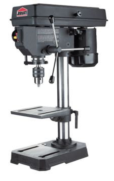

get a £30 drill press from ebay, simples.

Fell over this thread while looking for something else. I've been using this, which once bolted to a decent platform, is pretty good. Solid, accurate enough for drilling front and rear panels. Importantly, relatively cheap so that if/when I decide I've got the money and space for the real thing I won't feel to bad about having purchased it.
I am quite happy with WABECO Bohrstander Frasstander BF1242 Made in Germany - Wabeco . I bought it used from eBay Kleinanzeigen | Kostenlos. Einfach. Lokal. Anzeigen gratis inserieren mit eBay Kleinanzeigen with a good discount. For new I would have picked the 750mm or the 1000mm vertical pole, very convenient.
I bought this one a couple years ago. And I really can recommend this one. Ideal for hobby work.
