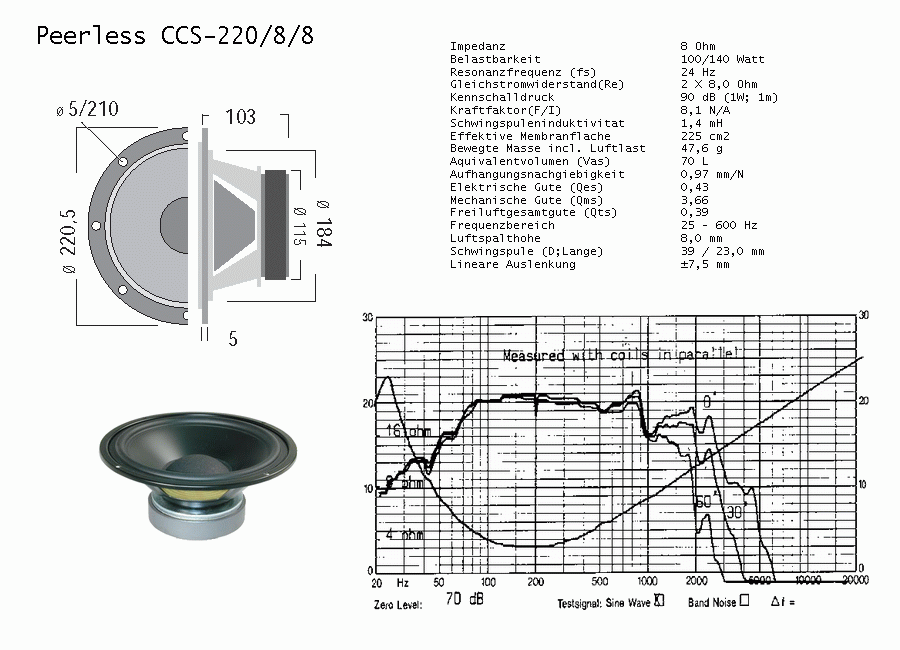

how much did you enter for Re of one woofer (coils in parallel) when simulating vented enclosure? According to datasheet Re=4, yet it says Zmin=3.2 at 159Hz. Normally Re is lower than that.

I used Re=4, but have always been suspicious of the number. I've attached another data sheet where the TS parameters are based on an individual coil at 8 ohms, and says 2 at 8. Since consistent with the 4 with 2 in parallel, I went with it. The driver has been out of production for maybe 20 years. I bought them as NOS 8 or 10 years ago after blowing out the original DVC 8/8 drivers (another brand). It was a well regarded driver back then, and cheap, but very little information available. I have considered replacing them as well, but this rebuild has gotten a bit pricy.

Re=4 is very likely a typo. Peerless was always a well respected brand name, and their practice of producing nominally 8 ohm units had Re in the 6R range.

Not sure about the typo, but I agree it doesn't look right. I would have expected something in the 3.1 range. Could roll the dice, and just go that way, based on that min Z and the rest of the IMP curve. Spent many hours looking for more information on that driver, hoping to find somebody that had actual measurements. But this is a "vintage" driver, and nobody was doing that back then, and internet was still young. I'm more concerned about the correctness of the crossover than the box. I can't do much about the existing box, other than reducing the volume (wrong direction) or messing with the port lengths.

Regarding the Peerless Re: I don't know why it didn't dawn on me until yesterday, but that is one spec I can check with a simple multimeter. I'm going to pull one or two of them and do that.

FYI, Peerless woofer DCR measured 5.0 ohm single coil, and 2.5 ohm both coils in parallel.
