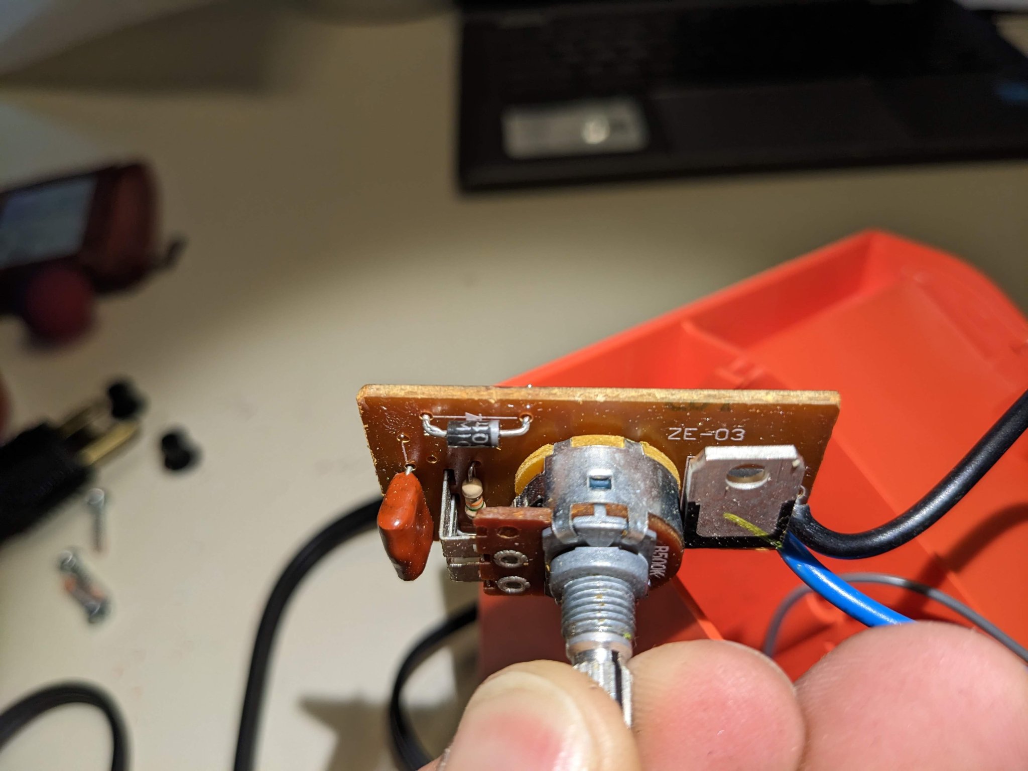

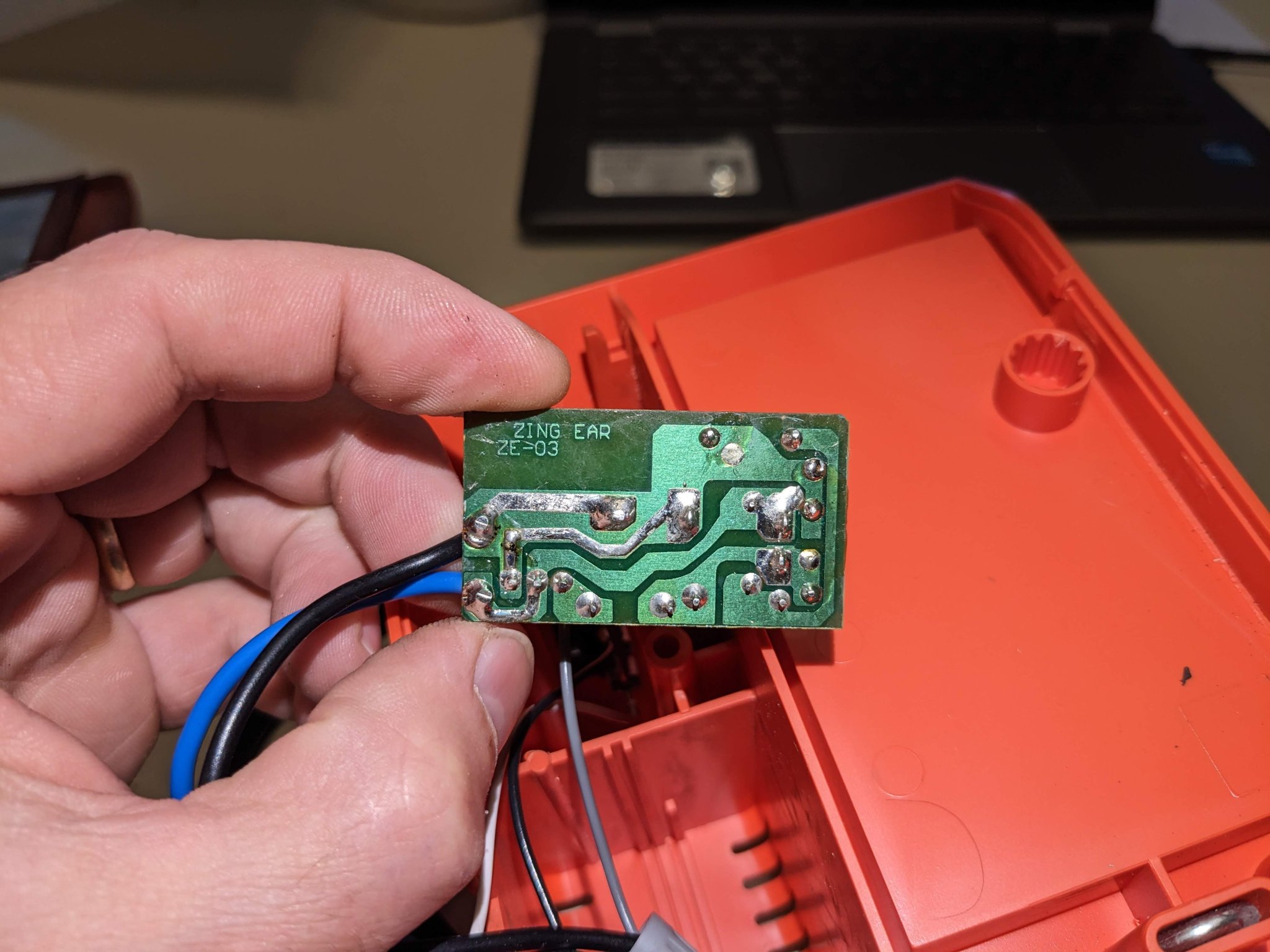

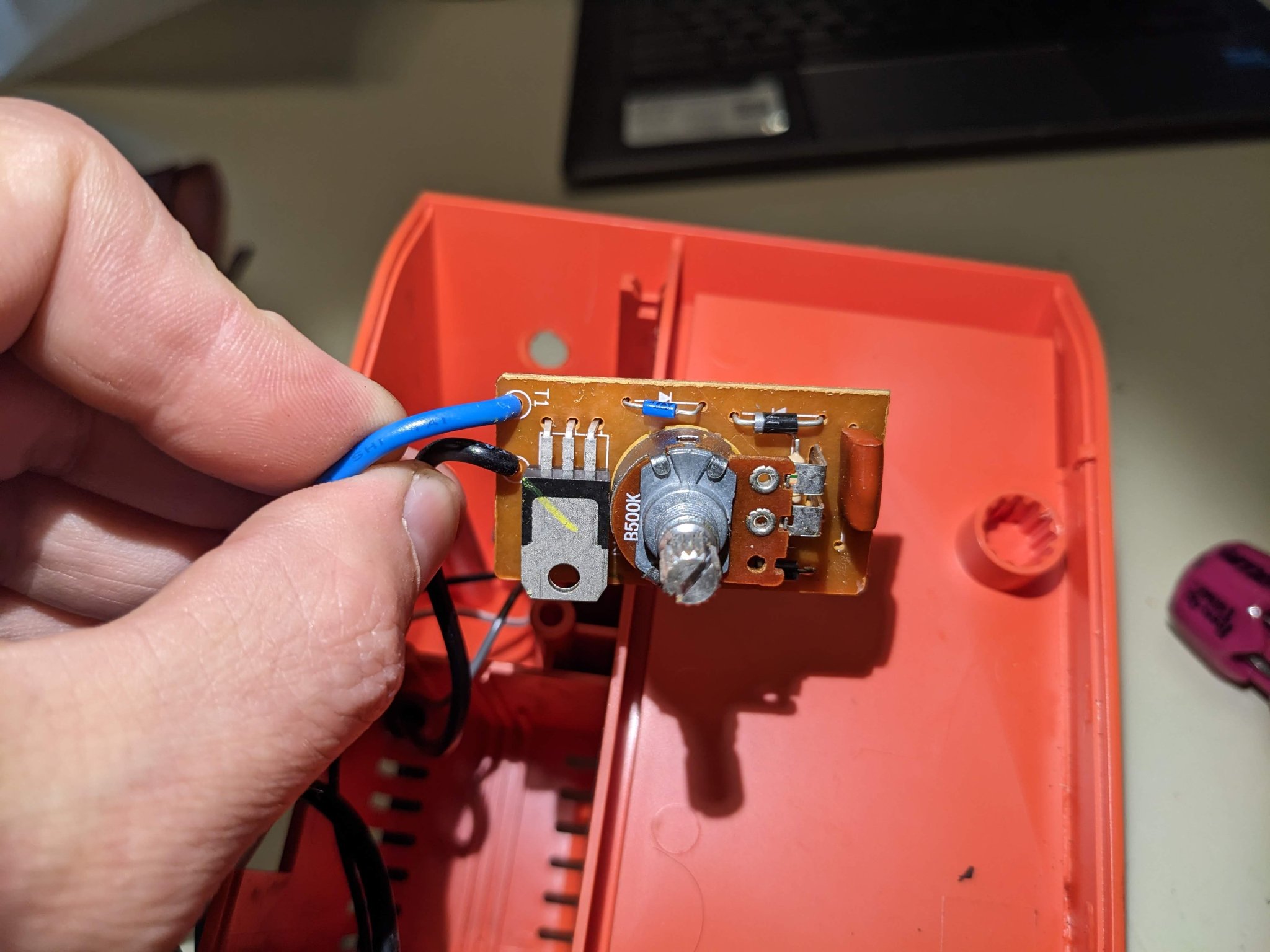

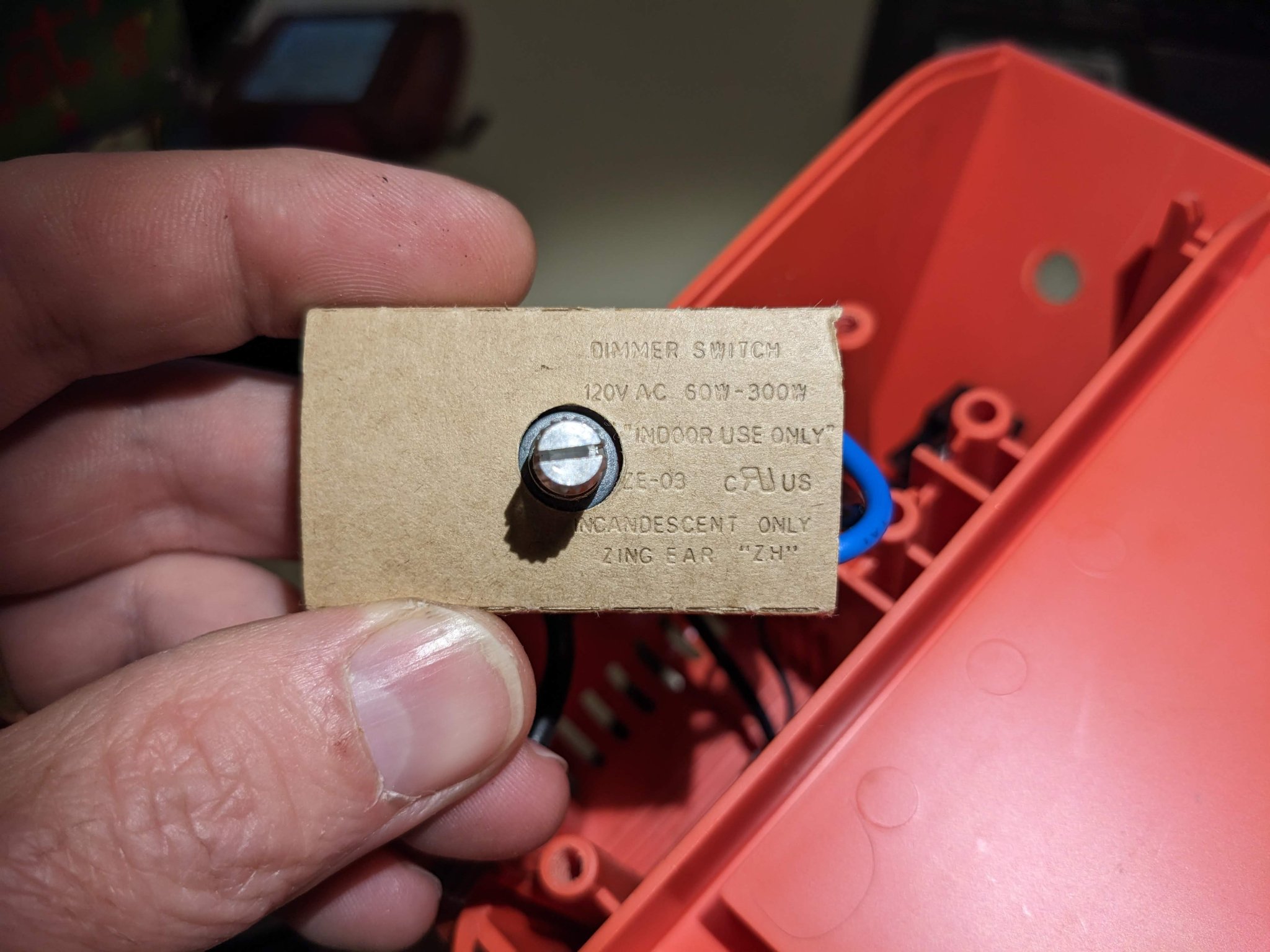

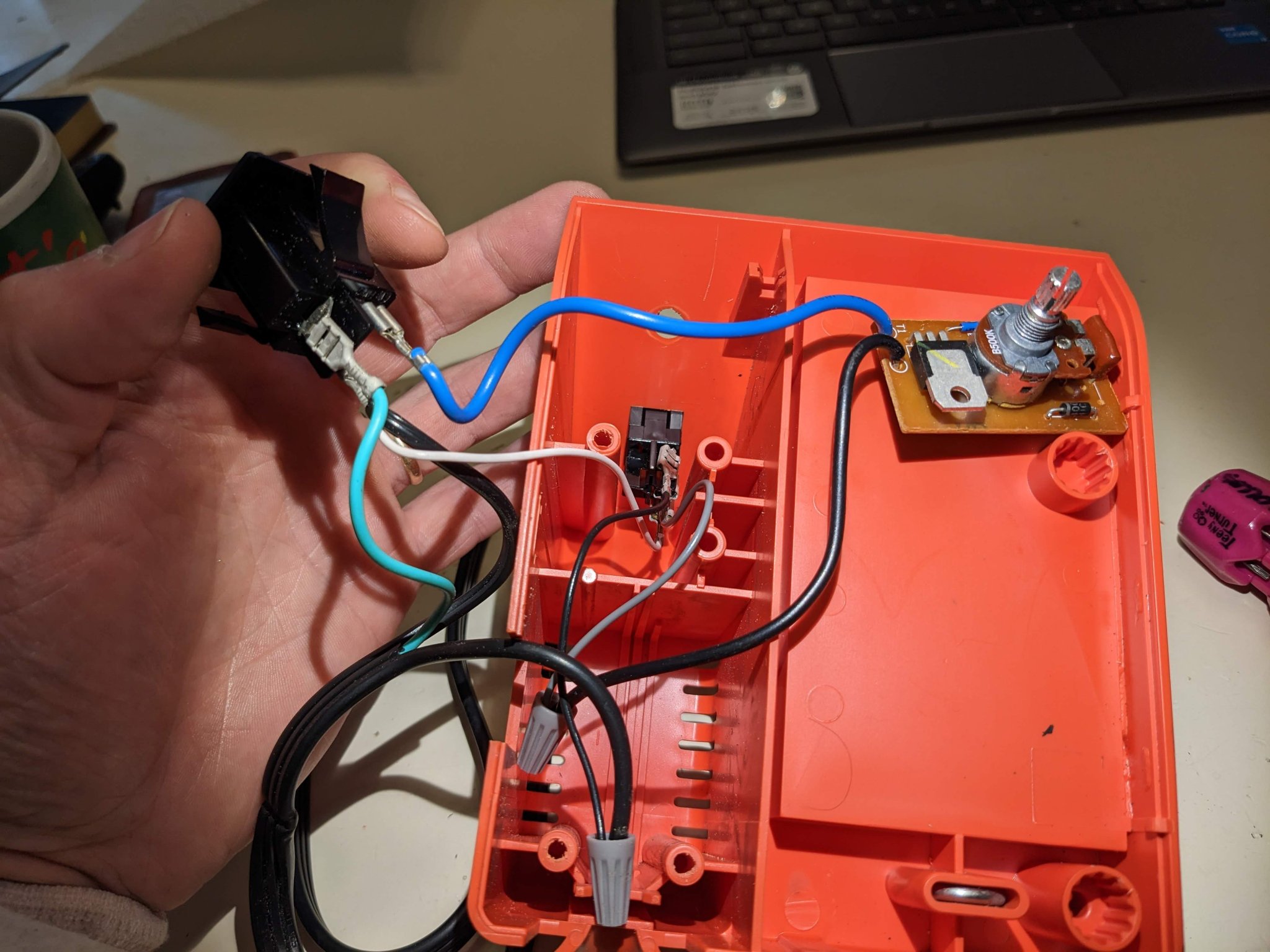

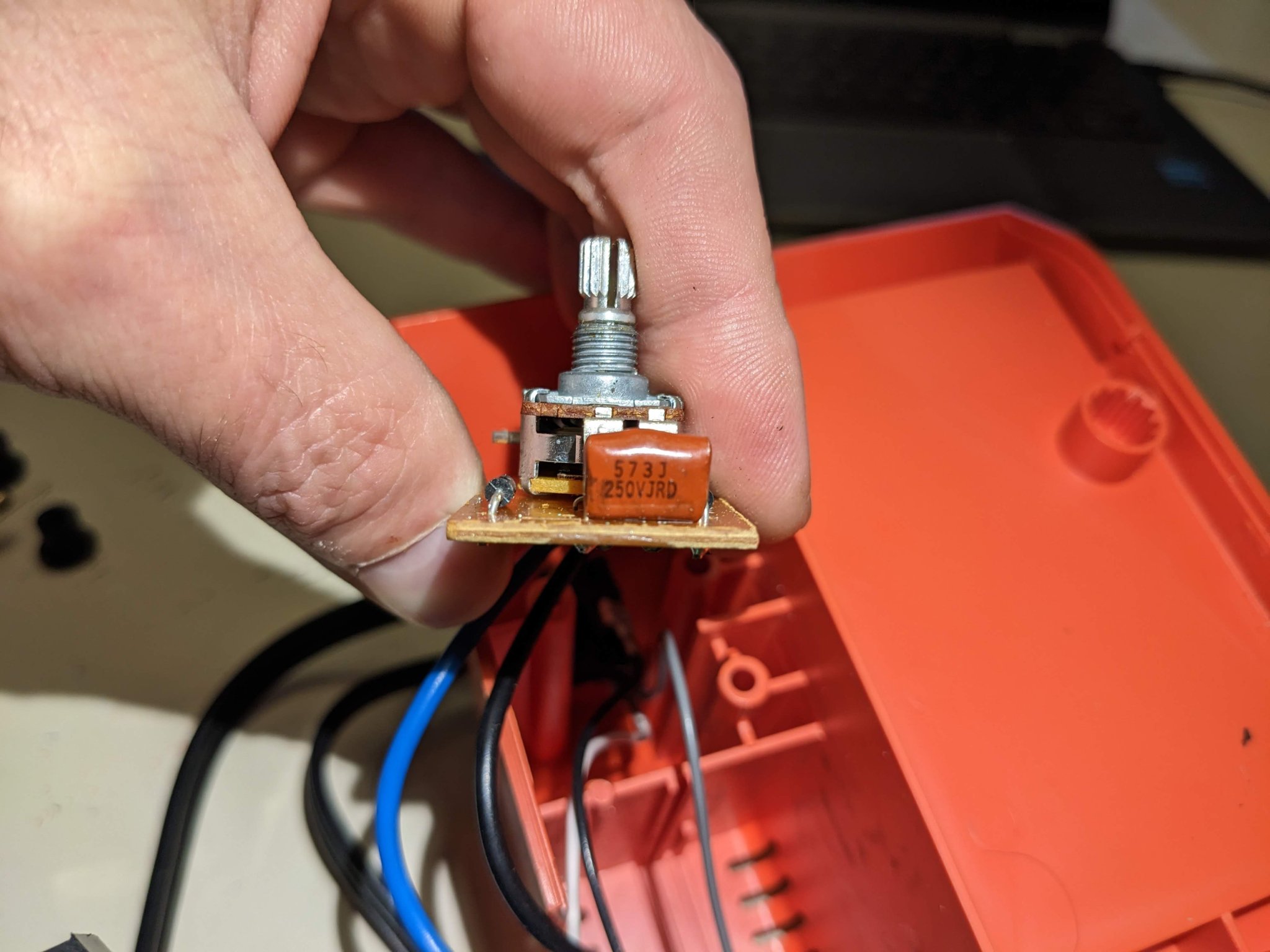

Well, for anyone interested, the soldering station appears to be a simple lighted on-off switch and a "Zing Ear ZE-03 rotary lamp dimmer switch" which seems to be a commodity part.
The mains ground connects to the mains ground terminal on the side outlet only.
The mains neutral is connected to the side outlet neutral terminal and the lighted on-off switch, I assume that's for the light?
The mains live is connected to the lighted on-off switch, then to the lamp dimmer, which is then connected to the side outlet live terminal.
I took pictures of the dimmer, but I didn't try to draw it out.
The tips simply sit inside the barrel, I didn't try to take the iron apart.

So this is actually not exactly a soldering station, but just temperature regulator thing, which has no knowledge about real tip temperature. No thermal sensor . If mains wire ground is connected to outlet socket ground , then all should be fine , soldering iron is grounded , offcourse if your mains socket and power extension cable all are grounded . As i understand, you can connect any regular soldering iron to this regulator. I'm using simplified version of dimmer ,just 1n4007 diode , and additional socket for soldering tip connection, also in socket is small switch to short diode , when higher power is needed .
