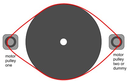

Is there any advantage in 2 pulley configuration when compared to the single pulley configuration ? (Please see the attached image)
Will it help to increase the rotational stability of the platter ? Will it help to increase the platter weight ?

binspaul said:Is there any advantage in 2 pulley configuration when compared to the single pulley configuration?
No, it just means you have two noise sources. 😀
No side-loading on the platter bearing.
As well as the added noise that EC8010 mentions, some have mentioned increased belt slippage, since the belt has much less contact with the platter.

multiple motors...
can be a godsend.
If the platter is light in mass, then multiple motors can provide the Inertia required to keep a light mass moving smoothly. Voyd and AudioNote are two that come to mind (the Voyd became the AudioNote "reference" TT.
An assumption is made of course, that the motors are well isolated from the platter and bearing and the transmission of vibes is minimal. I've seen TT's (on the Internet only) that use a single motor and 2 additional (idler" pulleys apparently trying to do the same thing.
As old Aengus said, if multiple motors are used it can help to offset some of the torque (lateral) to the stylus cantilever.

The advantage of two (or more) motors is that, effectively, the apparent rotational mass of the platter is increased and belt tension on the main bearing is equalised (depending on specific implementation. It may also be that cogging effects are disguised (not eliminated). However, there are also a number of potential issues.
1/ There is now twice as much motor noise to contend with.
2/ There is twice as much electrical noise to deal with.
3/ To work ideally both motors must rotate at exactly the correct speed and both drive pulley must be exactly the same size..
4/ The tension of the belt will be even more pronounced in line with the drive pulleys compared to an angle of ninety degree offset and this may have a significant impact upon the dynamic of the suspension (if one is used).
5/ If a DC motor is used the problems relating to operating near the lower limit of its operating speed (poor speed/torque tracking) may be reduced but the problem is really being disguised rather than eliminated.
