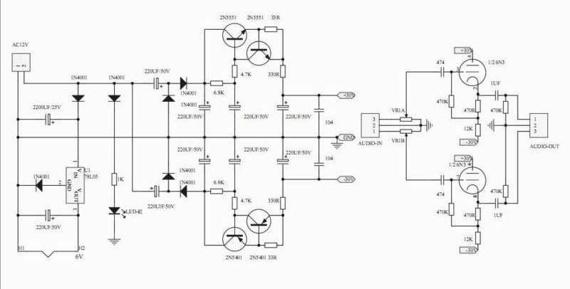

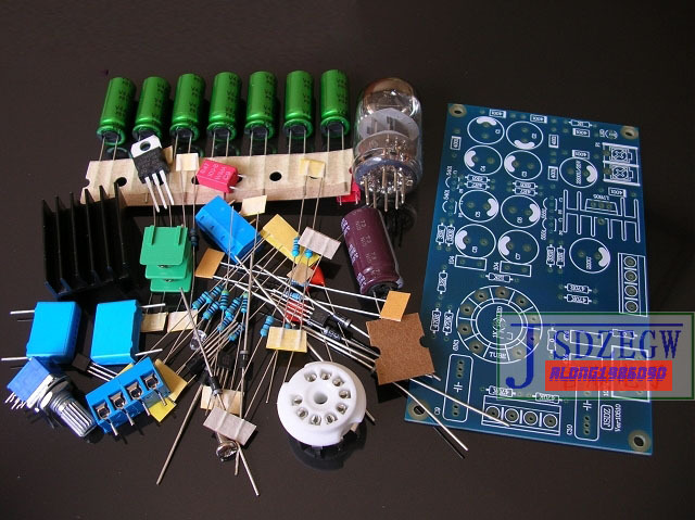

As a new-comer to DIY audio endeavors, I am trying to gauge whether or not it's worth purchasing any of the cheap Chinese kits that can be found on auction sites. I have attached a schematic and a couple of pictures from a listing found here, which is particularly cheap. Is this item worth the effort as a foray into tube buffers or will I simply be building something that's as good as useless in a decent system? I'm not hugely interested in starting right at the hi-end and will enjoy a journey of building and improving.... however I certainly don't want to start of with items that I will find useless in 6 months time.

It looks fairly simple. I don't know why you want it, or what function it would be intended to perform. Looks like separate input gain controls for each channel, then a cathode follower will a bit less than unity gain to the output.
Frankly, I'd just replace the entire thing with just the two gain controls. And building such a circuit from scratch (not a kit) is almost a trivial exercise, either what you have shown or what I have suggested.
The aikido was one I was looking at, knowing that it gets rave reviews and many fans... I guess I was wanting to have a play around at a lower cost to start with, but like I mentioned, I'm not interested in rubbish...
Might just save up and go with something decent like the aikido.

There aren't all that many complete kits out there with decent parts and instructions. By that I mean something similar to the Heathkits of yore.....all the parts, great instructions, chassis, faceplate, knobs, electrical cord, fuse,...the works. Most 'kits' these days leave the most difficult parts completely up to the builder - stuffing a board is really quite easy and fast.
If you want a tube project perhaps something from Bottlehead would be a good intro..though in a totally different price range, at least it would have resale value if you did reasonable job on the build.

PS: Stay away from the Chinese EL34 SE amp kit unless you want to do a fair bit of 'independent building' (throwing the instructions in the garbage...cutting...filing..)
Would you like to add a little noise and distortion to your music? If so, buy the kit.
By the way, it is astonishing how much circuitry they have used so that they can get away with using a cheap 12V transformer: back to back voltage doublers and amplified capacitors for the fairly low HT, and a separate regulator for the heaters (presumably to keep diode switching noise at bay). Maybe all this circuitry is intended to impress the unwary?
The comments on this schematic confirm my suspicions, though as a learner in a field, I'll always ask for help for fear of passing over something through assumption. While I knew that this kit was never going to be something great, I guess I was hoping it would be worth the $25.... but if it does nothing positive to the sound then forget it.
