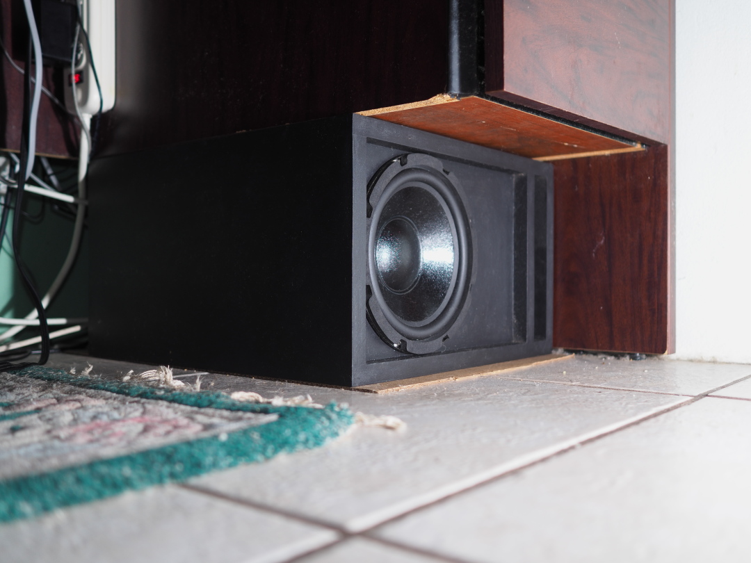

One thing going for a DCS205-based arrangement is that the driver's parameters are almost perfect for an Extended Bass Shelf (EBS) or MLTL design that's tuned anyway from 32 Hz upwards. The slightly downward sloping response can end up being a great match for a subwoofer used in a corner, under a desk, etc. The box requirements also end up being large enough so you can actually get a decent-sized vent in there to achieve the required resonance frequency. And it's a 4 ohm driver, so it's a good match for those small class D amps that produce a lot more power into a 4 ohm load. Similar 8" drivers that have t/s parameters that call for smaller boxes can pose a challenge when it's time to tune them to the desired resonance frequency using a vent that's both large enough to reduce compression effects and long enough to achieve the target resonance.
I'm quite happy with my "Boom Unit" build, and this is from someone who can be very critical about his own builds, LOL. It's also an easy build, and this is coming from a pretty horrible carpenter.
Note: the "Boom Unit" was also designed to fit exactly under the drawers in my desk, thereby removing another location for dust-bunnies to collect 🙂
Thanks Brian, both for your feedback on the Boom Unit and the Dayton DCS205, but also for your MLTL design spreadsheet.
I've been playing around with the dimensions to try to make it an easier build with some particle board shelves that I salvaged, including a roughly square baffle so that the top, bottom, and the two inside boards are the same as the stock width of the two sides.
I'll try to post some screenshots from the spreadsheet and Hornresp when I get a chance.
Thanks again, Brian. Anyone else want to speak up for one of these other designs? Otherwise I'll go with the Boom Unit by default (possibly modified in some dimensions).
