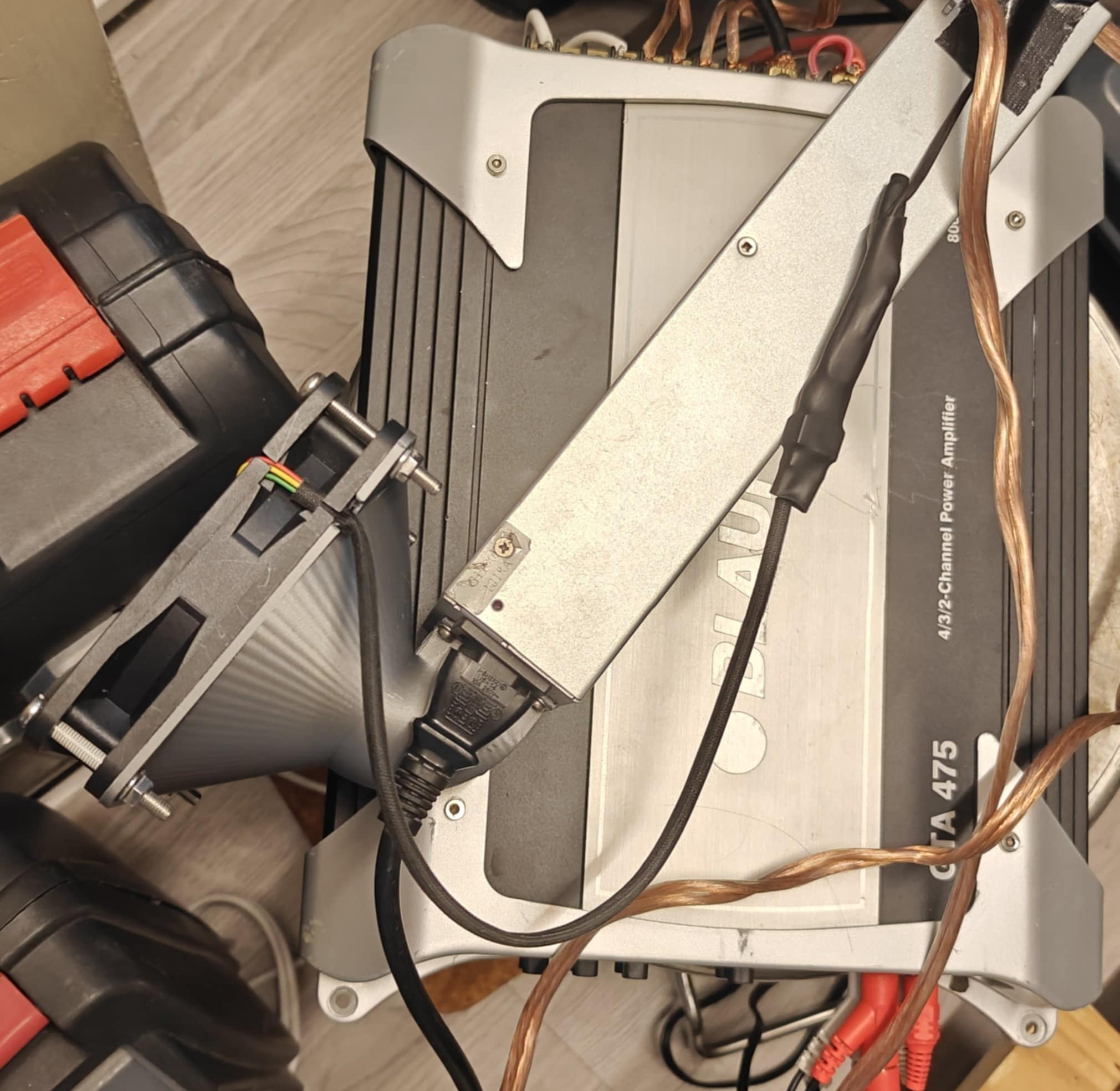

I may have found another solution... Turns out I have another car power amp that I had forgotten all about, a four channel Planet Audio with a built-in active crossover, where I can bridge two channels for the sub. With an Antminer 1600W psu (that should be around 130 amps in 12V), which I can pick up for cheap, that one should be easy to drive from the line out on the receiver. I will try that first and see what happens.
Yep, we have a winner. 😀 A small mod for the PSU was needed, the Antminer had a 40 mm fan that was louder than the music... But I got 3D-printed an adapter to a 120 mm fan (the grey thing in the lower left of the pic), and that's not audible in the technical room, same level as the quiet fans on the server. The Planet Audio was no good, it started smelling burnt electronics, and I don't want that in my house, so I replaced it with a Blaupunkt. I have been running the systm with my Atrium speakers and 10" sub rather heavily for a couple of days as a test, and the PSU is cloder than the rest of the room with that fan, and the amp never gets more than luke warm. It will all be ready for the party on the 17th of may (Norway's national day)! Very much a Gyro Gearloose (old school Disney inventor, created by Carl Barks) solution, which in may ways is my trademark!
