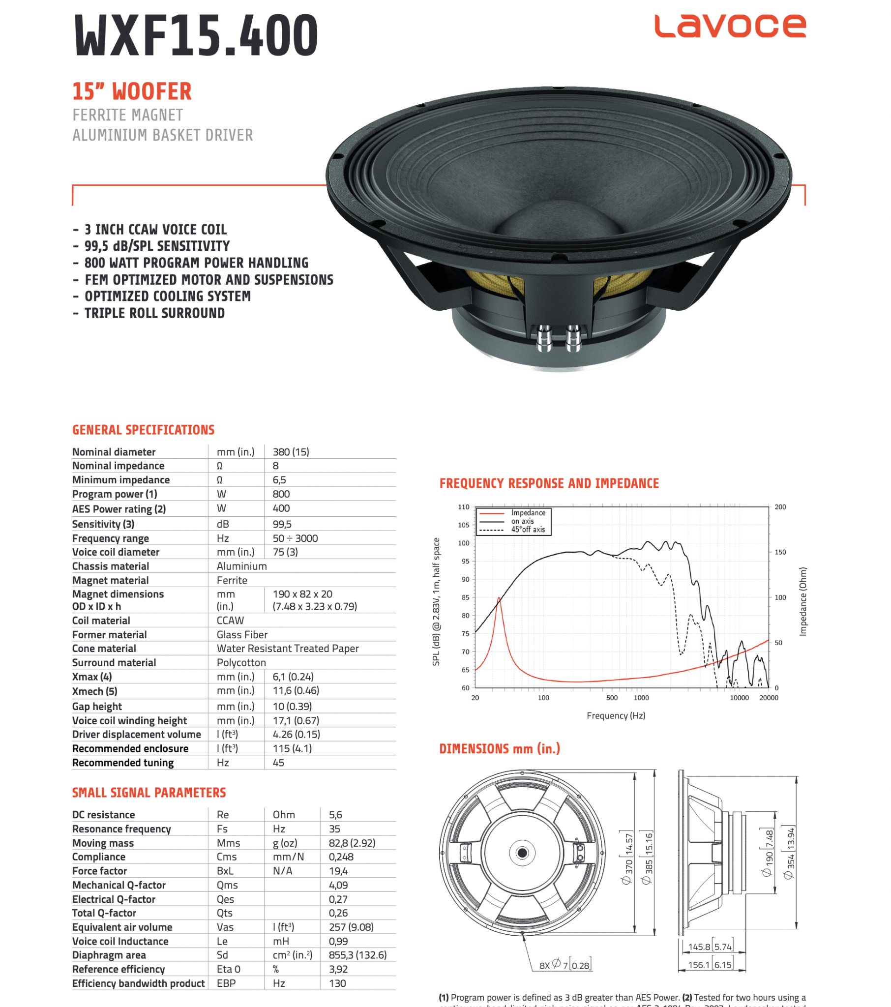

2. Buying plywood tomorrow, going with the manufacturer recommended enclosure Vb and Fb, it actually looks fairly close to the 'vintage sound' spec, the port resonance seems a little easier to manage, and the enclosures will be a little smaller/slightly more portable. Also going with two 4" ports

OK, HR 'says' vents are 10.2 cm/4" long with a 'good enough' ~21 m/sec @ 120 W, > 110 dB from ~35 Hz - up/2 pi, so more if up against a wall or especially if hard in a corner.

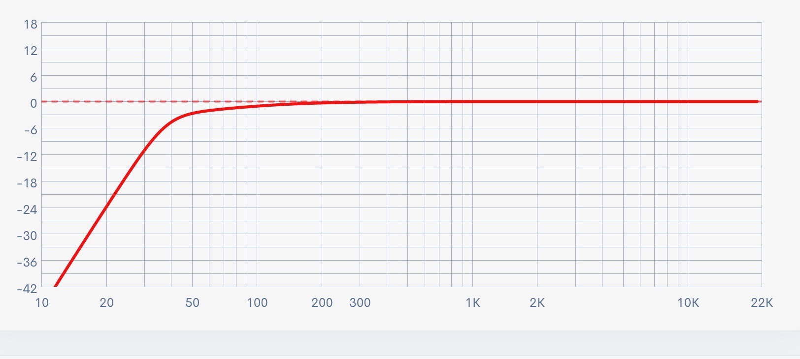

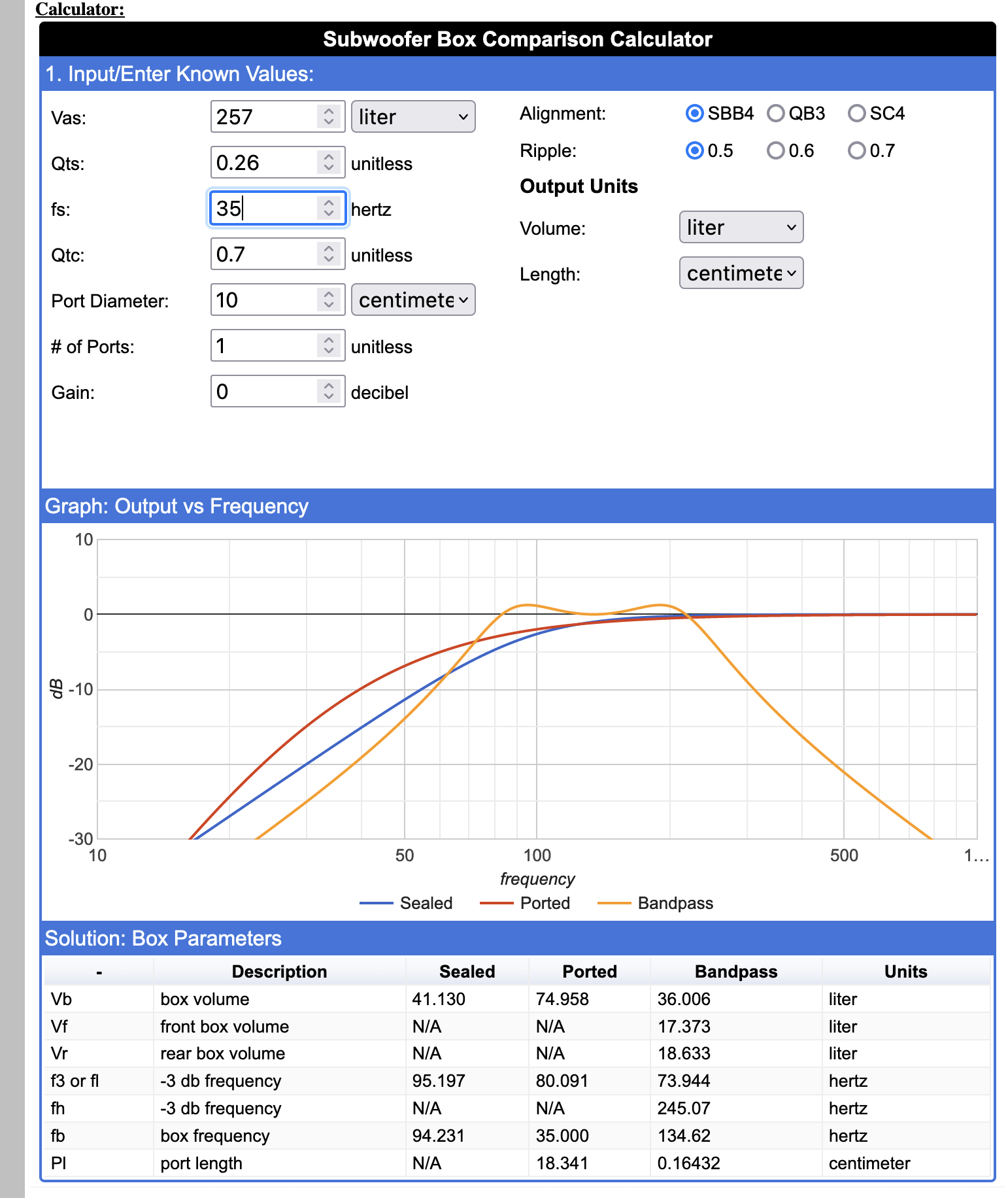

Why is Vas/sqrt(2) the Vintage Sound ?Yes, nowadays they're far more interested in small boxes at the expense of high efficiency. If wanting a vintage sound, then Vb = Vas/1.44, Fb = Fs.
Well, the technical reason is:
Pg. 76: https://archive.org/details/HowToBuildSpeakerEnclosuresByAlexixBadmaieffDonDavis/page/n75/mode/2up
“A nagging question in the design stage of any enclosure of this type is "How large shall it be?” It was pointed out earlier that the enclosure can be too large or too small for proper bass-reflex action. This implies that an optimum volume exists and indeed it does. This optimum volume does not depend upon the size of the speaker nor its resonant frequency per se but rather on the ratio of enclosure air stiffness to the speaker cone suspension stiffness. This optimum ratio is 1.44 or, looking at it another way, the speaker resonant frequency in the enclosure before porting should be 1.56 times the free-air resonance of the speaker. This size enclosure, when properly tuned, yields at the same time the most extended low-frequency response and a transient response with subjectively unnoticeable hangover, assuming sufficient damping exists. Compared to the entirely closed cabinet, the half-power point (3 db down) occurs at 0.7 times the closed cabinet speaker resonance for an extension of one-half octave."
