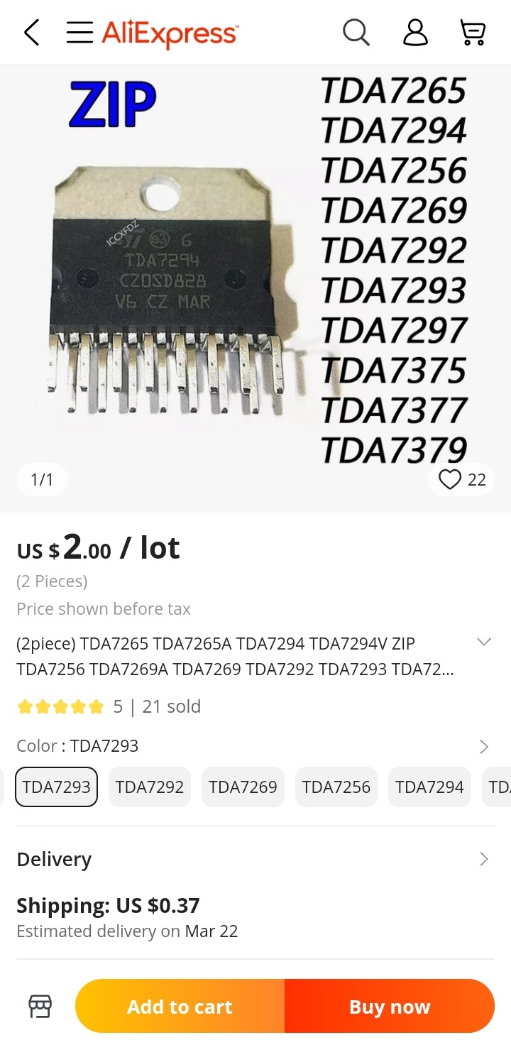

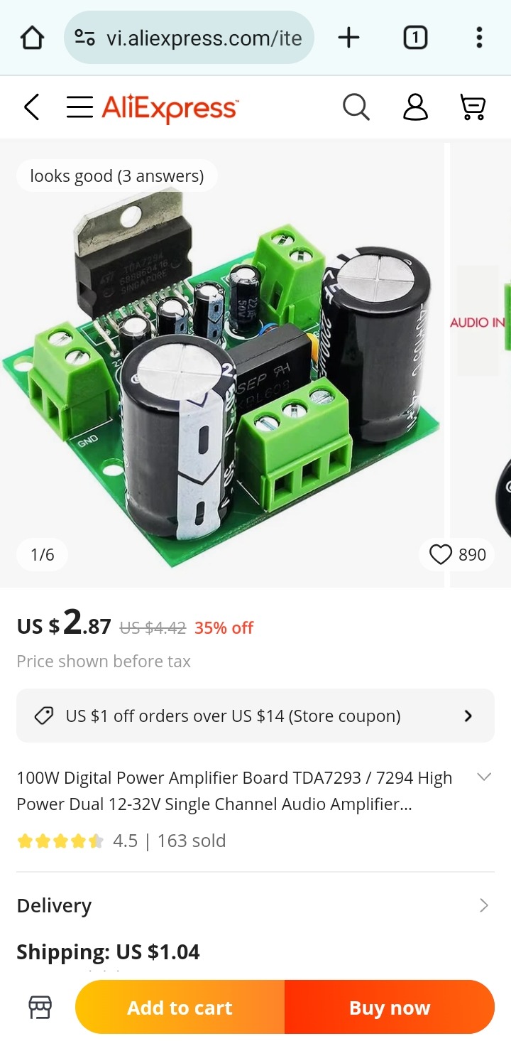

The original TDA7293 is sold for $10 from mainstream vendors. 2 years ago when I looked last, they had ST logo unable to distinguish a copy from original but defective. Nowadays I see without logo with Hugh quantity availed for $1 to be sure they aren't defective original ones.
I ordered 2 pairs from 2 vendors to see what they worth but I will receive them in 1½ months.
These boards sold for $3, certainly are functioning but with what quality?
On youtube, I find several audio tests but they are with simple music mostly Indian as this compared to probably copy LM3886.

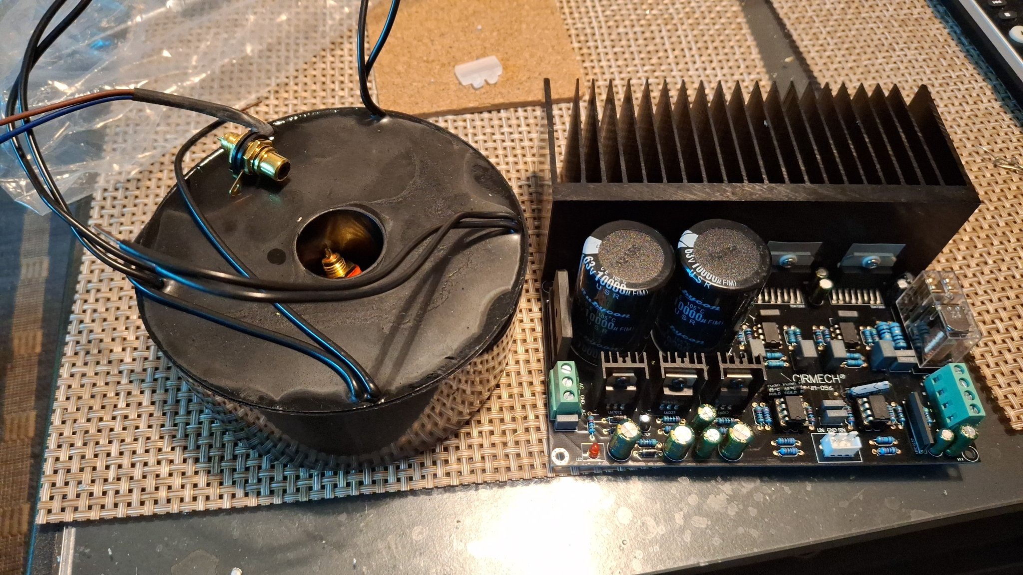

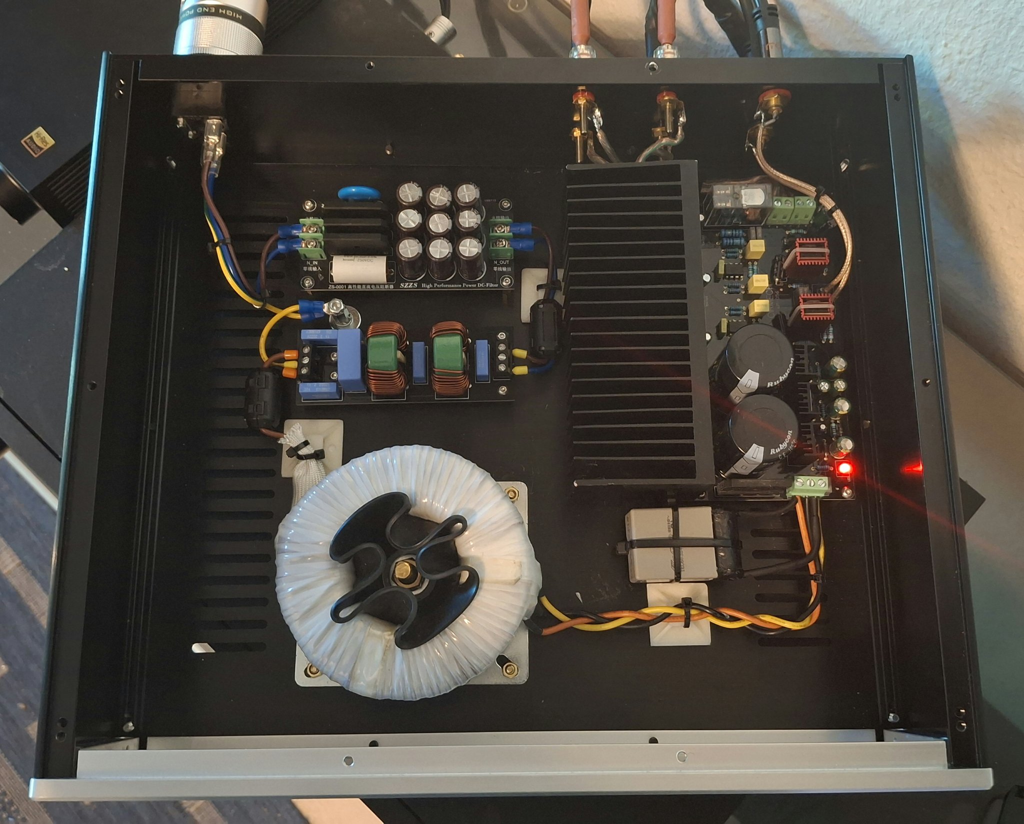

There's a TDA7293 board from Cirmech available on AliExpress, eBay, etc.
This board sounds very good; everything appears to be original. Some of the capacitors are 35V types. If the board is supplied with the specified voltage of 2x28V AC, these capacitors will burst. This amplifier runs very well with a maximum voltage of 22V.

Have you tried the circuit board?
I think the sound is very good and I don't think it's a fake. The Kaltec board uses a similar circuit and is slightly better equipped, but it also costs several times more!

I initially thought they were counterfeits, so I swapped the two TDA7293s for ones I'd purchased from Mousers on the first board I installed. They sounded no different, whether loud or quiet! Even if the TDA7293s were indeed counterfeit, they don't sound any worse. In any case, this board sounds better than many other TDA7293s I've heard before. I don't want to justify myself any further here. This board offers very good value for money.
