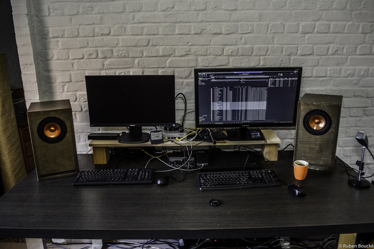

I use the Mark Audio Alpair 10.3 in a reflex cabinet that is fairly neutral for a fullrange, but not as neutral as the C-Note. I do know the sound of it very well, so i can mix on it and have a good result. It's also not that cheap to build (I spend about 600€ on the build), but here you got my design: https://www.dropbox.com/s/e619di32n...0M-Slot-Ported-Official-CAD-drawings.pdf?dl=0

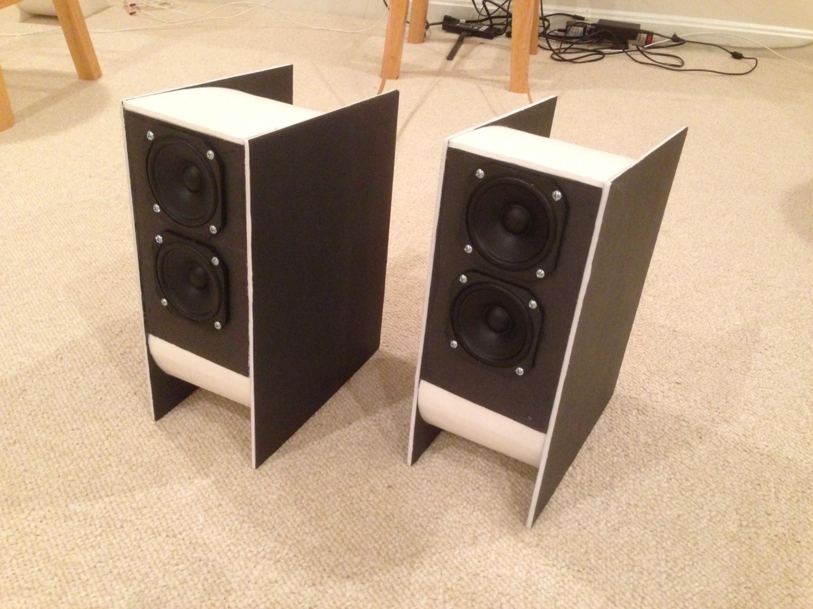

Member Bonjonno likes 0.40X mini Karlsonator as monitors.
They are cheap - $3 of foam core board and hot melt glue and $19 Faital Pro 3FE25-8 drivers. Or $12 TC9FD. More here:
https://www.diyaudio.com/community/threads/mini-karlsonator-0-53x-with-dual-tc9fds.239338/
If you want true neutral cheap monitors, the TC9FD in a Nautaloss spiral back chamber works well down to 150Hz. Add a subwoofer. They sound great and very neutral and revealing.
More here:
https://www.diyaudio.com/community/threads/the-nautaloss-ref-monitor.247598/
More here:
