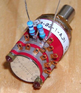

Here’s a project for anyone who wants to build an audio taper stepped attenuator volume control on the cheap. Before anyone gets too excited this project is a prime example of “give-and-take” in design. To make it cheap, compromises had to be made. The good news is that it doesn’t compromise on sound quality, so you can try it and see if you like the results before you invest in a much more expensive unit without the compromises. I like to use this design when I’m building a prototype, as I can usually build it for less money than a decent quality stereo potentiometer, and it allows me to optimize the impedance to the circuit I am using it with. I will be slowly posting this over the next few days, so bear with me!
So, you ask, what are the compromises? The primary compromise is made in either the size of the volume change between steps, or the total range from loudest position to quietest. The best stepped attenuators offer between 24 and 30 discreet volume levels. This unit only has 12. The compromise I have settled on is 4.3dB steps between –48dB and –1dB. Others might prefer smaller steps distributed over a narrower range, but for myself I find 4dB steps aren’t too bad. The other compromise is that this is a series attenuator where all the resistors are in the circuit all the time, unlike ladder attenuators or shunt attenuators, which only use two resistors at a time for each channel.

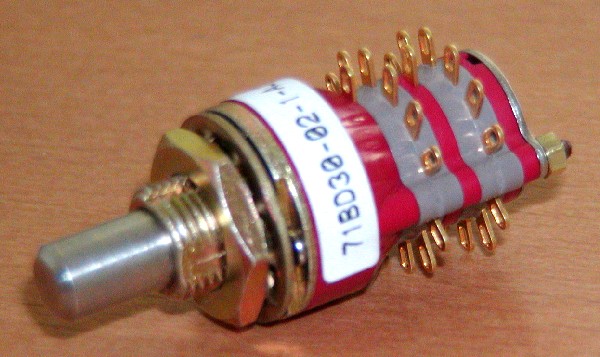

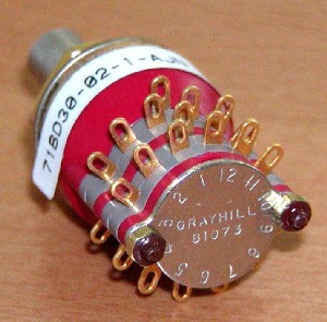

So what do we need? First, a switch! For a stereo unit you need a 2 deck, single pole switch. I like the Grayhill 81073, which as I mentioned earlier, offers 12 switch positions. Lastly, you need resistors in the right order of resistances. For this project, I wanted a 22kohm impedance. The resistor series is as follows, where the position numbers indicate the switch position as seen on the back of the switch.

The Greyhill switches I'm using are plastic and metal, but they are quite robust, and have a very positive feel when being switched. You can turn the shaft reasonably easy just with your fingers on the shaft too.
I have no idea if they are non-shorting or not, but so far I haven't found anything objectionable about their performance whatsoever. No clicks or pops on switching, smooth switching action with a very positive stop at each position. I have a Goldpoint series attenuator and with the exception of the greater number of steps I don't find any noticeable operational or audio difference. A nice note is that the same switch is also available in a 4-deck configuration which would be ideal for a stereo attenuator for a balanced circuit.

OK, I had a brief hiatus while dealing with other issues, sorry for the delay. So to continue:

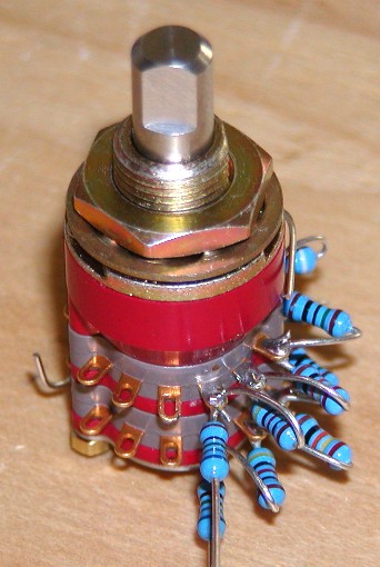

Start by soldering the resistors between the switch positions. I.e. the 1-2 resistor I previously indicated will bridge the terminals for switch position 1 and 2. Out of habit I start with the ground – 1 resistor and add along towards the 12 terminal.
Before I reach the terminals for switch position 12, I add the output wires to the terminals for the switch connection.. Yes, I know the terminology I’m using is a little confusing, but the pictures should explain it clearly. Send me an e-mail if it doesn’t make sense.

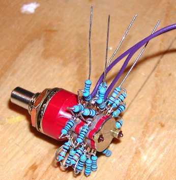

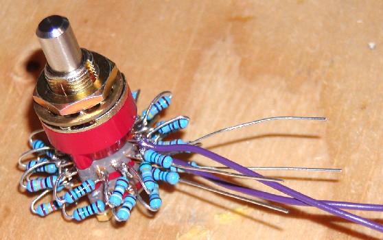

Once all the resistors are soldered on, the only thing left is to make the input and ground connections. Ground connects to the free end of the resistor soldered to the 1 terminals. Signal input connects to the free end of the resistor soldered to the 12 terminals.
Another view of the finished attentuator without the input and ground connections.
I should have mentioned that the reason I solder the output wires before completing the resistors is because the output terminals are damn hard to get at with a soldering iron once all the resistors are added.
