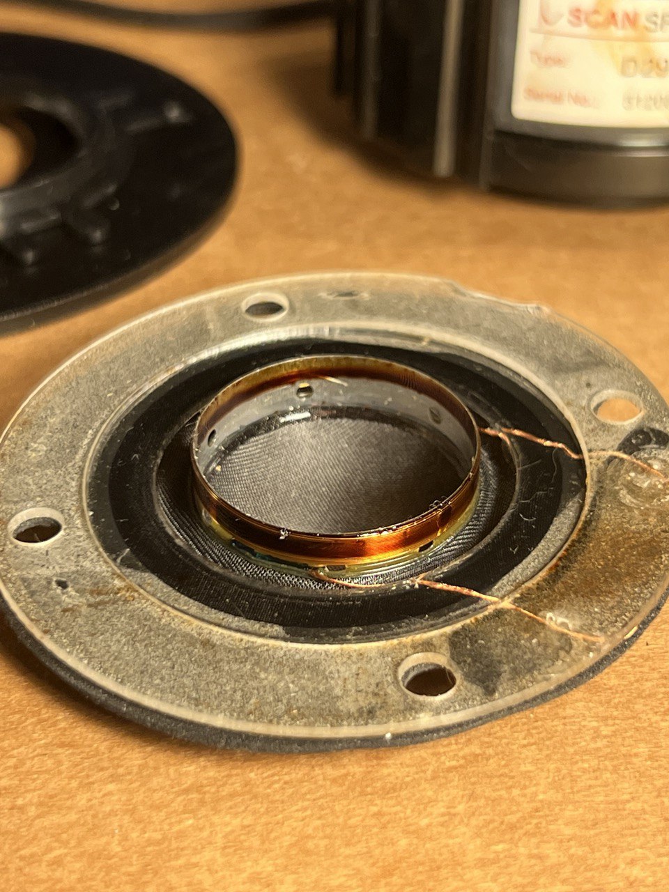

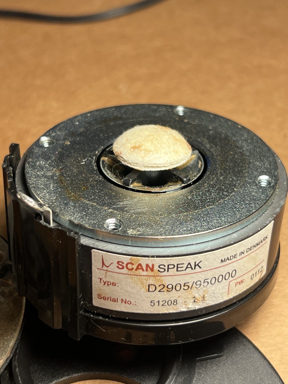

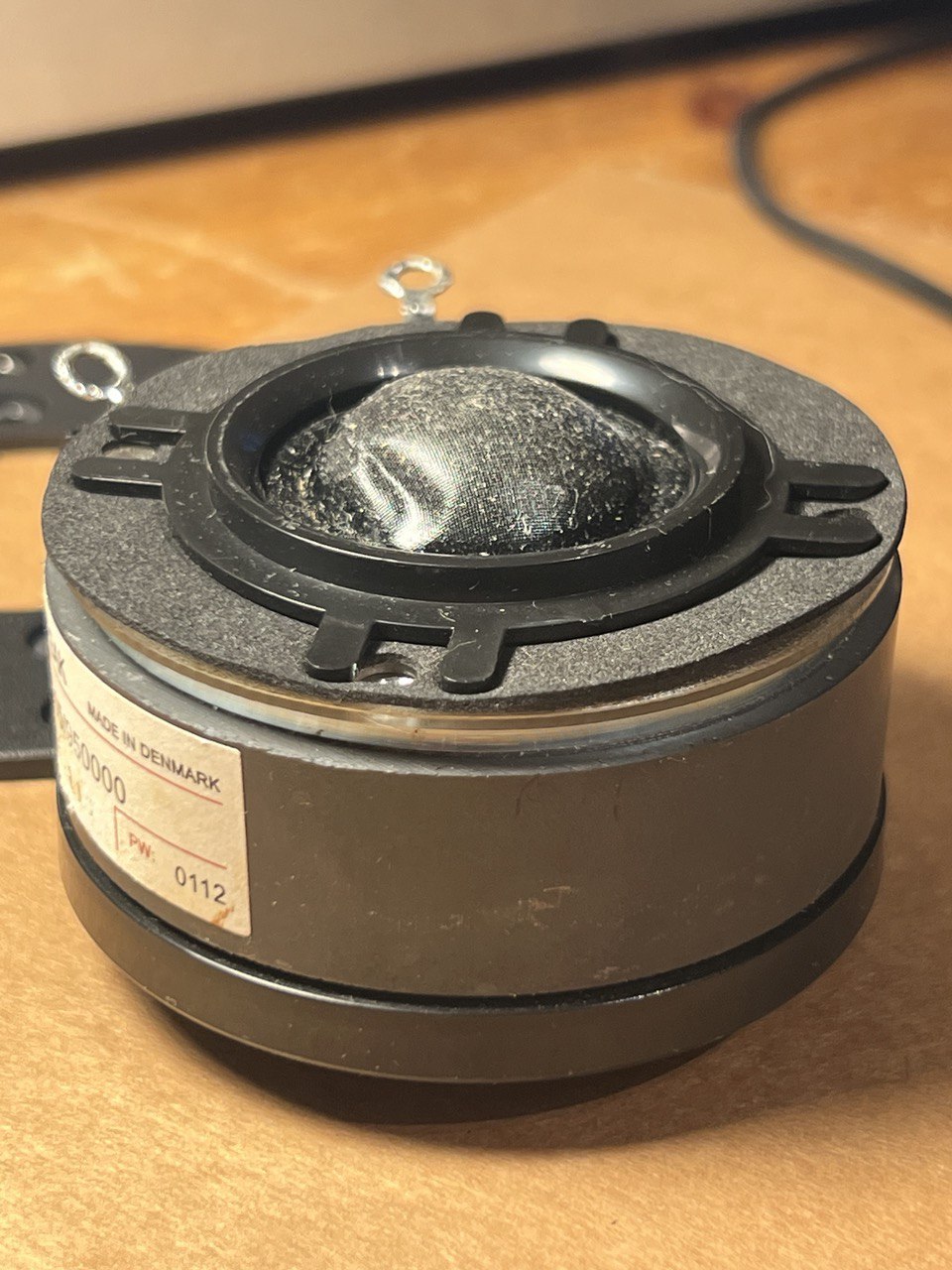

Well, I've bought 5 of these tweeters in total. One piece fell from a height and got damaged, so I took it apart, and now we can take a look inside.
I broke fabric cap and got everything dirty with ferrofluid; initially, the tweeter was perfectly clean. The only difference I noticed from the original Scanspeak is the color of the metal core under the fabric cap.
