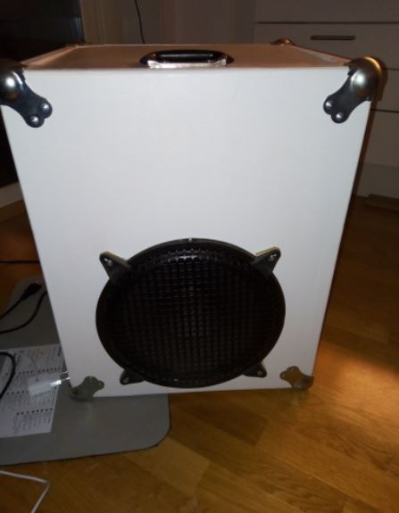

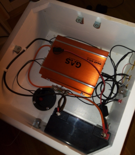

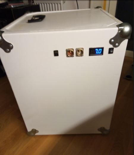

I have built a Boombox with a Fane Sovereign 12-250TC I have it in a 51 liter ported box (originally sealed) tuned to 45hz and it sounds really nice with an insane amount of bass, it's also super loud, I haven't tried it's full potential yet but I would assume atleast 120dB as it is now.
Here it is, I plan to add a tweeter to it at some point since it's just a prototype really.
