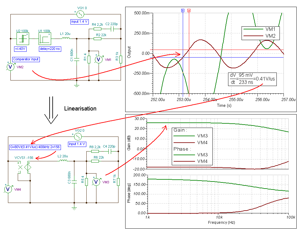

Aucosticraft!
You asked explanation about freq. domain simulation in PM, but I couldn't attach picture there, and maybe others are interested too.
