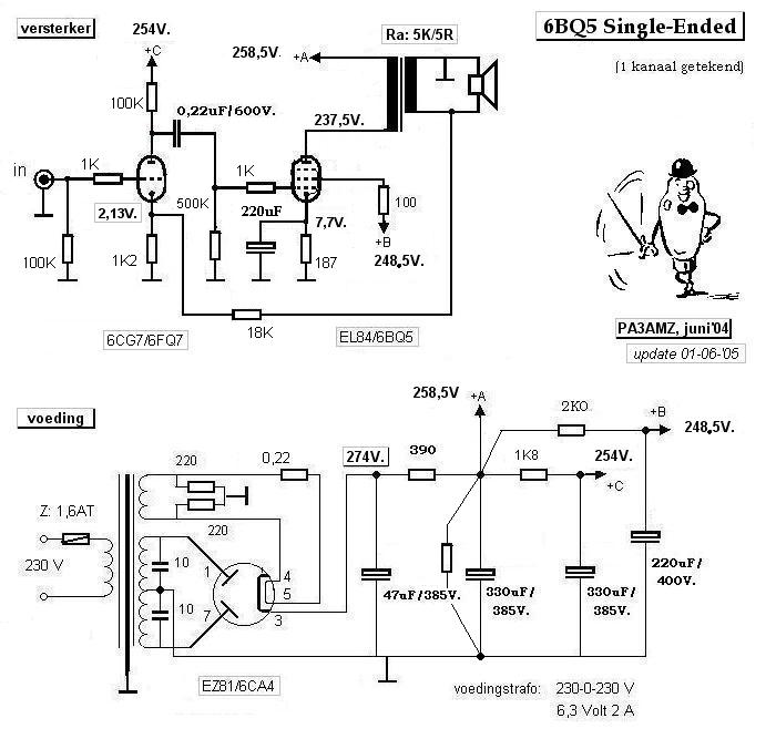

Any structural weaknesses in the schematics that should be addressed in the modified model you can think of right away?
Se El84
Ik vind de ingangstrap veel te complex. THE LESS, THE BETTER!! En een ECC82...foei! Very lazy and dull-sound.
Zeer veel ge-experimenteerd met SE EL84 eintrappen:
# Mijn tips:
1. vervangen de ECC82 door de 6CG7 EH (Electro Harmonix) of de RCA 6CG7 met Side-getter! Amazing improvement!!!
1.a. Instelling 6CG7: Ra : 100K, Rk 1K2 , Ub 260-280V. DC
2. Buisgelijkrichting: absolute topper is de 6CA4/EZ81 EH (Electro Harmonix): gemak, ruimte, detail, body/drive.
My opinion after a lot of experimenting with SE EL84:
forget de lazy and dull sound ECC82/5814A family; inputstage to complex in my opinion...;
golden tips:
1. input/driverstage: 1/2 6CG7 EH or 1/2 RCA 6CG7 with site-getter! Amazing improvement!!!
1.a. feeding the 6CG7: Ra : 100K, Rk 1K2 , Ub 260-280V. DC
2. Tube rectifier: 6CA4/EZ81 EH (Electro Harmonix): lots of detail, headroom, easy, emotional sound, a lot of body/drive.
(Enough sensivity to work without pre-amp. at 94dB plus speakers also. With EL84M/6BQ5WA from Sovtek, Philips Miniwatt El84 and EL84 EH [Electro Harmonix]).
(schema enclosed)
Dogie
