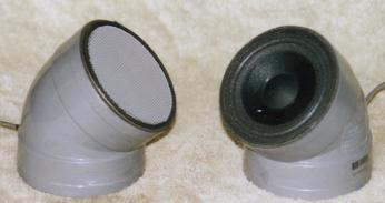

These are just an el cheapo computer speaker put into a sealed 45° PVC elbow. Volume was calculated, damping in the elbow. Sounds better than before but nothing flash.... good paper weights as well.
