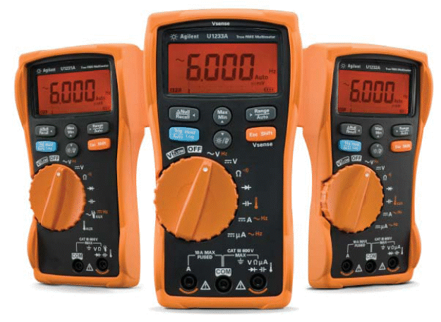

I am inclined towards a sturdy more compact one for that. Like your 115C but loaded with auto hold, uA range, logging to computers, accessible fuses, AAA cells, 500h lasting, back flashlight even. And check its latest comms thingy out Agilent U1177A - YouTube, waiting they stock up to get em together.

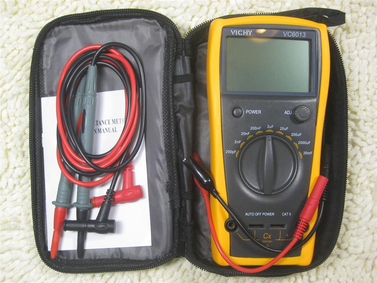

I'll use the meter for a few days but it will end up like many of the other cheap meters I have, sitting on a shelf with a pile of other meters.
The meter is very slow compared to better meters. no beep on diode check, no indication that it's actually doing anything when it's waiting to update the display....
It's an OK meter and someone who has never used a good meter would think it's perfectly fine. It would be a great buy at $30. At $45, it's OK. For the casual user, it's likely going to be acceptable but it will be too expensive for many and those who can easily afford it should buy something better if they're going to use it for repair work.
The capacitor range is better because the vichy barely works and is useless on most values. For a 330uf cap, it takes 8 seconds to read. One problem is that it gives no indication that it's doing anything. For a 0.047uf cap, it reads 0.058uf. The cap read correctly on two other meters (Fluke 12 and Sencore LC102). The readings were the same with the leads or with the capacitor directly touching the contacts in the banana jacks.
Unless someone wants me to check something specific, I'm no longer going to post anything on the vichy.
