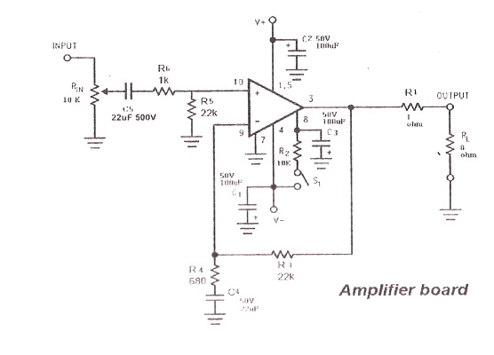

There's a couple of things on the schematic that came with the boards that I'm not quite sure about. There's a 22uF 500v cap on the input right after the pot. Seems a little excessive. Is there some sort of magic that comes from hugely over rated DC blocking capacitors (I'm assuming this is the purpose of this cap)? How should I gauge a substitutions?
There is also a 1ohm resistor shown between the output and the speaker. Seems weird to me. Not sure what it's doing there. I've seen resistors to ground off of the output on other designs, but not a resistor in the signal path. I assume this would need to be a 3 - 5 watt resistor as well?

Ah, so I could do without it? I've seen input caps everywhere from .22uf to 22uF, what's the difference? I'm actually debating that, but since I'm using this to power monitor speakers for a modular synth DC blocking might be a good idea.
So then what do you think this 1ohm resistor is for?
The input capacitor forms a highpass filter with the input resistor. The higher the value of the capacitor, the lower the frequency cutoff, and the more deep bass you get. With a standard 10k input resistor, the capacitor stops being important past 2.2uF (10k/2.2uF has roughly a -3dB point of 7Hz).
Unnecessarily large input cap can cause audible transients (popping) at turn on. As for the 1ohm resistor, i don't think that was supposed to be there. Or if it was... it should probably be 0.1ohm if it's in series with the speaker.
Are you sure that resistor isn't supposed to be more like 10R with a wire wrapped around it to form an inductor in parallel?
Like in this schematic.....

If this is correct 2.2 uf on the input cap is fine and the 1 ohm resistor before the output is also fine.
I too wrangled with the 22 uf 500 v nonsense.
It's a typo on the instructions.

keep the 1r0 in the output feed.
Add a 1uH air core inductor in parallel to the 1r0. This converts the output from a Zobel load to a Thiele Network for amplifier output.
The Thiele Network helps avoid instabilities in the amplifier better than a Zobel alone.
The 22uF 500V and 10k for the input filter is a bad recommendation.
Try using between 470nF and 4u7F plastic film cap at the input as your DC blocking capacitor.
I like the bass sound that comes from using 1uF and 91k giving an F(-3dB)=1.7Hz. This is roughly equivalent to the specification of -1dB @4Hz that is fairly common in good retail offerings.
You can mimic the same high pass rolloff with any RC combination that has a 91ms RC time constant.
However I believe this works only when this input filter determines the bass response of the amplifier. This demands that the NFB cap be sized to match the input cap.
NFB cap >= sqrt(2) * Cin * Rin / Rfb.
Many use the NFB cap to roll off the bass rather than at the input and I think this gives poor bass sound. It's fairly easy to add parallel caps in these two locations if you start with both being too small and find what combinations suits you, your speakers and your room.
Using the values in post6
NFB cap >= 1.4 * 22uF * 22k+1k / 680r >=1050uF ( a silly number for this amplifier.) Any smaller than 560uF and the NFB cap becomes the passband filter (= bad in my opinion).
Change Cin to 2u2F and the NFB cap becomes >=105uF. Use 120uF or 150uF or 220uF (not 22uF).
