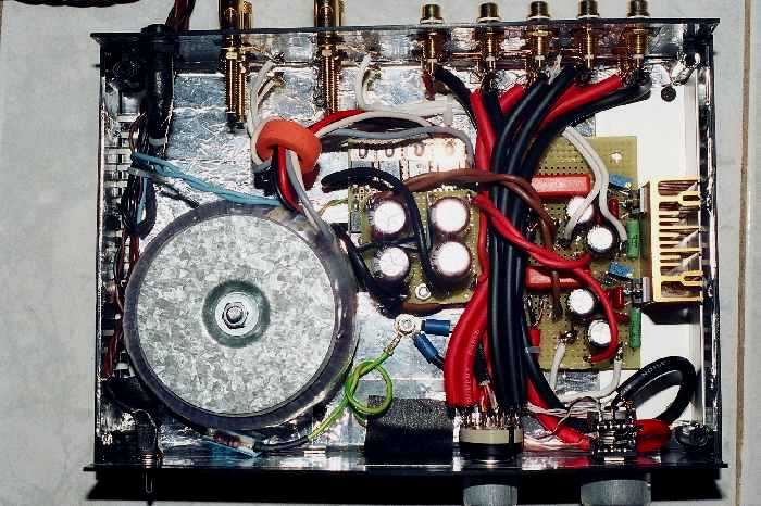

Cheap, good, GC toroidals:
Am I buying cheap?
I always order my toroids to a factory here in Portugal.
I ask what I want, because they are always cuustom made.
The last one I bought is:
Primary: 230 V
Secondary: 18-0, 18-0, 5 A
That's a dual secondary (not CT), 180VA.
Price?
27.5 Euros.😎
+ P&P (around 4.5 Euros here).
Am I buying cheap?
Deam, they look beautiful.
And they always send the metal disc, two rubber circles and a screw to mount it.

You can ask what you want.
But this one is 2x18V because this GC I built with LM1875 chips.
BTW, beautiful.:nod:
You can even ask 4 secondaries, two for each channel.
The limit is your imagination.
You ask the price to them, I don't know, they don't have a price list, it's always a custom built.

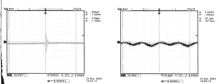

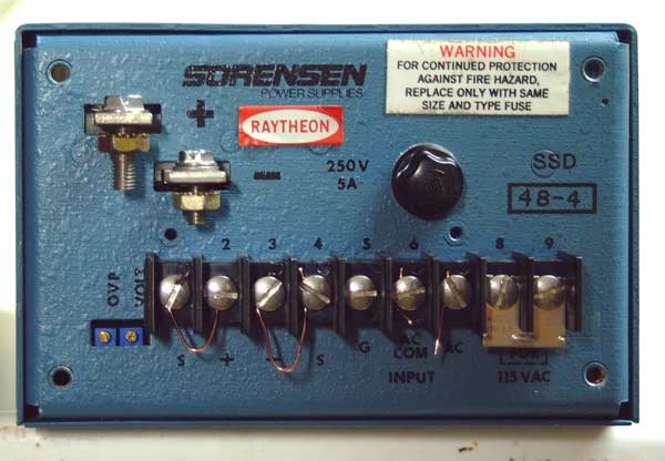

GC Power Supplies -- keep your eyes out
if you see some of the older Sorensen SSD48-4 supplies -- they could make an excellent GC Switching Supply and show up from time to time at less than $10 -- they weigh about 5 pounds, will put out a surprisingly, well very surprisingly clean 48 Volts, 4 amps -- you will need 2, obviously -- I measured the switching noise at 20mV on top of 48 VDC, and there was no tell-tale radiation onto the a.m. band. Here's a graph of the noise pulse and the ripple on the 48V rail:

Hey Jack,
So you need 2 Sorensens to get V+ and V- ?
I've been interested in switching supplies since I was told that these high quality ones are a whole different animal than computer supplies. Good info
48 V is a bit high though , right? or can they be adjusted?
Maybe perfect for an Aleph
i don't think that it's a good idea to try and use one with "floating" ground. The adjustment on these particular supplies is, I believe, 44 to 56 volts. They will put out 44 volts even with a line potential of 70VAC.
the telcom supplies for distributed voltage have 48VDC out.
