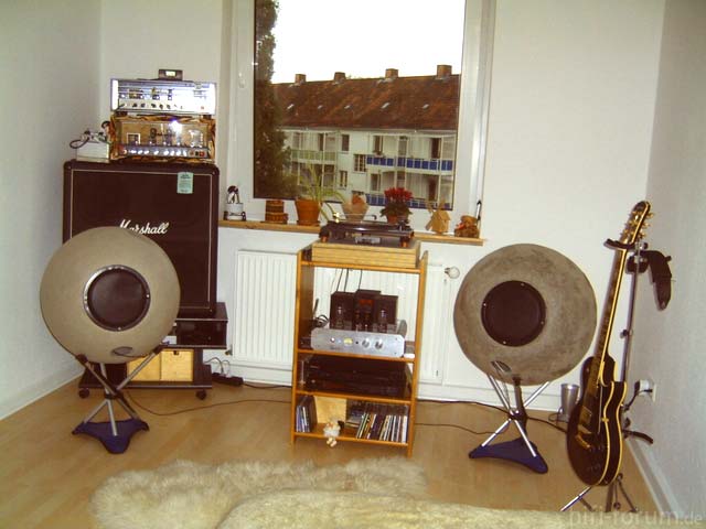

I have a new room for audio and now I hear with the bowlspeaker.
attachment.php
In germany you can buy this speaker by hth :HIGH-TECH-HIFI
scroll down and you find the speaker.
For my ears I think this speakers are better than the most Fostex I know. Last one I can hear was the 206e and I don´t like it.
The 1026u runs without any filter.
nice greatings, Hatti

These big bowls where built myself and this takes a long time, about 1 and a half year.
A take a big steel-bowl for gardendesign and put on shredded newspaper with glue for wallpaper. It takes a very long time for drying.
Than I cut them in peaces to get the steel-bowl out and glue the peaces togehter.
http://www.rahaso.de/foren/audiotreff_selbstbau/user/Hatti/die_zweite__zweites_mal_ausgekugelt.jpg
http://www.rahaso.de/foren/audiotreff_selbstbau/user/Hatti/Lufttrocknung.jpg
blow in air for quicker drying.
http://www.rahaso.de/foren/audiotreff_selbstbau/user/Hatti/110810_einlaminiert.jpg
view from in through the woodring for mounting the chassis
http://www.rahaso.de/foren/audiotreff_selbstbau/user/Hatti/110810_mit_Chassis.jpg
http://www.rahaso.de/foren/audiotreff_selbstbau/user/Hatti/150810.JPG
http://www.rahaso.de/foren/audiotreff_selbstbau/user/Hatti/Erste_Kugel_mit_BR.JPG
The 58cm steel-bowl is from ebay germany: Edelstahlkugel | eBay

@pjanda1: I use this bowl speaker since 3 month. 2 month in my old room, 1 month in the new room.
