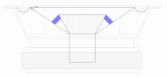

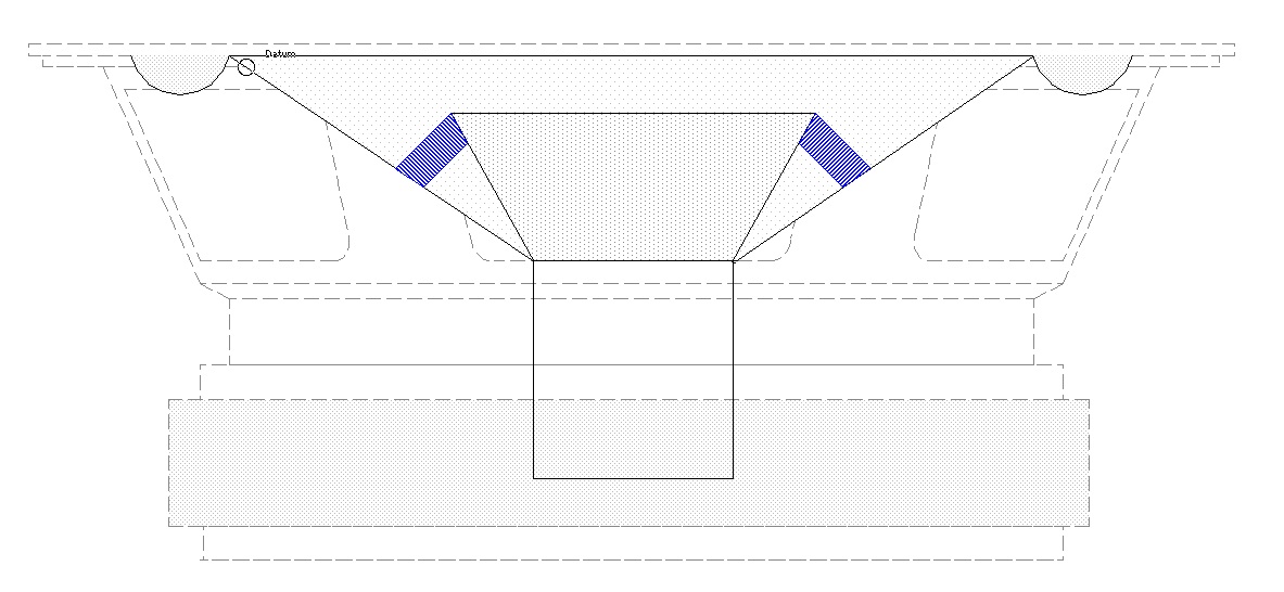

Timn8ter said:They look like those TV speakers that Parts Express was clearing out. Try putting something on the cones like Dammar or Puzzlecoat. It might tame them down.
planet10 said:
i've had good luck with dammar on the whizzer, puzzlecoat on the main cone. Add the 98 cent tweak & ductseal the baskets.... you may still need to add an LCR EQ circuit.
dave
I wonder that could white PVa wood-glue or 2-component epoxy glue be used to make the cone(s) stiffer?
What do you mean with the "98 cent tweak"?
I've tried to attach some pieces of foam inside the "whizzer" and between the main cone and the whizzer. Making not much difference...
GM said:
...though without the other tweaks it will probably still have the undamped whizzer 'shout', breakup modes, and reflections back through the cone typical of cheap FR drivers.
"Whizzer shout" is just the right term to describe the sound. It's really harsh sound.
If the sound doesn't come better after some simple tweaks, I think I'll start looking for some 3" or 4" Tang-Band drivers... I see that they're also not very expensive but perform a lot better (what I've read on the WWW).
arcturus said:I wonder that could white PVa wood-glue
Puzzlecoat is a close relative of white PVA glue & often used as a substitute. You might have to thin it just a bit.
The 98 cent tweak is the foam between the whizzer & the main cone...some people have found that this trick kills the dynamics, but there is a sweet spot where the foam is supportting/terminating the edge of the whizzer, and providing some damping for the cavity, with not enuff & too much on either side of the sweet spot. I find that its effectiveness workd well in conjunction with stiffening the whizzer -- dammar will stiffen it a lot more than puzzlecoat/PVA and therfore tend to require it to have more damping. I will also add a ring of puzzlecoat on the backside top edge of the whizzer to further terminate it.
dave

arcturus said:I'll try to apply a bit of white PVA into the whizzer cone...let's see what happens! 🙂
do the whole cone...
What do you think about the epoxy glue? At least it is super-tough. Might be a bit more difficult to apply to the cone, though.
I've tried lots of things -- i can't see using expoxy thou -- unless you could get some that is really thin.
dave
I applied some water-thinned glue into the cones, and the result is good!! Perhaps these drivers have some potential afterall!
