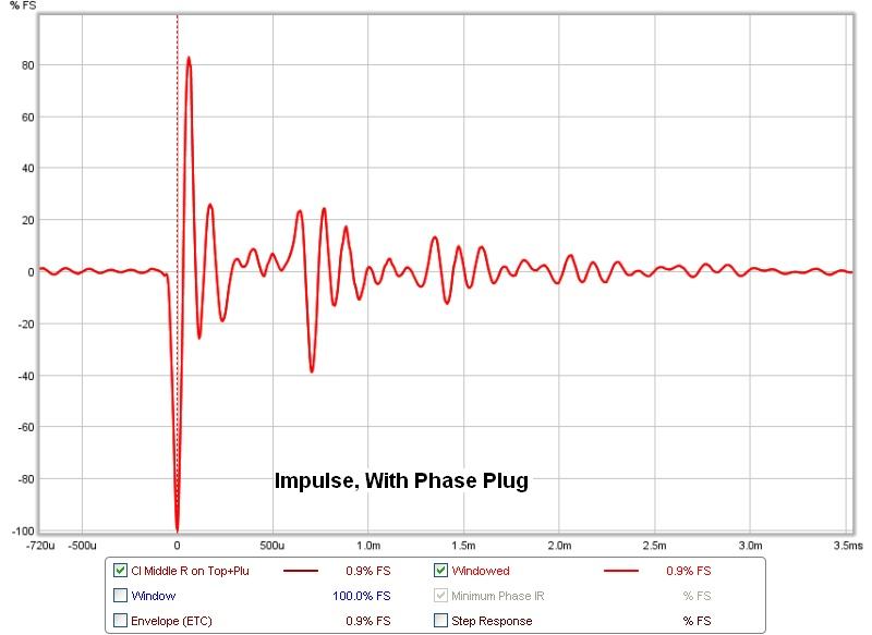

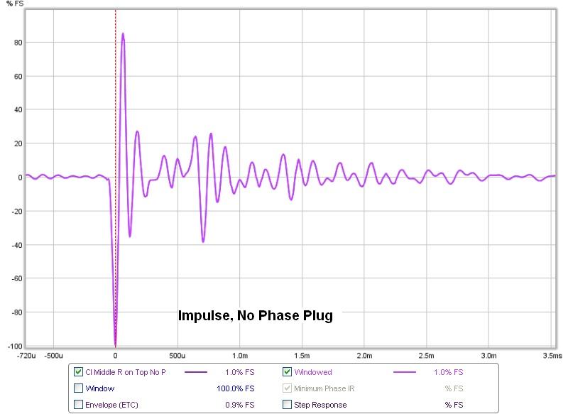

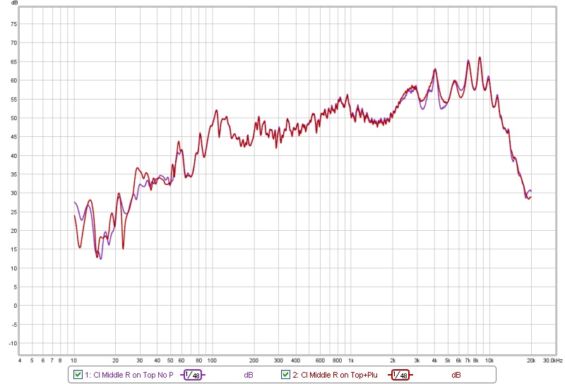

For the record, here is the freq response with phase plug and without phase plug.
Pink: No phase plug
Red: With phase plug
Mic 90d above Baffle Level 0.23m from Speaker Center
Only one Speaker active. Speaker positioned in the Middle of the Room, away from walls.
Regards:santa2:
