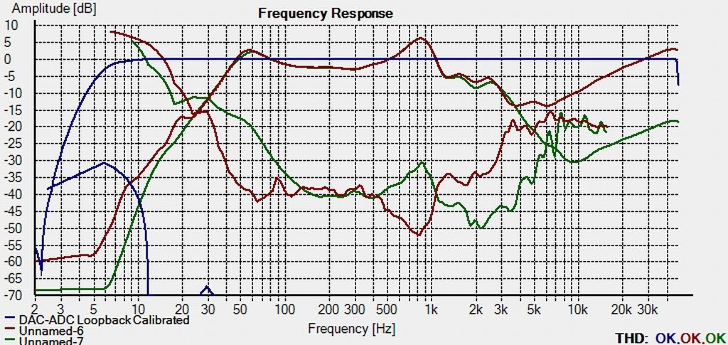

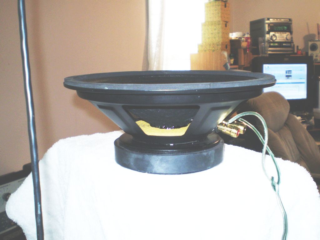

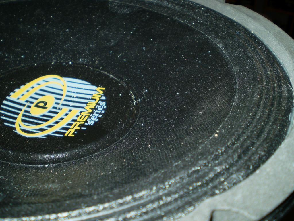

Here are my measurements of the Pyle PPA10 as promised.
They were done with a Dayton measurement microphone 1.5" from the driver in open air.
The first plot is done with HOLMimpulse at two levels ( I didn't note the voltages on this test) and the bottom curves are the THD levels in db.
It shows a rather high THD below 40hz and this is normal as the driver reached Xmax quite quickly in open air.

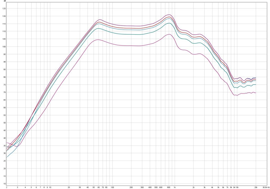

The second plot was done with REW V5 at various levels from .5 watt to 50 watts.
It was calibrated with a Spl meter at the .5 watt level of 2Vrms at 8 ohms.
I had thought that these were 4 ohm drivers but they are not. he,he 🙂
enjoy !!!
jer 🙂
P.S. The highest level curve may be in error as The microphone may have started to clip at that point I will check to verify this but at least this does show the true frequency response of the driver.
P.S. It has been verified that the microphone signal was clipping at the highest level but the amplifier and the driver was not distorting at all. 🙂

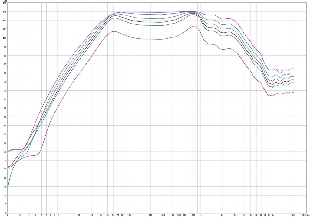

Here is the corrected REW V5 plot with no microphone clipping this time.
Calibrated at 1 watt to 50watts.
Sorry about the error on the last one.
I also re-did the HOLMimpulse plot as well but there was no sigifincant difference as those levels were at a lower level.
jer 🙂
jer 🙂
geraldfryjr,
Would you say that the ~89dB sensitivity specification is accurate?
I think for the application I would accept that sensitivity in a 5-6.5" driver, but not in a 10".

I would have gotten these I but I didn't find them until after I had ordered the Pyle's as they have a nice die cast frame.
The one thing I do like about the Pyle's compared to the other 10" drivers in its price range is that it has a higher Xmax than any of the other drivers I was looking at.
As well as a power handling capability including that MCM select that I had just posted ( for the peak power).
Knowing that this driver is going to get some rigorous bass use as well, I figured that the largest Xmax that I could get was a very important issue as well.
But I did get them at a very good price at Xmas time as well along with a lot of other things.
I think there was another discount of 10% or something, So I didn't have a lot of time to scope things out more thoroughly.
So,I am happy with them anyhow.
I had thought about getting a driver with a higher efficiency rating but the higher Xmax and power handling had ruled that out considering that in my application I am using 6 drivers.
This gives me an added increase of efficiency of 7.8db.
According to Winlsd this puts me at 128db at 1200 watts and is about everthing that my amplifier can do (Ashley FTX2000).
And is way more than enough for my needs and they will rarely see any of those levels so it makes little difference if it takes 500 watts or 1000 watts to get there.

I did some more efficiency measurement and it was very hard to get some accurate figures using the calaculator.
I do get 118db at 500hz and 1000hz at 1 watt flush with the driver.
I have found that by entering the distances in feet seem to give a better reading than meters.
For instance if I have 118db at 1cm I also measure 112db at 10cm and not 98db like the calculator depict's. ???
So by using values of greater than .5 for my initial distance values for a measurement point I seem to get better results.
Therefore if I am getting 112.5 at .5 foot I do read about 106.5 1 foot, So in the calculator this works out and according to the calculator I should be getting 95.76db at 3.25 feet or 1 meter at a level of 1 watt.
This is much higher than the advertised figures for this driver at 89db.
I could tell when I first set the levels that 89db at one watt could not have been right!
Considering that I had just got done testing my little 8" sub that is rated at about 88.5db.
Being that I am using less than adequate anechoic conditions and my room is very cluttered, I manged to position the driver so that I could get a reading from 1 metter away.
I had verified the results at 500Hz and 1000Hz at about 95.4db at 1 watt with it sitting in its packaging box in order to help dampen the backwave at those frequencys.
Thanks for putting me up to this as the advertised figure of 89db did have me a little bummed out.
But now I am very very happy the the results !!!

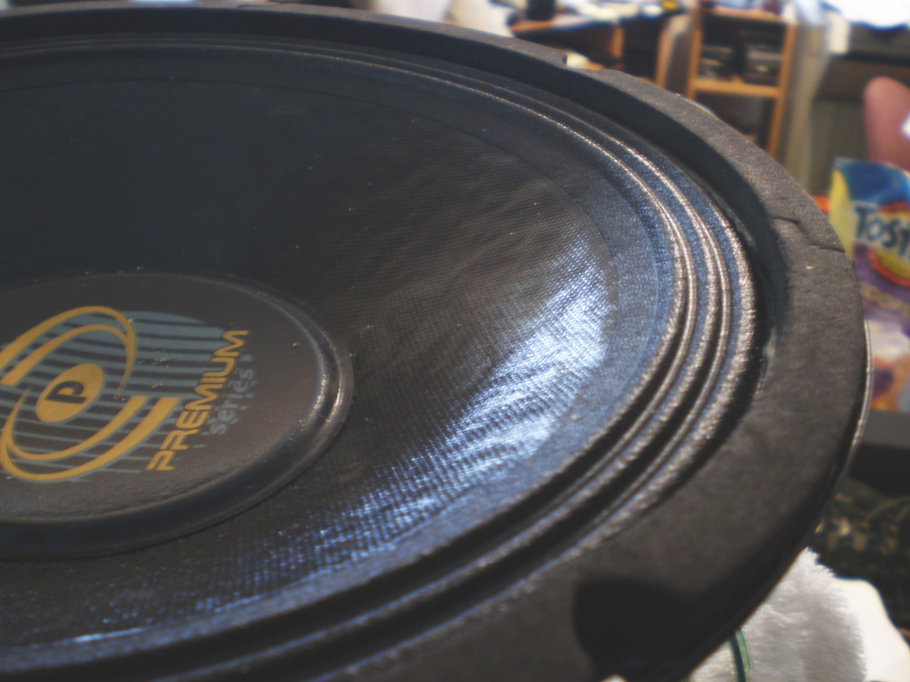

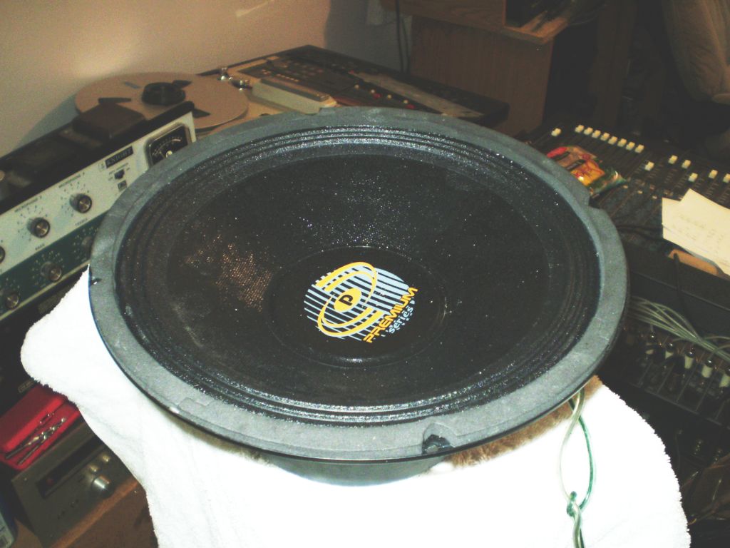

Here are some pictures of the driver.
enjoy !!!!
jer 🙂

jer,
You can't do a sensitivity test inside a room like that. Your mic is picking up not just the sound from the driver, but all of the room reflections and loading, giving you a ton of "fake" sensitivity data.
Yes, I understand that it is not the most accurate,But the numbers do line up.
118db flush with the driver is a lot louder than any reflections, and, 112.5db at .5 foot to 106.5db at one foot is exactly right.
Therefore the 95.5 db at 39 inches also coincides with what the calculator comes up with as well.
I also used a distance of .5meters at 19.5 inches and 1meter at 39 inches and the results were the same.
I think that it is pretty close.
In that particular area of the room there is alot of diffraction going on and very little direct reflections although like I said "it is less than optimum".
I did try different frequency's as well to help combat the effect of possible reflections and the results were the same.
If the weather was permitting I would have done it outside.
When it does clear up I will redo this again just to see how far off it is.
