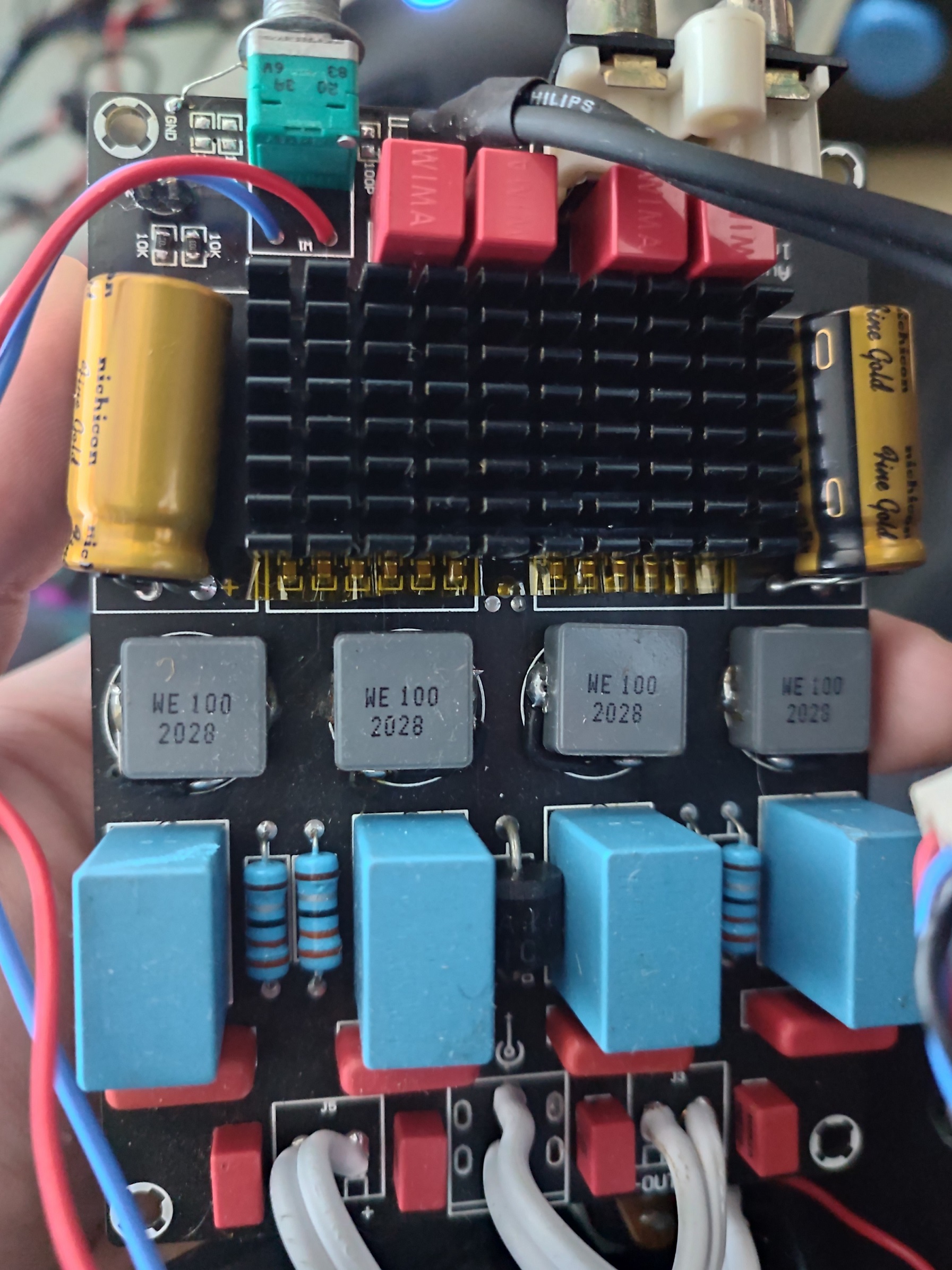

My current Class D amp is a TPA3116 with a 5532 Preamp.

That 3886 I linked looked interesting as it already has a set for Preamplification. Maybe some changes to capacitors would be needed, but that isn't the biggest issue (I begin those projects and slowly go over them, like the TPA).

What is your LC filter value and your speaker impedance?
Incorrect LC filter may cause early roll off.
For 8 ohm, I do recommend 15uH and 470nF.
The cutoff frequency will be at 59.9khz and Q factor 0.708.
Also, cheap inductor can increase distortion when playing loud.
The Toko inductor that TI TPA3116 EVM uses is a good one.

That I did not know. I am still learning as a hobbyist, but the values are:
10uH Inductors from Wurth, these are possibly their highest current Inductors in that package size (they were samples, so those are not knock offs)
1uF/450v TDK Capacitors, both of these values are the recommended ones in the datasheet.
I don't know how to calculate the cutoff frequency of that filter yet. Should I revert to the 680nf Capacitors the board came with?
I was about to change the DC caps to higher values and see if that made a difference (470uF to 1000 or more).

Here is the excel from TI to calculate your filter.
LCFILTER-CALC-TOOL Design tool | TI.com
The simulation for 10uH and 1uF seems ok. Boost of 1dB at 20kHz.
Keep the 1uF there first.
Even though it's Wurth, I won't know how good the inductor till it's measured. 😀
Any measuring equipment you have there? Multimeter?

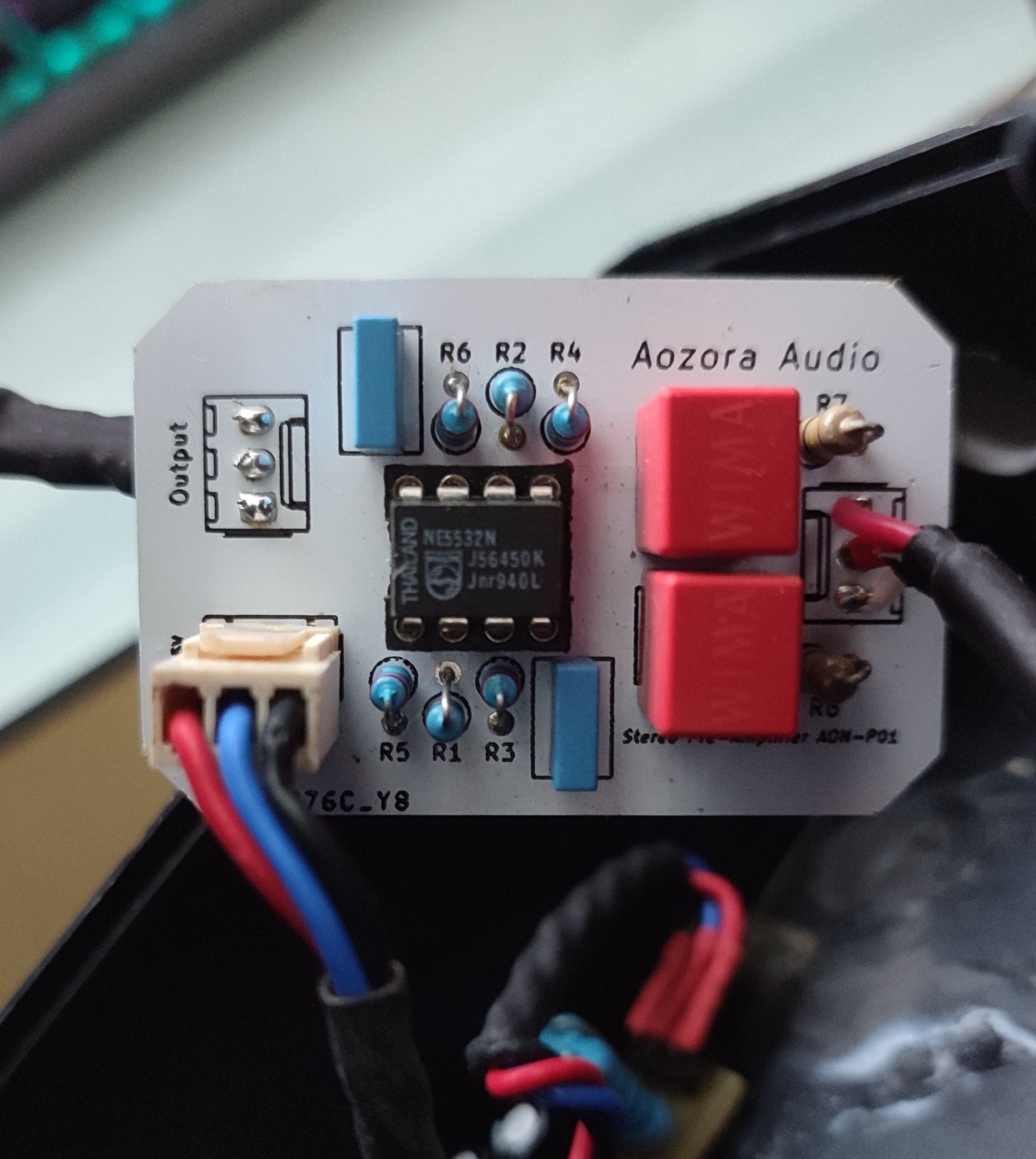

Yes, that is true! The weird part about it all is that, I have original NE5532s and OPA2132s from TI, I got them in their website as samples. If I were to describe them in that Pre-Amp, the OPA2132 kinda sets the high frenquencies back a tad, and the NE5532 from TI is the somewhat better balanced. The only reason I kept those Philips I got from China (so yeah, most likely fakes), is that they actually have somewhat better bass while keeping the same highs as the TI NE5532s.

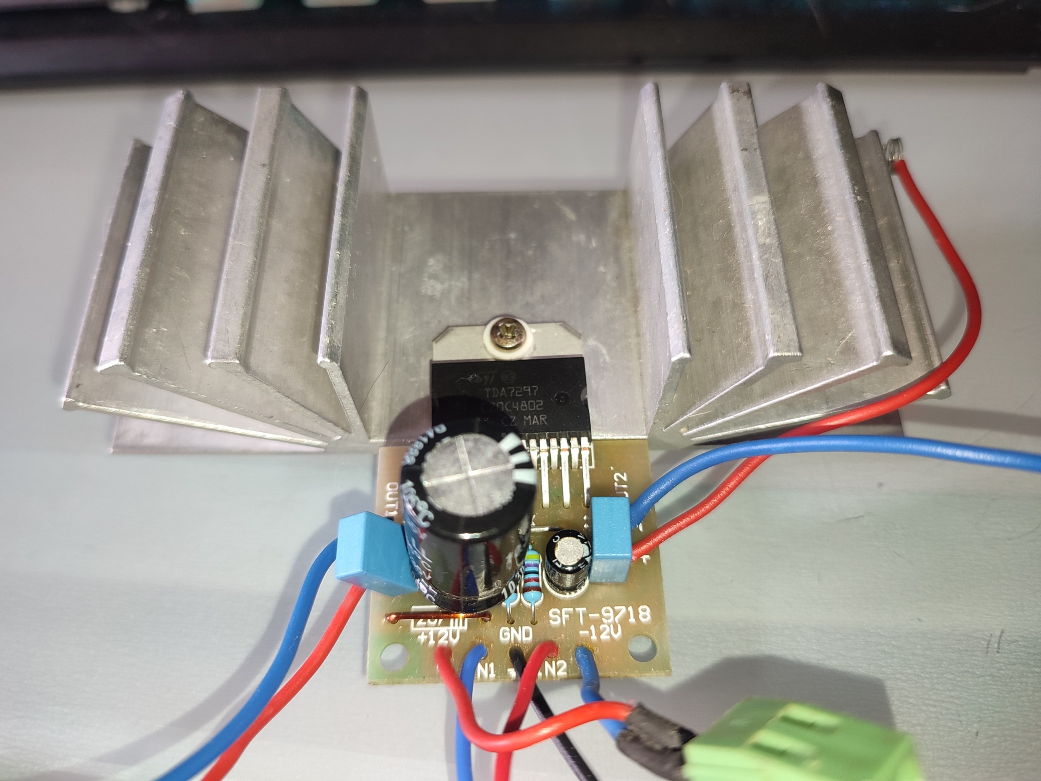

My current 12V PSU adds a weird noise to it, I tried shorting inputs to ground and the noise remained. I actually though this PSU wasn't as bad, because I got the slightly better version of the Lunch money amp, that is this TDA7377 Board. It was just shipped and should take some weeks to arrive.
I am actually thinking about getting a small transformer (12V 5A) and build a PSU for this, but I've never worked with transformers directly yet.

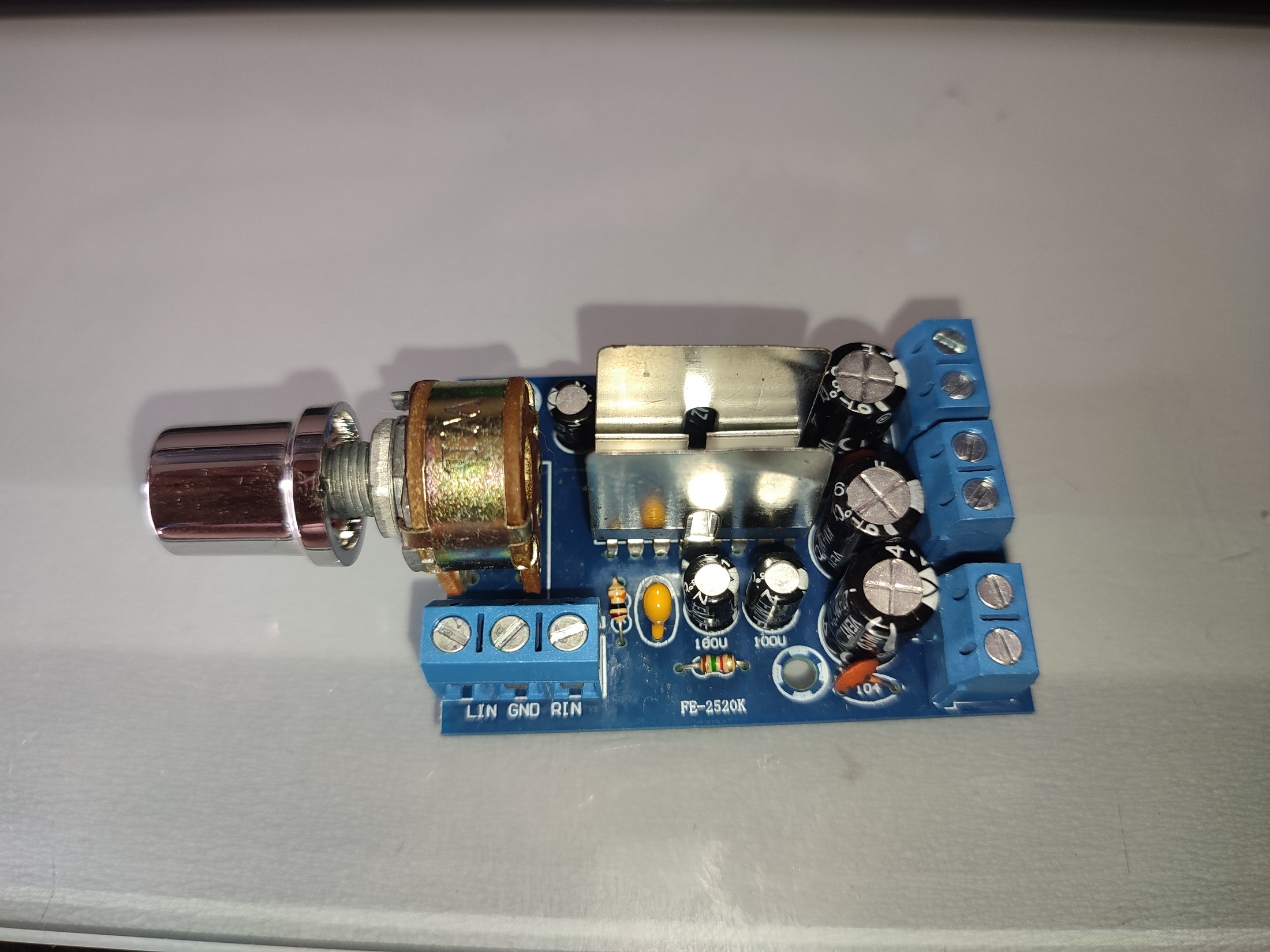

There's also 2 other small amps I tried previously. One of them is a TEA2025, but this one never really powered up, I never really gave it much thought or tested what could be wrong.

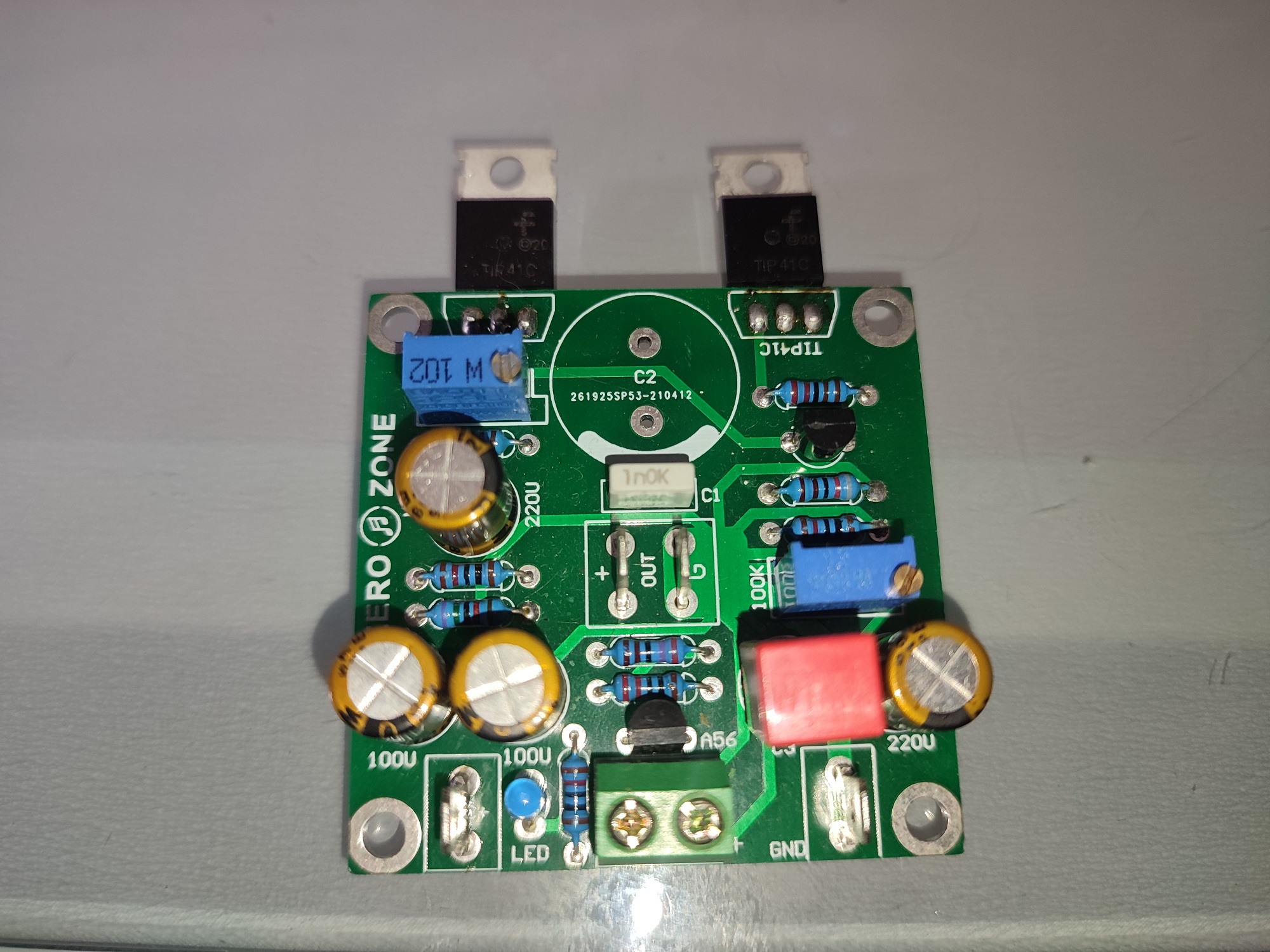

I also got that "Zero Zone" 1969 clone. It worked, but one of the boards would have no bass at all. I tried changing the input caps to higher/better ones to no avail. So I just nicked the 4700uF cap it came with and put into a LM386 amp I built a while ago for fun.

Tda7297 is a nice small amplifier, perfectly capable of 10w into 8ohm. I don't know why you want a new amp:scratch: A 12v 5amp transformer is more than enough, even 3amp is adequate. Use a 10-15amp bridge rectifier, 4700uf capacitor & your power supply is ready to rock.

Reason behind me wanting a new amplifier is, that 7297 was never necessarily good. I tried doing a lot of modifications and attempted using a few PSUs as well, there would always be some hiss or hum in the background I never got rid of.
Since I plan to use that as my desktop amplifier, having it be as silent as possible when idle is a must, the only amplifier I was able to achieve that feat is with my TPA3116 set to 20db gain and a pre-amplifier.
I will follow the idea of trying a transformer, although I really believe that the transformer I found here isn't of good quality (well...it's what I could find for now). I will try implementing one, but as I said, I never worked directly with mains transformers before. I've done some research on the components I will need and found quite a lot of info, ranging from people recommending voltage regulators such as the LM317/338 for an example to properly filter the ouput.
I will just try to use a 15A Bridge Rectifier and a 15.000 uF 25V cap I found in a store (should be more than enough?)

How much power do you need from tda729x? A 30v CT(15-0-15) 2-3amp trnsmr is more than enough for stereo 7293 & couple of good watts into 8ohm!! No need of high capacitance, 2×4700uf 25v electrolytics are adequate for peak instantaneous power & good psu noise level.
I don't know why you're fearing about transformer, currently i'm using locally made EI core( i hate cheap toroids though) with good result. DIY always costs, but yes i understand other points you made.

I received the one I bought yesterday and decided to run some tests on the 7297.
Used a 10A Bridge Rectifier, 2x 3.300uf capacitors, and it worked, really well.
There is still a tiny bit of hum, but it's much harder to notice, you need to put your ears to the speaker. I tried adding some other capacitor values to the DC input, but it didn't help much.
I am getting about 17V after retification, which seems fairly good I suppose, at least, my TDA7297 didn't explode...Actually, it kept cool, a lot better than the SMPS 12V I tried before. It would get a bit warm after a while.
The transformer did get a bit warm, but if I were to guess, it was less than 40C, nothing to be worried about.
