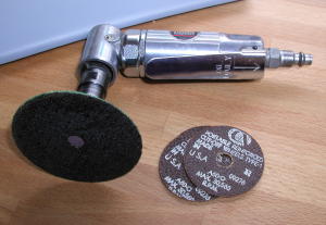

I also work in an aircraft industry and we cut aluminum daily, when installing patches on aircraft skin. We use high speed grinders, which are way stronger than Dremel, but nobody would use a bit to cut 1/8 aluminum. Those are good for small trimming, if the hole is off center. Preferred cutting tool is a cutting disc and with longer cuts it is quite effective. The discs come in small sizes too and you might be able to install them on a Dremel. But I would recommend a jigsaw.

I've always been a bit wary of using disc cutters. I've used some that came with a Dremel accessory kit to cut plastic, foam, and protoboards, and every once in a while a disc would get caught in the material and shatter, shooting pieces all over (I was lucky to be wearing safety glasses during one of these incidences). For cutting the aluminum, I think I'll stick to the saw method. 😛
