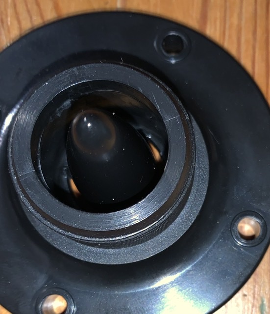

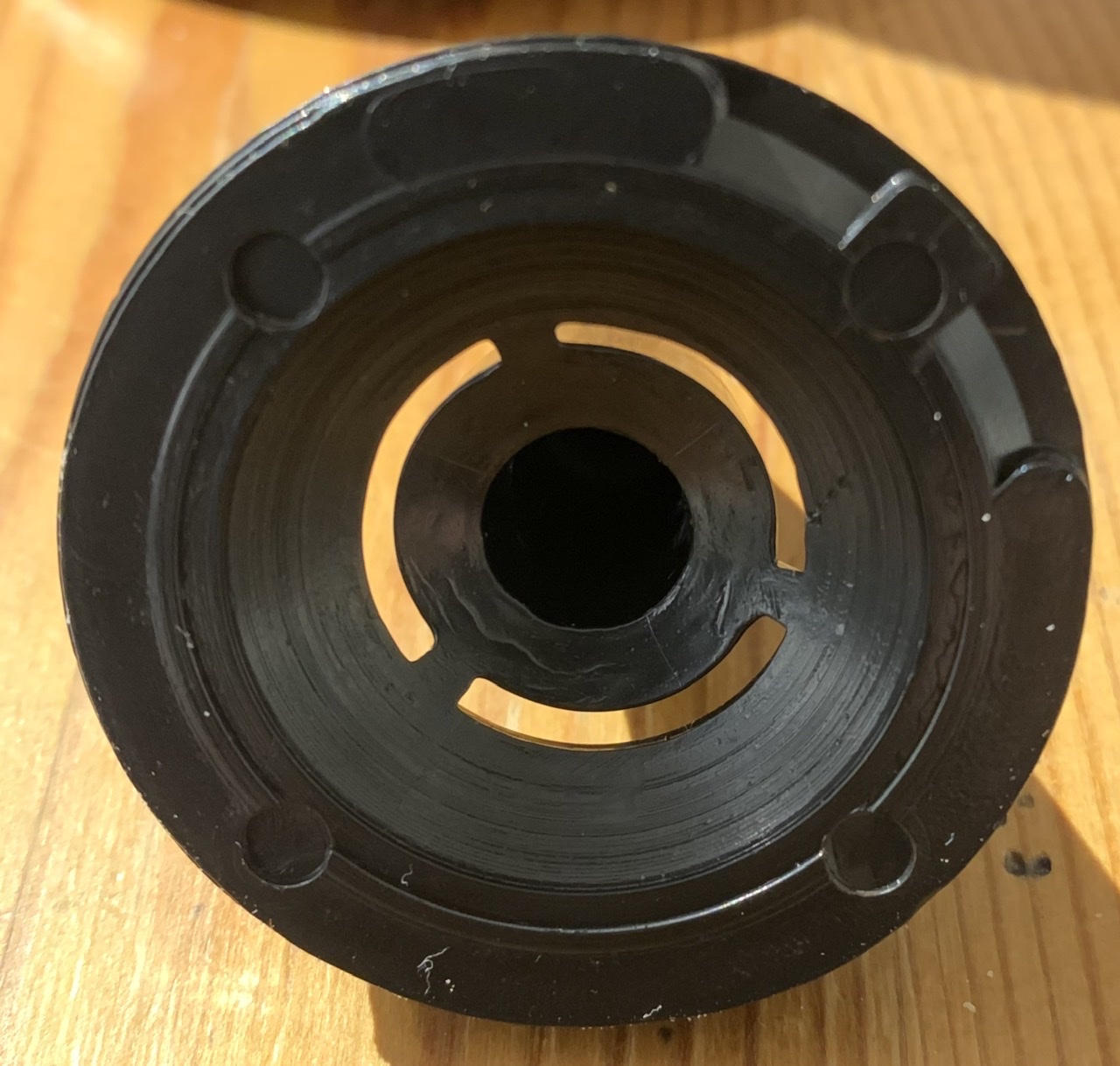

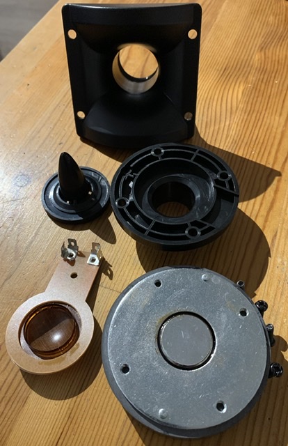

I got some really cheap compression drivers to play with. I can see some flaws in the design and I will try to improve them. Level 1 will be filling the phase plug with hot melt glue and use another horn attachment, since the existing one is plain bad - with a step at the throat and a long section without any expansion.
The air gap is filled with ferrofluid. Is it worth trying to remove it and is that even possible?
Level 2 will be improved 3D printed phase plug and level 3 completely new front - maybe with an integrated horn or K-Tube.

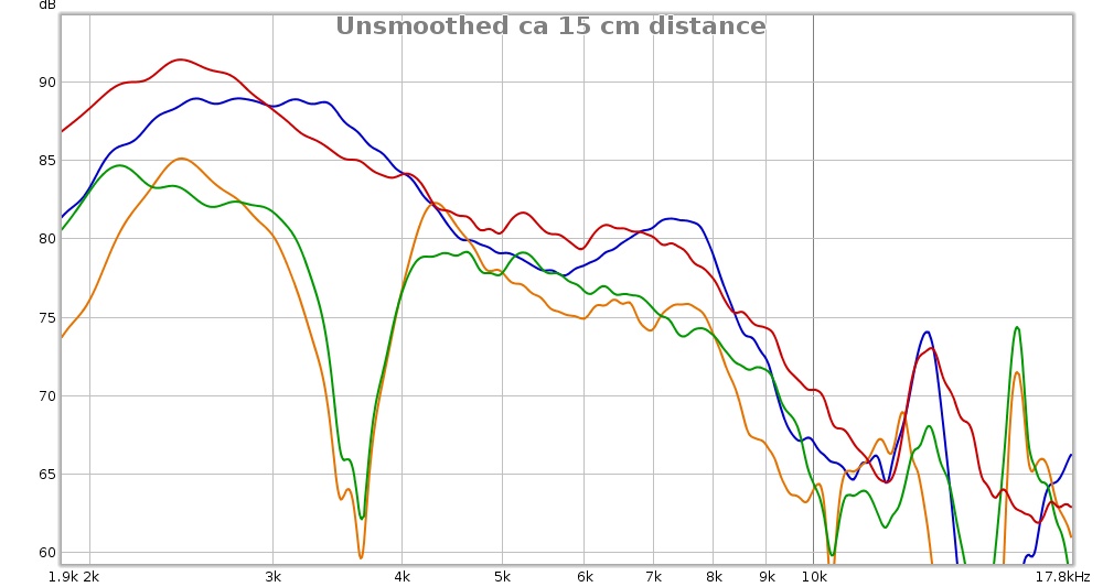

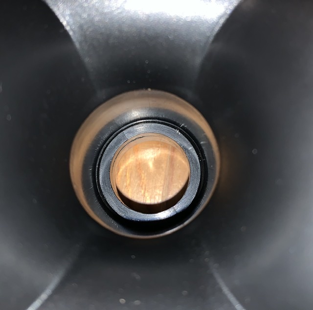

So here are level one results. I do not think it is worth going to level 2 or 3 with these. Yellow is completely stock, green with a wooden horn (which is not perfect, it should be some kind of "Kugelwellenhorn". Blue is with filled phase plug and stock horn and the red is with filled plug and the wooden horn.
So what does this tell me?
1. the hollow phase plug is the worst example of cost cutting and engineering failure
2. a better horn can improve things
3. the tweeters are pretty useless for HiFi, but might work in some cheap stage monitors
I will maybe try to print some beaming horn with narrow dispersion to see if I can get anything useful out of these. Any suggestions?

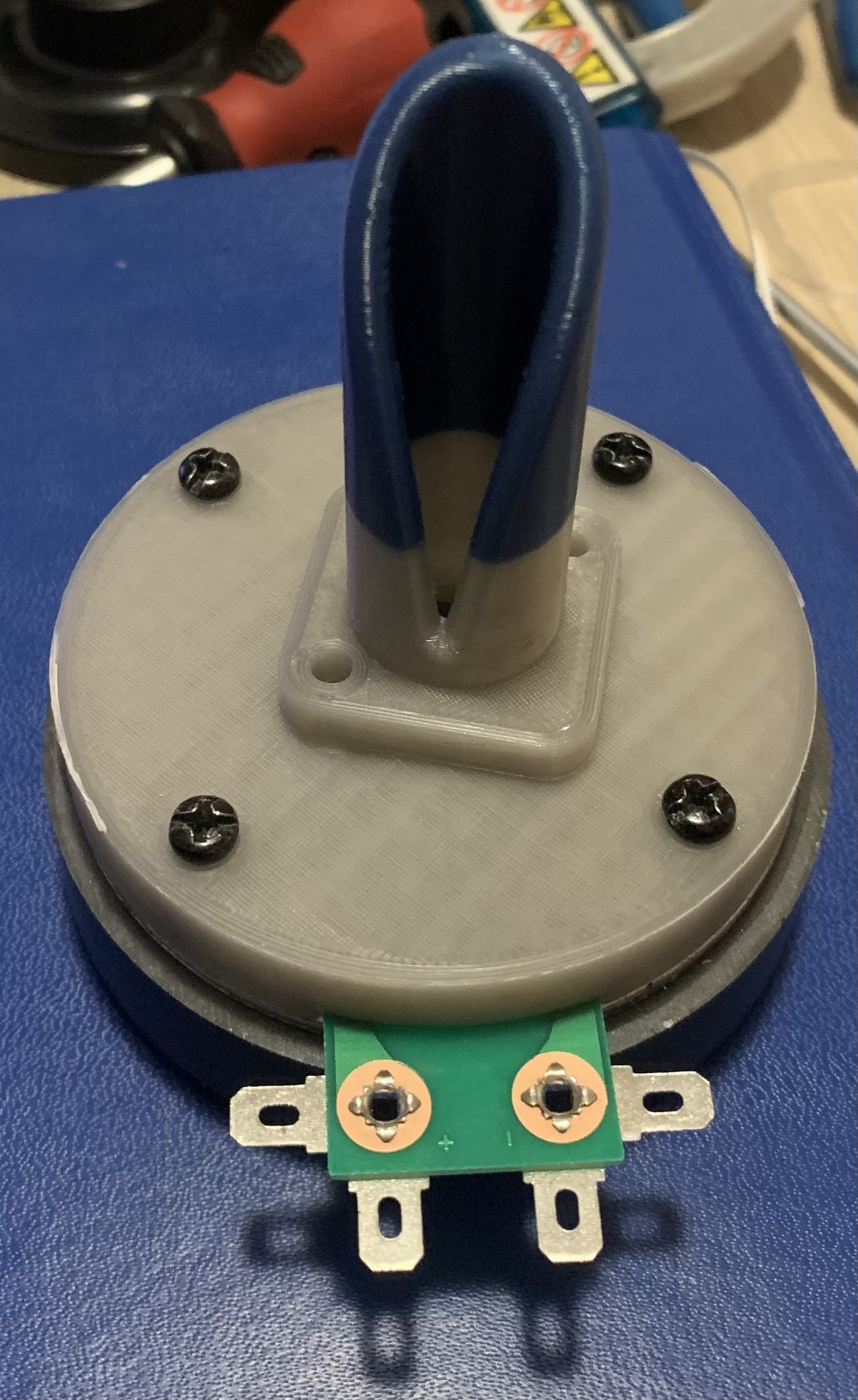

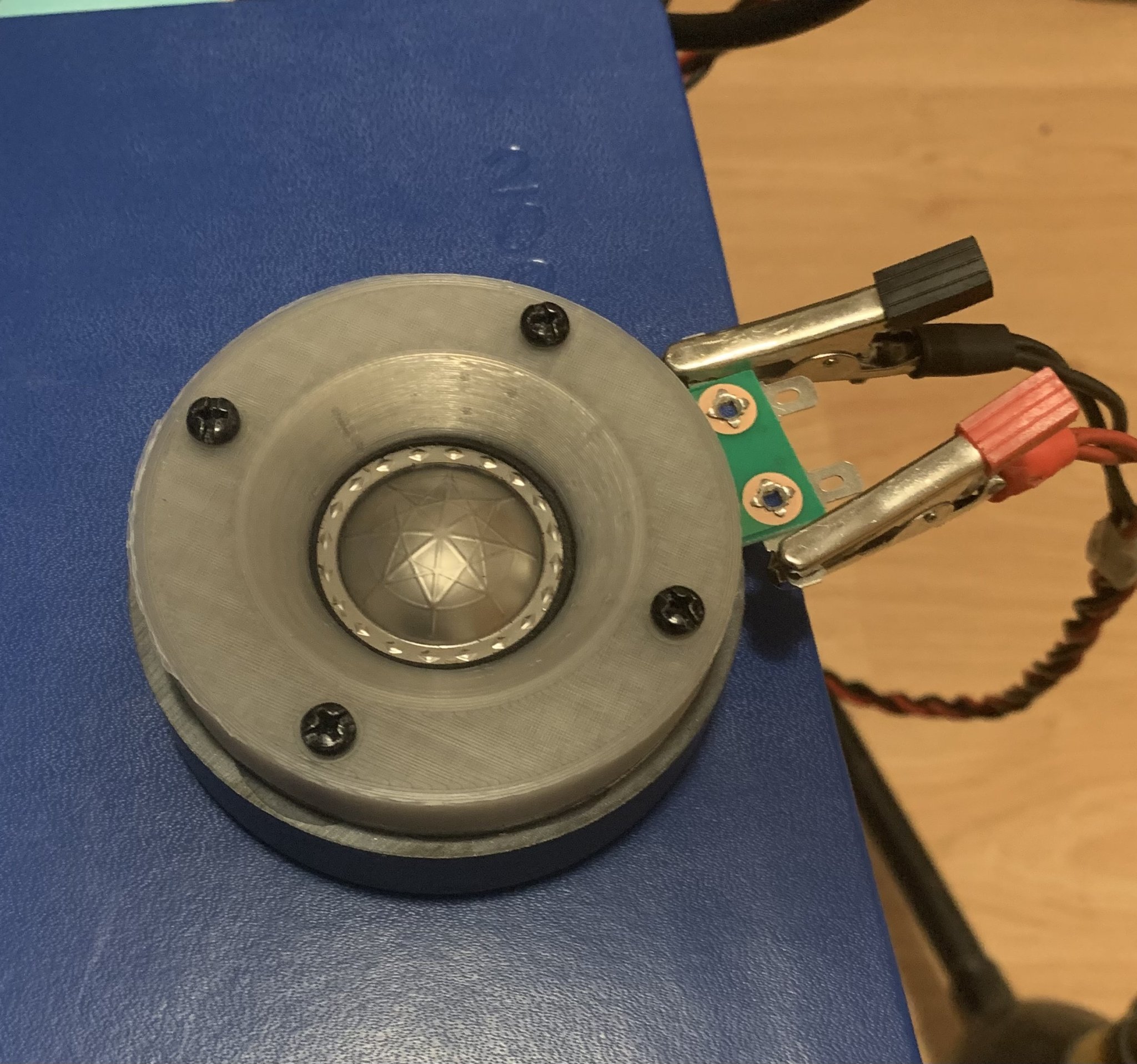

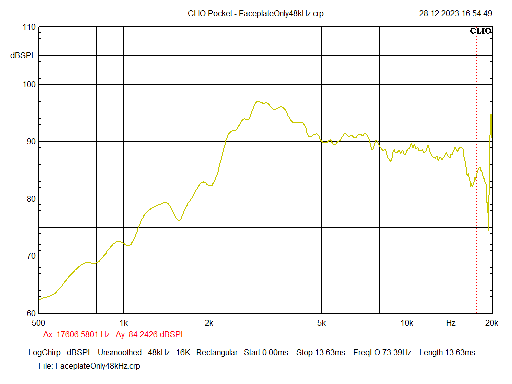

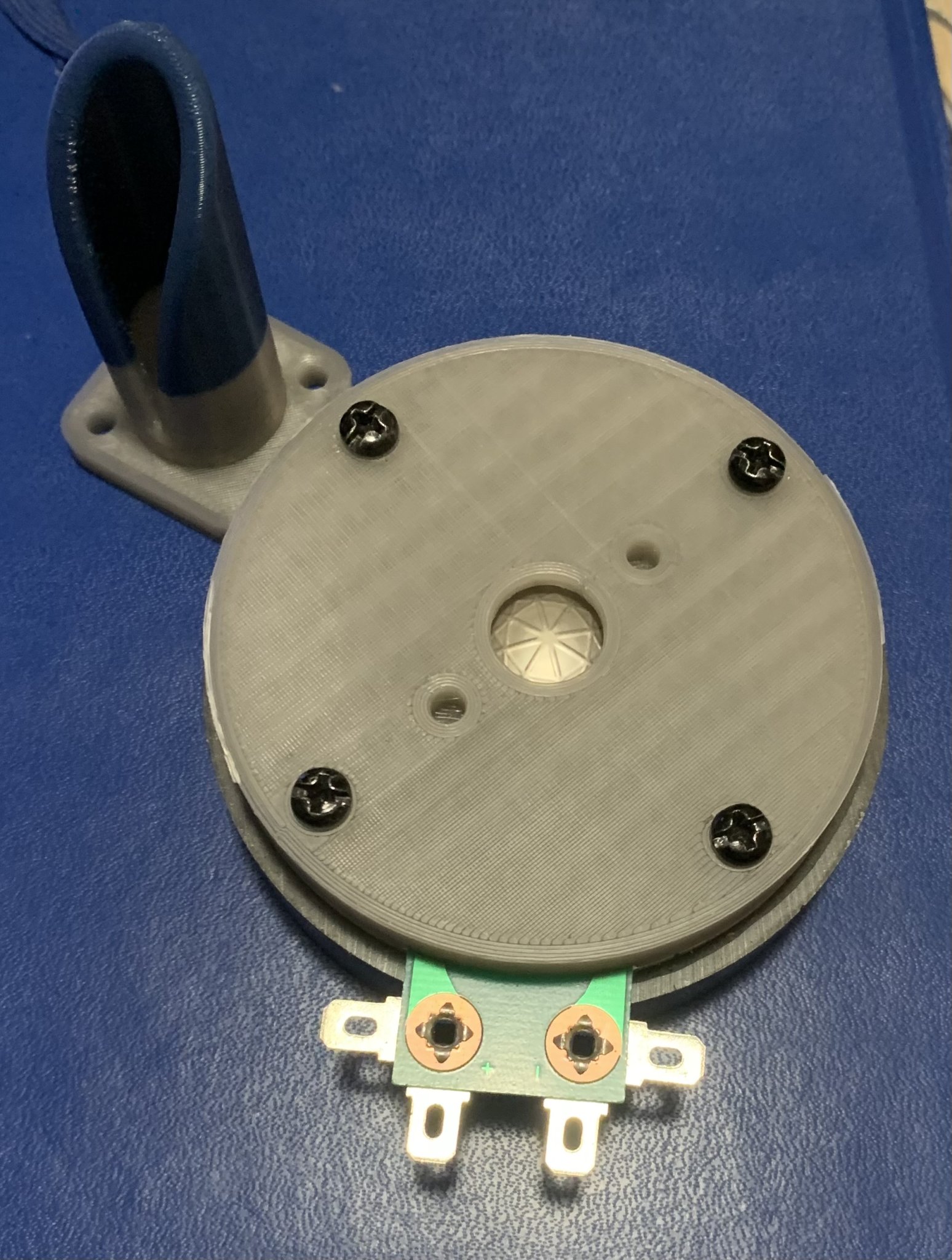

So I measured three different membranes. The biggest surprise was, that the original membrane measured flat up to almost 20 kHz with the front removed. So the next step will be to 3D print a new front plate to accommodate all three types to have a flat front dome tweeter. If that will be successful, a new front plate with horn attachment will follow.
I have discovered the tweeters and wanted to give them the last chance. So I designed and printed new flange to get a dome tweeter.
This is the result. I measured the results and got a pleasant surprise:
Certainly much better. The experiment continues with a 1/2" opening and a small K-Tube. I think I might be able to use these as ambience tweeters.
