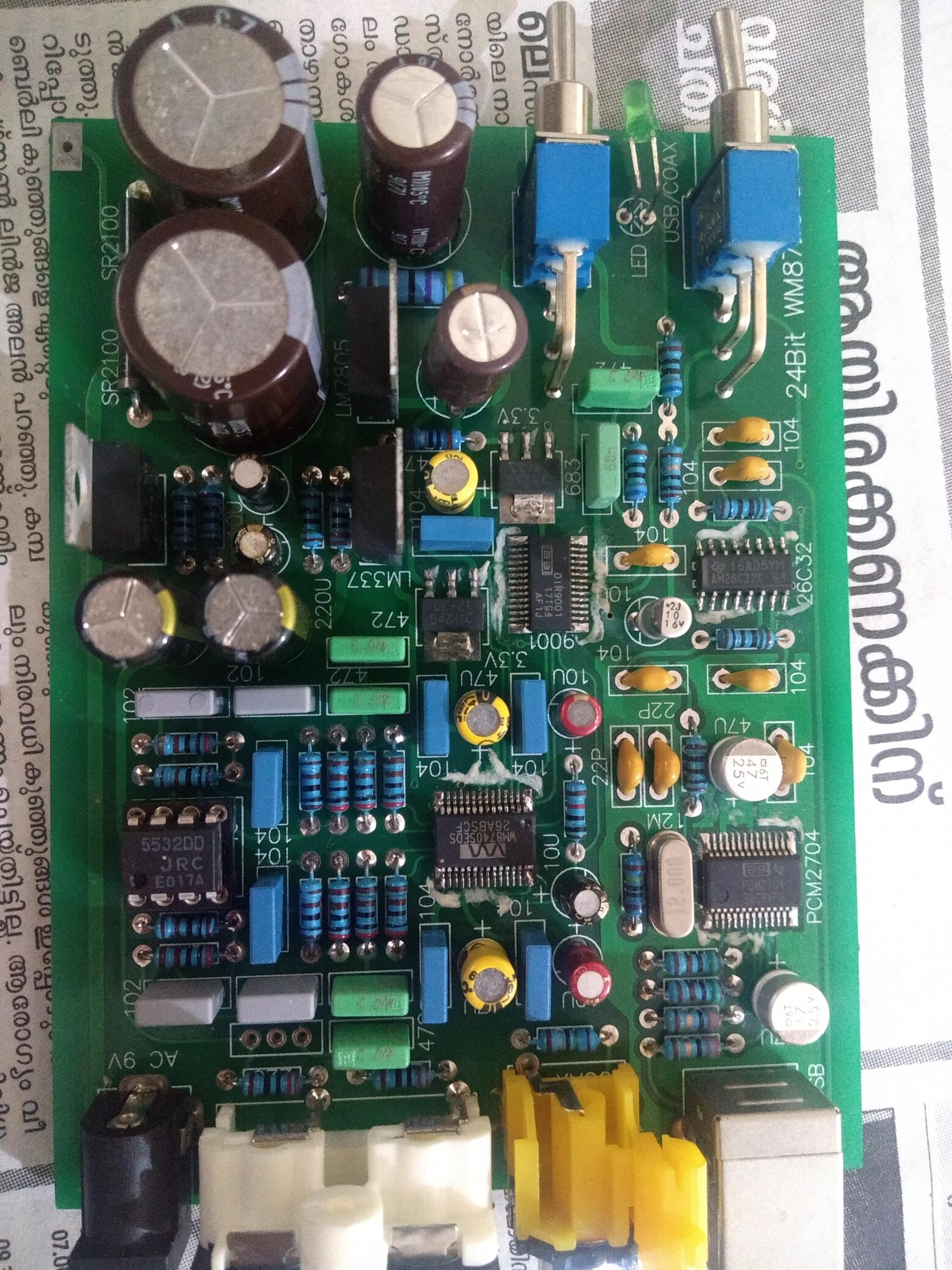

I got the DAC board now !
EDIT:
The seller (aliexpress) says it need AC 9V-12V supply. But my friend who sold it to me says 9V is enough. I have a 0-12V 1.5amp & 0-9V 0.5amp transformers. So, which one to use?
Also, should I twist the cable (phase and neutral) together (Main supply to transformer and transformer to DAC)? One more thing, there is a hole at the pcb which I guess is for connecting ground. So, what should I do with it?
Any help would be greatly appreciated!
EDIT:
I think I used a 9v 1A transformer with the one I had, but it’s been a while.
If you use the 12v that you have, you might want to watch the regulators and make sure they aren’t getting too hot.
You can twist the wires but should be fine without if you make sure that they don’t run close to the board(except where attached of course).
Thanks for the reply !
Unfortunately, only 9V transformer my local electronics shop had was this one (0.5A).
Regarding the 12V transformer, can I use a capacitor in series to reduce the voltage or even a high capacity resister ?
Ok, I'll twist it.
Ok, I'll twist it.
Not a good idea to use a capacitor in series with an inductor like a transformer because you will form a series resonant circuit. Depending on the particulars, you could develop very high voltage across the capacitor and or transformer with dangerous and potentially catastrophic effects, especially when connected to the AC line which can supply a lot of energy. Best to leave things like that to people who really know what they are doing.
You could use a power resistor, but that doesn't mean it would be a good idea. For one thing is means the transformer 'regulation' would likely become rather poor. The Basics of Transformer Voltage Regulation | Electrical Construction & Maintenance (EC&M) Magazine
Really, you should just get a proper transformer and or purchase a small 'variac' to use when you want to adjust line voltage for whatever purpose. A variac can be useful tool to have around anyway for electronics testing and other workbench utility functions. Otherwise, if you know how to calculate the necessary power rating for a resistor you would need, you might well find you don't have one in stock and would need to buy one. And, if you have to buy something then by far the best thing to do would be to buy a proper solution in the form of the right type of transformer or maybe a voltage regulator that can dissipate the power it would need to when fed from a 12v transformer.
Wow ! Thanks for the heads-up ! A variac huh? My college electronics lab had a few but they are costly here. I might move in a short time. So, I'm trying to limit my spending. After I settle, I plan to learn electronics formally so that I can understand at least half the things you people say😛
I'll try to get a 9V, 1 A transformer.
Ok, I connected the existing transformer (9v, 0.5 amp) to the dac and the usb out from the pc but the sound output is very low. I had to turn the volume to the max to hear anything at all.
I measured the output voltage of the transformer while the dac was working and it was 8.3v (required voltage is 9-12v as per the seller at AliExpress)
By the way, the RCA cable I used is very cheap though (of my old DVD player, very old )
Shall I connect the 12v transformer instead of the 9v ?
It was due to the old RCA cable. Re-arranging the cable solved it. Sound is decent but the bass is less defined compared to the Xonar DX soundcard. Treble is better than the Xonar DX. Mids are....almost the same or slightly lower defined. Playing the Colour to the Moon by Alan Taylor. Let me play Return to Innocence by Enigma next to check out the female vocals!
"Return to innocence" wasn't bad at all. But, I can definitely sense some issues with bass. May be it's the cable or even the low 8.3V supply.
Let me get an "audiophile" RCA cable and a shorter usb cable and test again.

The 12v transformer should be fine.
Ok, I'll try it.
Even with the 9v input, one of the voltage regulator gets warm. Shall I put a better heatsink on it ?
I have some LED heatsinks from a hobby project lying around somewhere.
If you can hold your little finger on it without pain, it should be alright. A better heatsink could help if it’s getting too warm, and really couldn’t hurt anyways.
I’m pretty sure that device was intended to be in a small non-vented enclosure and if you have it in something larger it should be fine.

Yeah, it's not too hot to touch. It's just warm like the warmth of a hot coffee.
I just measured the output voltage of the 12v transformer and it's 12.45 volt.
A bit higher than I wanted.
I'll report after I connect it with the dac
Can't wait to get home (at my workplace now) and try the 12V transformer.
By the way, I have a LME 49720 opamp. So, can I swap the JRC 5532DD opamp in the DAC pcb ? Would it be safe ?
I'm asking this coz I heard that the LME opamps are very picky about the rest of the circuit and can potentially damage my AMP if something goes terribly wrong.
